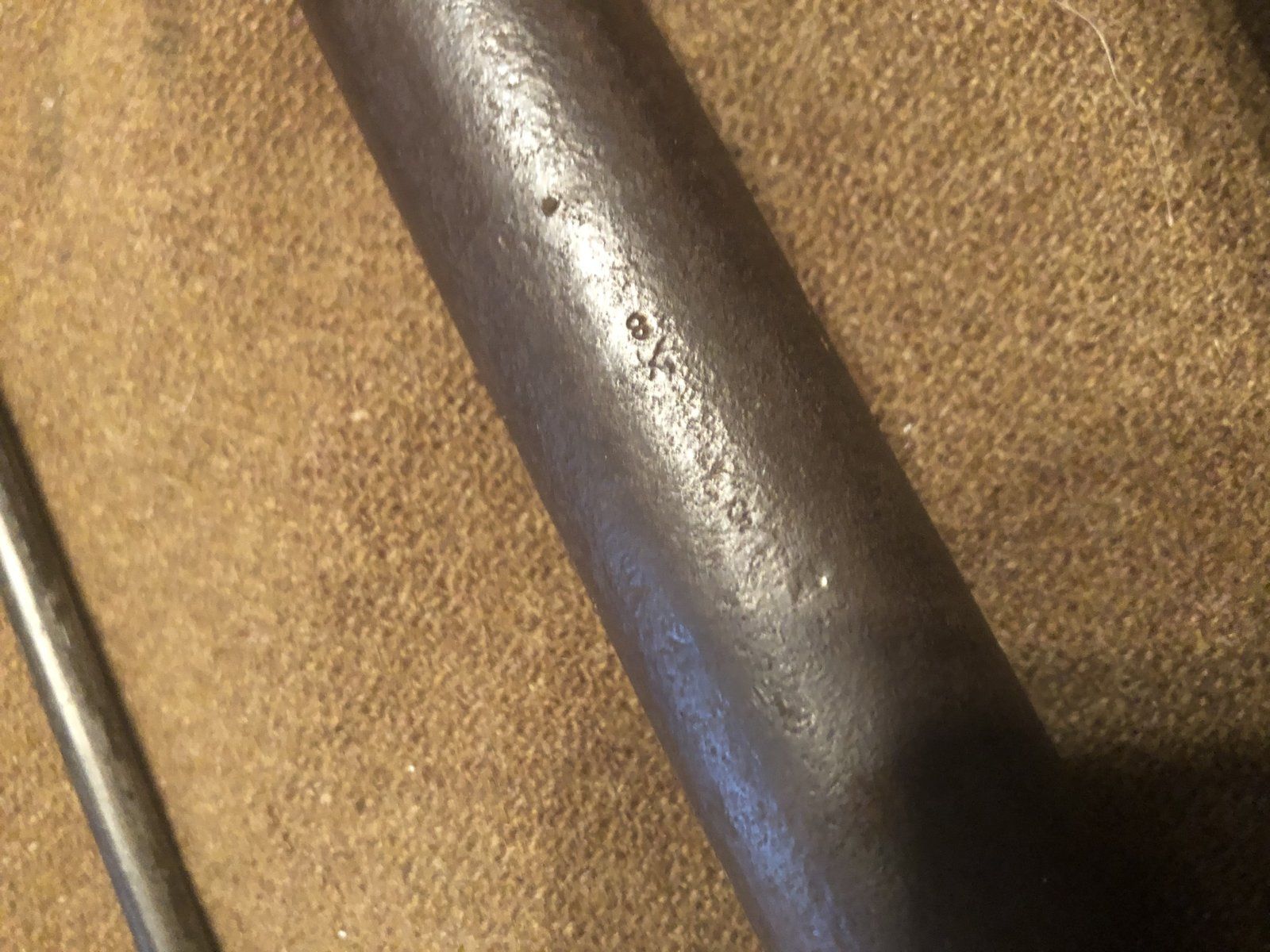

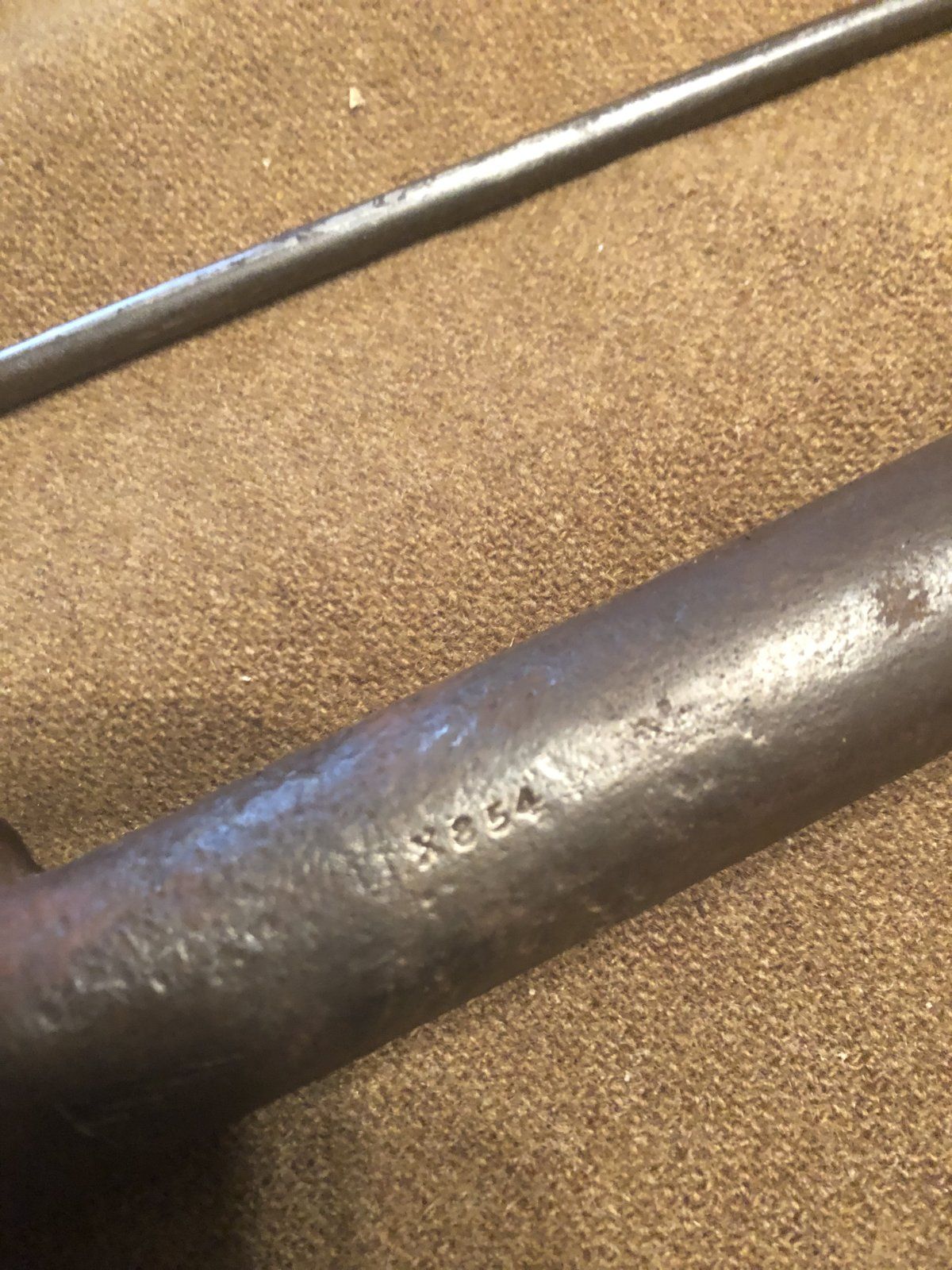

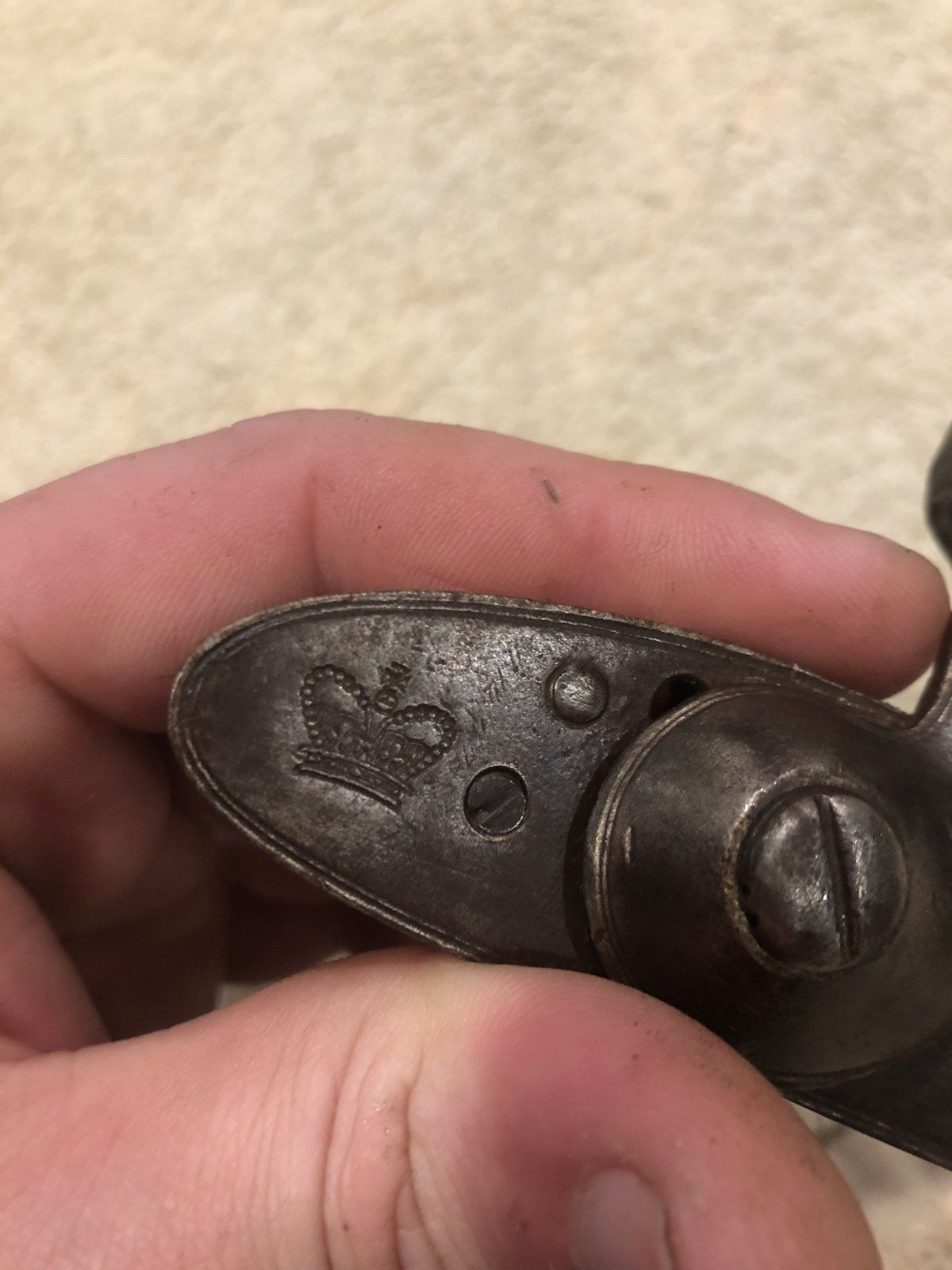

1861 endfeild I picked up the other day .English trade rifle ?
band is missing in middle and bottom one is wrong. Cook and son on bottom of stock and underneath the ram rod cook and son stamp on stock as well ,anybody know if they can confirm this as confederate? Maybe something near the bolts too can't make it out , and also maybe something on the top of butt stock to worn to tell Thanks!!
From what I can see someone took some disassociated parts and put together a rifle musket. That lock doesn't look correct to that stock as the escutcheons are post 62/63 and to me and there looks to be a couple other things of... but I'm using my phone so pics are very small.
The good news is I see parts that bubba didn't play with. An arm that could easily be completed and turned into a shooter with a good rifled barrel and sights and a couple barrel bands. I'd send pics of it to Lodgewood and ask Dave for an estimate to restore it to shooting condition. If you aren't interested in shooting it I see only a $200 investment in parts but to shoot it you'd likely also need to add a barrel.

Thank you ! I'm just going to display it !! The ram rod on it is mushroomed from being used so much and a lot of pitting on the barrel near the hammer on barrel this rifle was very heavily used . And has a story we will never know , the bottom band looks very aged as well could have been a period modification .
