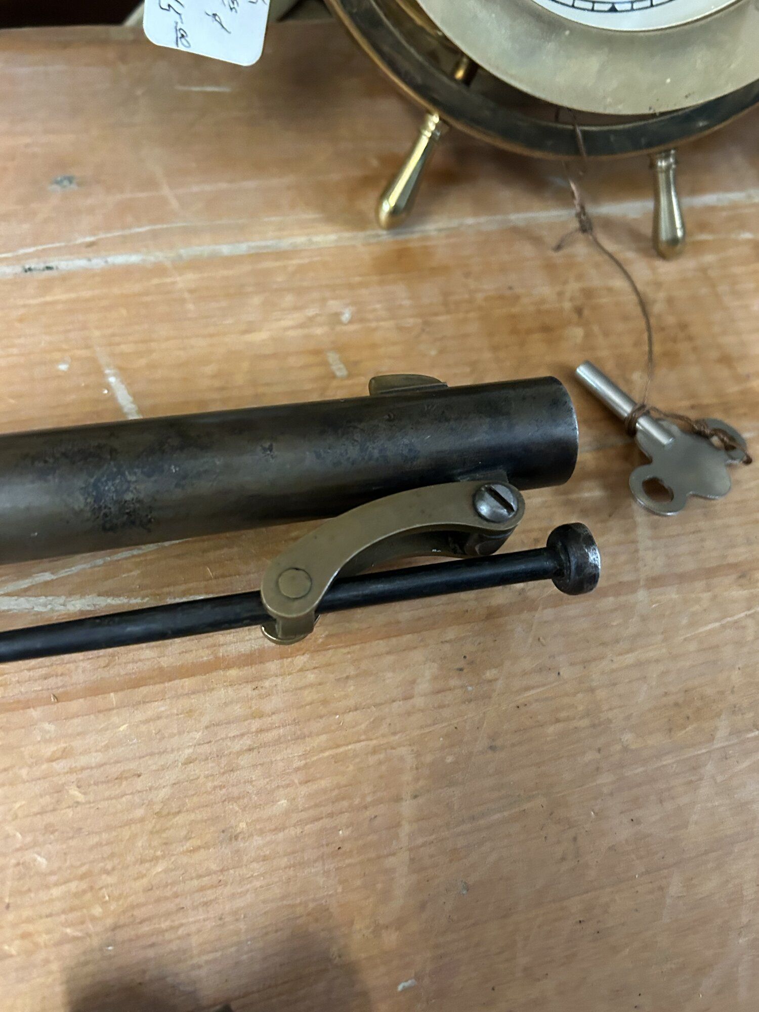

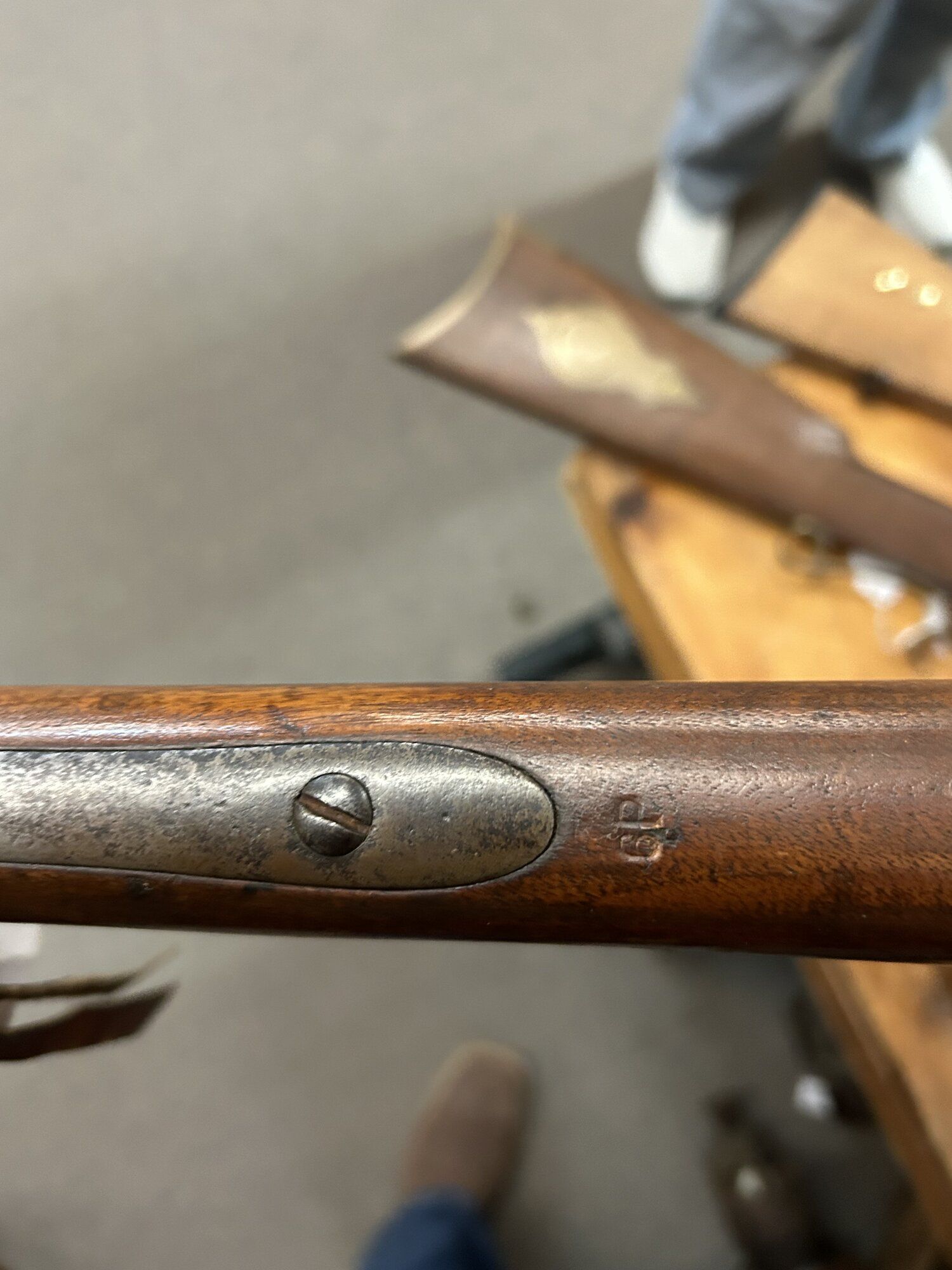

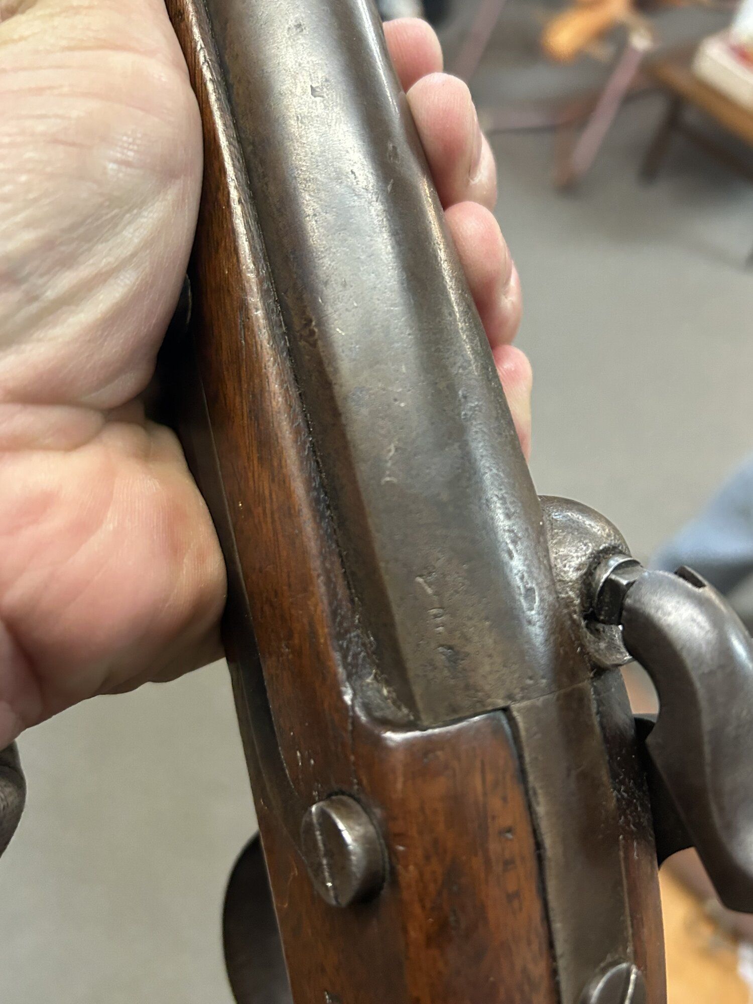

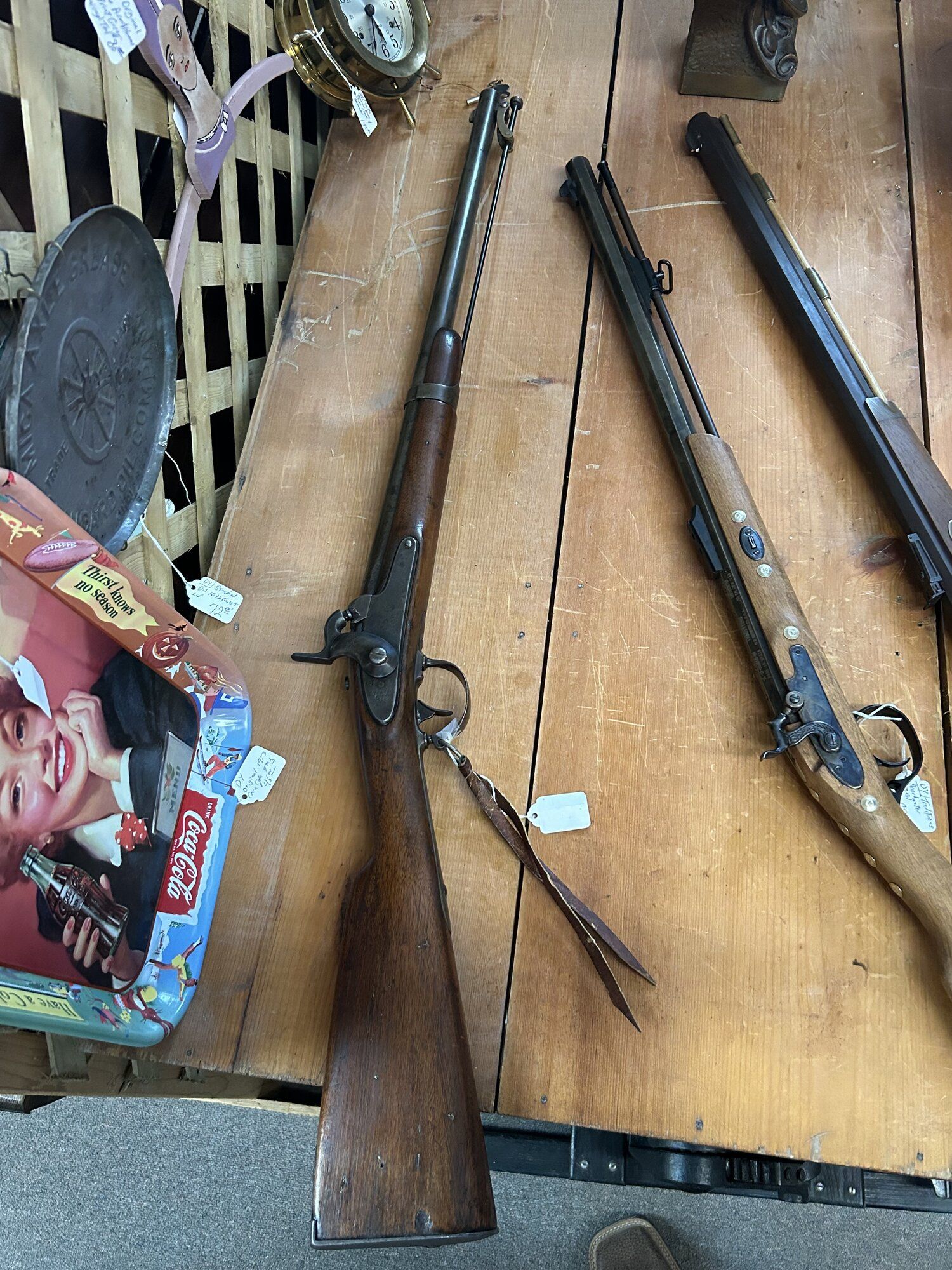

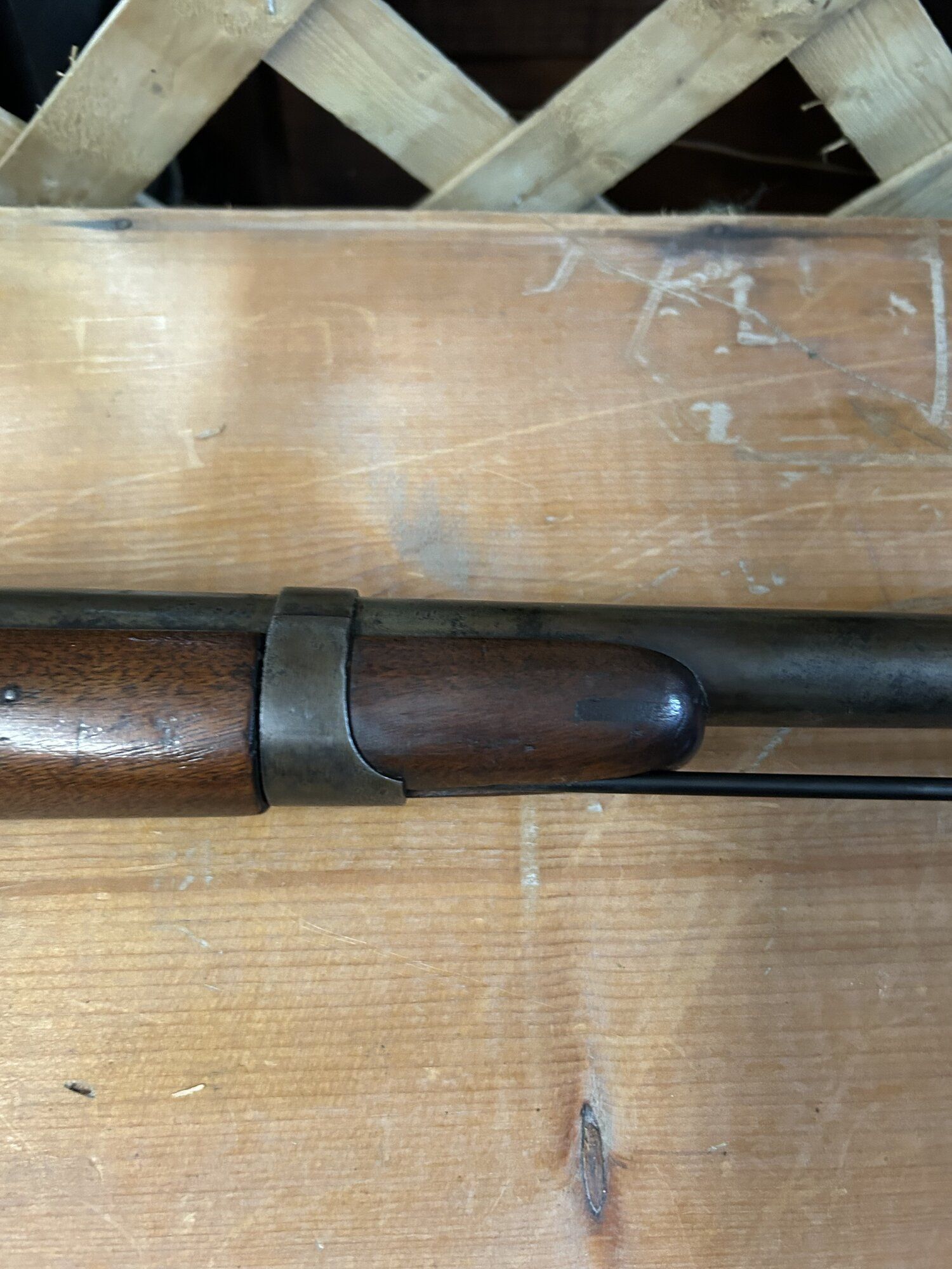

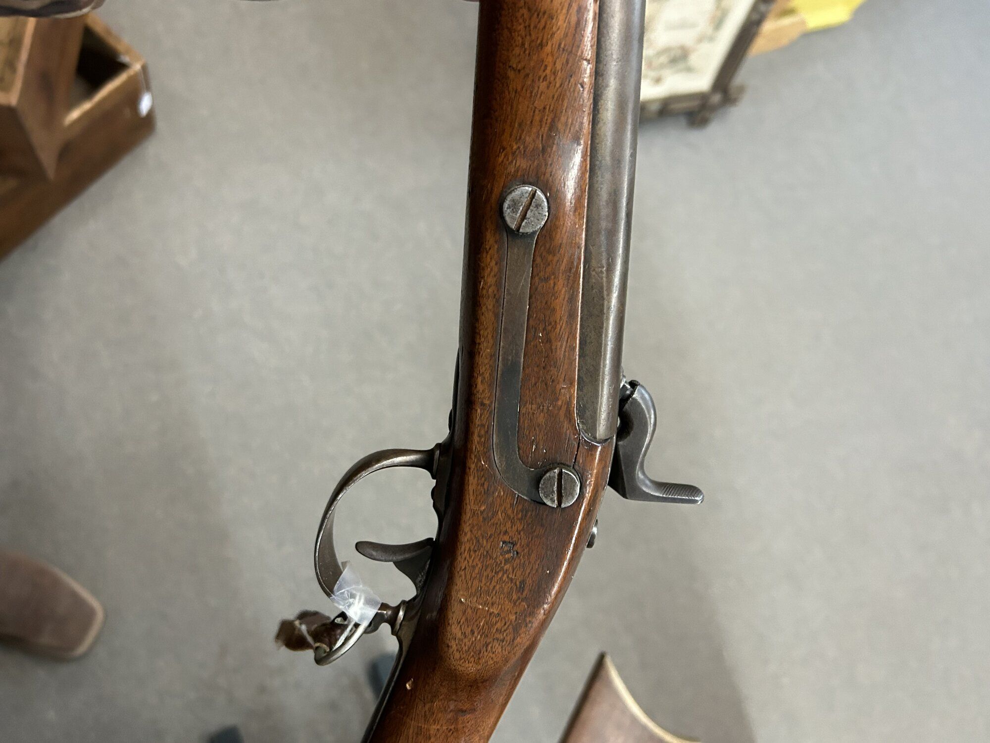

Found this today and wanted to get opinions? Is it a legit weapon or a Frankenstein?!
That's neat looking. It looks like someone tried to mimic an 1873 cavalry carbine. Is it rifled? The fact that it's missing a rear sight leads me to believe that it's an altered piece. I'd still love to have it
I'll be honest but I cant remember if the barrel was rifled, I don't believe so. It apparently has been modified but by who and when?!
I wanted to find more out about it before a possible purchase? It was all very well altered at least it appears that way! Someone had some knowledge when they did this!
It's a franken gun. The lock date is too early for any of the M1847 carbines (cavalry, artillery, and sapper). The M1847s locks are also smaller than M1842 musket locks. If it was a M1847 cavalry carbine it would also have brass furniture.
This gun may be an attempt to make a M1855 Carbine on the cheap, but if that was the intent it was poorly executed.
