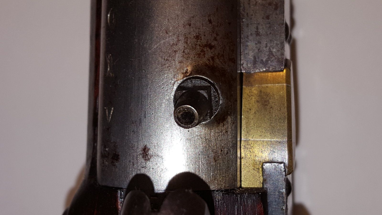

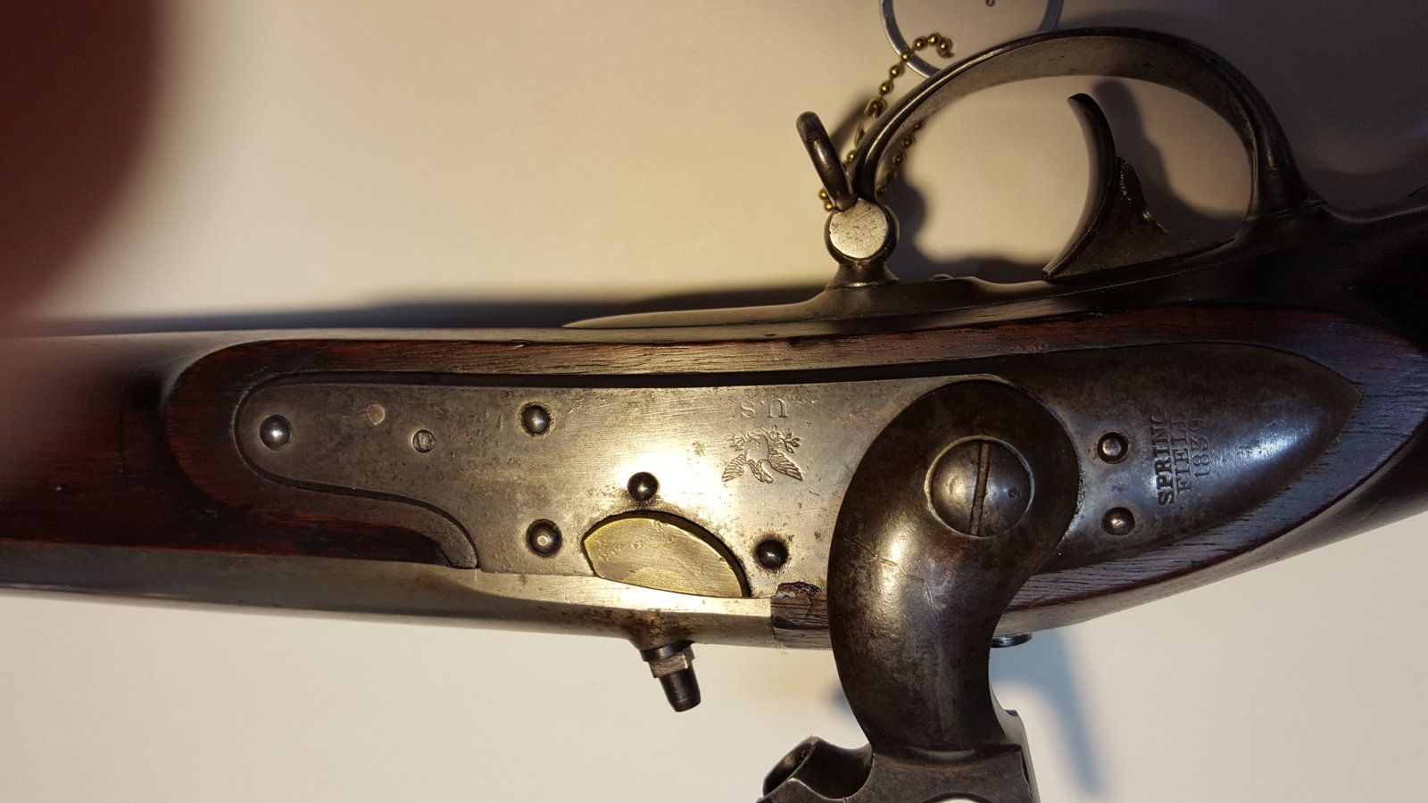

I was taking some photos for you during your reply... What follows is a look at an 1839 dated Springfield which was altered to percussion, using a type of the cone-in-barrel system, preferred by Federal armories. The Confederate types are down and out funky !! View attachment 173905 View attachment 173909
