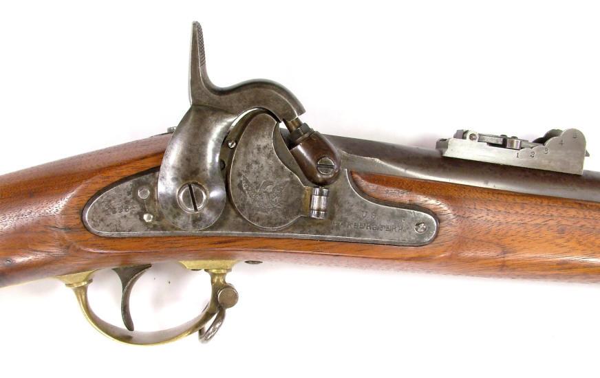

Weapons not being my strong point, I will pose this to the experts:
"On the rifle there is a capsule between the hammer and the butt, which is a container for a band of caps rolled up in a spiral, which at each cocking pass through an opening under the hammer to strike when fired."
They are describing the Maynard Tape primer. It could reference any of a variety of arms though most likely is the M1855 series of arms or the Remington Maynard Conversion of the M1816.

Johan's was an excellent photo of the outside of the lock on these arms; here's another photo showing the interior mechanism on my Remington conversion rifled-musket. The roll of caps fit into the cavity and were fed by the spring-loaded "hand" onto the nipple where they were then detonated by the hammer when it fell. These guns could also be fired in the "conventional" way using the more readily-available percussion caps in the same way as other rifles and muskets.
