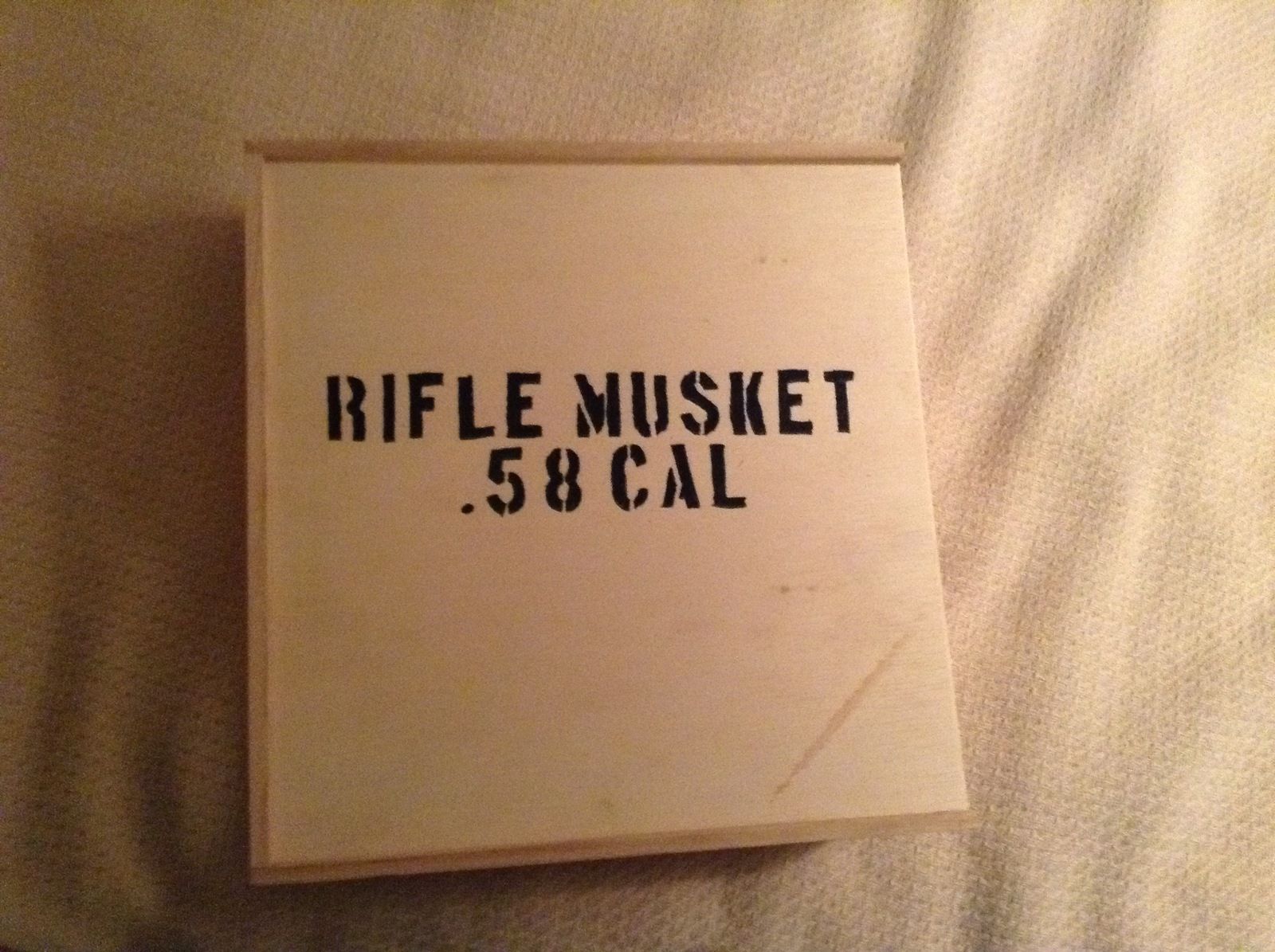

Made this to hold cartridges but was this the right thing to have written on the lid?

I think the poster is looking to build a wooden ammo crate? If so and you are not that handy with woodworking tools, just use the dimensions, stencils and forget the dovetailing. Make sure you use slotted wood screws, the Phillip's head wasn't around in 1861. You also need to paint the crate and I believe the article gives you the arsenal color and best modern match.
www.2ncmi.org/AmmoBoxArticle.pdf
Stenciling should be with the name of the Arsenal on both ends and inside the lid. 1" pine boards, and as was posted earlier slotted screws. That said, this effort is far from the worst ammo crate I have seen at an event. Just for show or do you plan on filling it with arsenal packs?
I'm unfamiliar with any arsenal that dovetailed any ammo crates. Just curious if you know of one?
Craig, one US arsenal didn't mark the outside of their crates with their name just on the inside of the lid. I think it might have been Watervliet but I'm just guessing. You wouldn't have any idea?

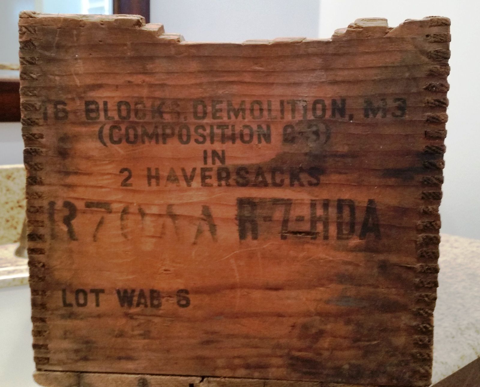

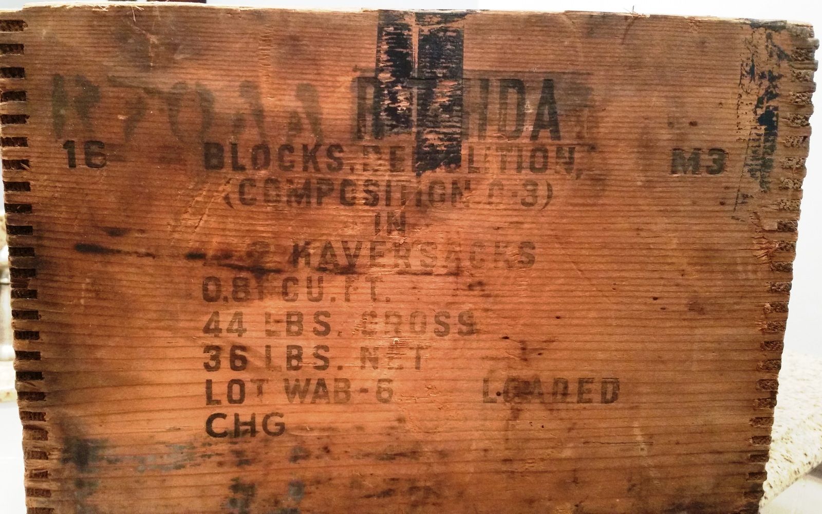

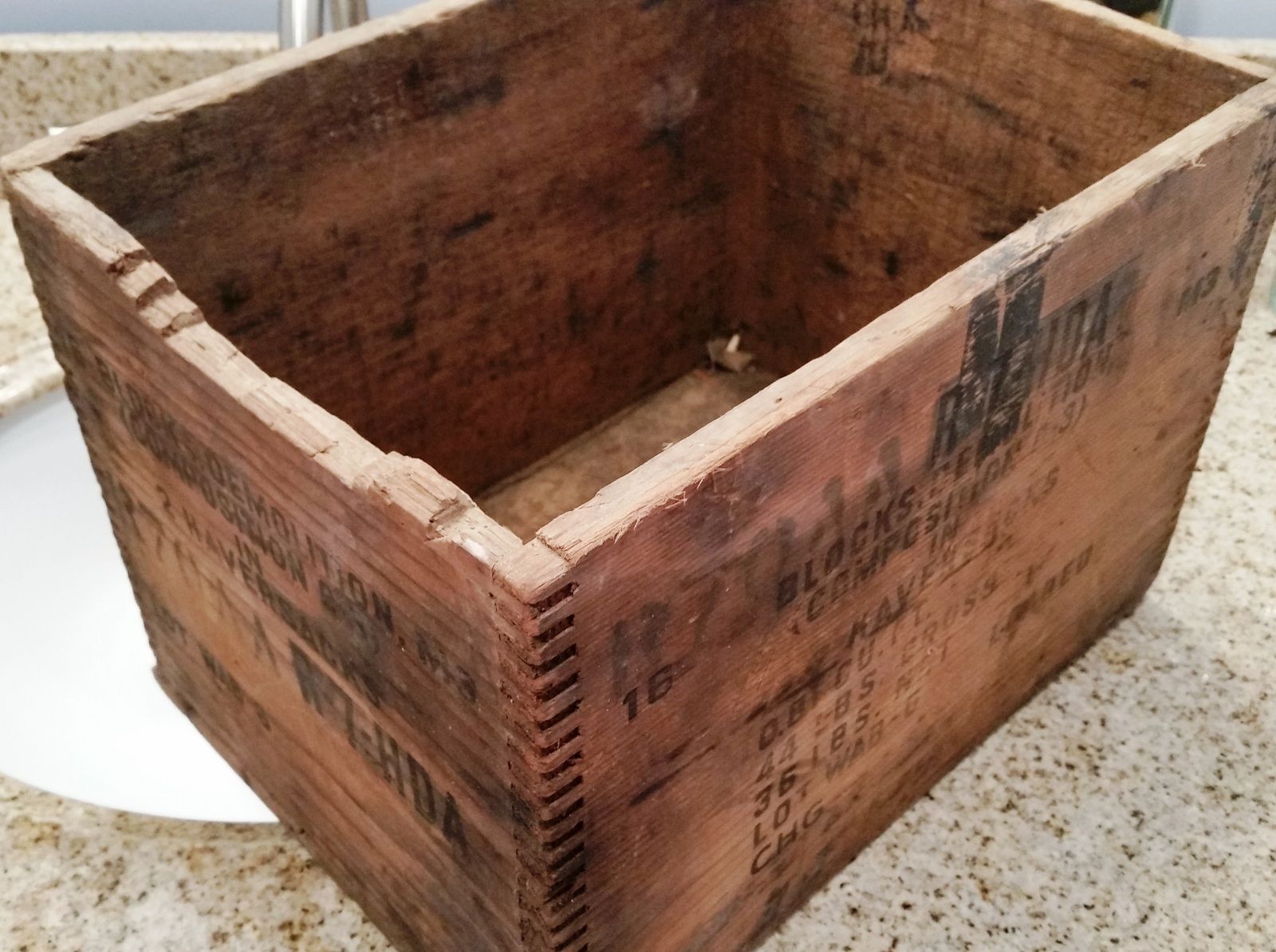

Ive got this one with dovetailed corners from the Wabash River Ordnance Works, but its from a different era. :bounce: Still - pretty cool I think.
WWII M3 Block Crate measures 13"x10"x10"
Imprint reads:
"16 blocks Demolition M3
COMPOSITION B-3
IN HAVERSACKS R-7-OAA
LOT WAB-6 (Wabash River Ordnance Works)
LOADED
CHG"

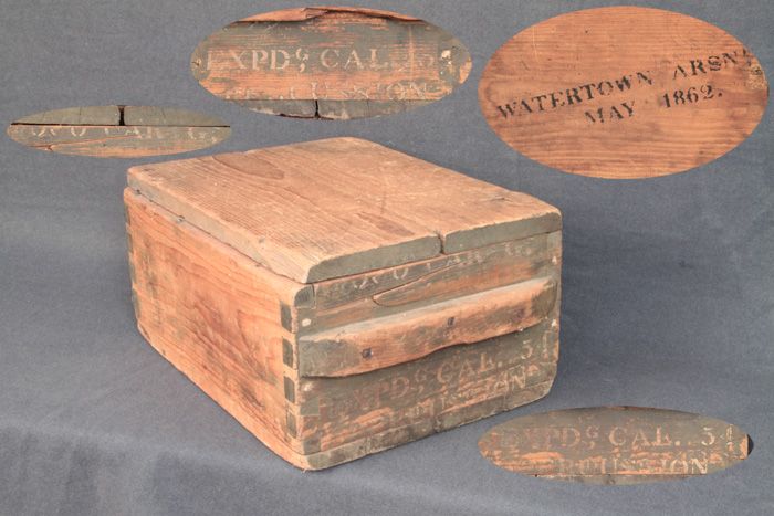

On the southern side, Richmond, Palmetto and Fayettville crates were dovetailed construction. Most artillery ordinance seemed to be shipped in dovetailed crates as well, most likely due to structural integrity.
Depending on which arsenal and when... there is a variety of construction methods known. Many of the early war ammunition boxes were typically noted to have Dovetail, Box/Finger, or Rabbet/Lap Joints at the corners... Which type were used when, if any.... and for how long depended on the Arsenal in question... Mid war and onward it was more common to find a simple butt joint being used by many if not by most... cheaper and quicker to make.. Abet each arsenal usually had their own characteristic habits.....
Many will biblically adhere to what the Ord Regs may indicate.. however what was actually produced and issued in the field frequently was found to be something slightly different... Construction patterns and assembly methods... sizes... box painted colors, and markings... floated and evolved over the course of the war for many... I make all of mine based on original issued ones...
No problem, as a note, Fayetteville, Palmetto and Richmond also had their crates dovetailed, on the Southern side of things.
Most Artillery crates that I have viewed are also dovetailed, most likely due to the weight and structural integrity required to bear the load. The St Louis Arsenal also started to dovetail, I remember seeing a friction primer crate with dove tailing.
The crates that were salvaged from the USS Cairo were also dovetailed, though they were submerged so long that the stenciling was obscured and the arsenal is unknown.
