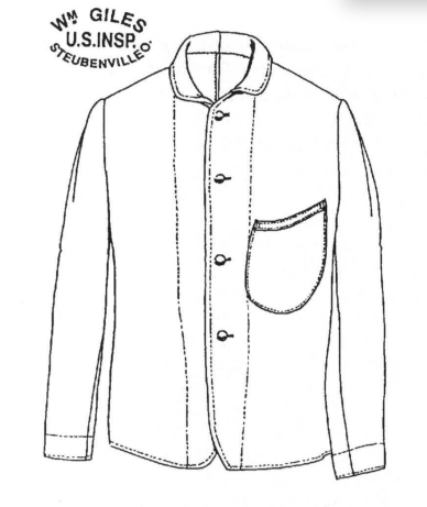

Here's the variant contract shirt, it's more of a civilian looking pattern and the material is a grey flannel. A buddy of mine has one and it's a way softer and more comfortable fabric. Not sure what they call it, I looked and W&W doesn't have that fabric listed for sale, maybe an email to them and ask exactly what that fabric is. https://wwandcompany.com/contract-variant-federal-issue-shirt/

Is the patterns of shirts that were produced by Schuylkill Arsenal/ the Government, then they were required to be of all hand sewn construction. The contractor made issue shirts were more commonly machine sewn.
