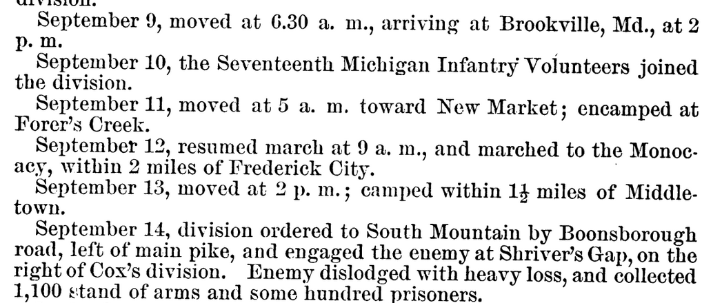

Fortunately I've found the itinerary for Willcox' division of 9th Corps, OR S1 V19 P1 pg 431-2:
So they got moving at 2PM on the 13th (before most estimates of the Lost Order being in McClellan's hands, AIUI, if we dismiss Sears as his main evidence doesn't say what he claims) and camped near Middletown.
Sturgis' report says that he got moving 1PM on the 14th from a camp near Middletown to support Willcox, which means he was behind Willcox in the column.

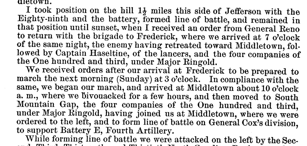

Fairchild's report (1st bde, Rodman's div - couldn't find Rodman's report) says:
So they moved from near Jefferson to Frederick (6PM to 7PM), and presumably camped there until 3AM when they set off to Middletown (arr. 10AM) then moved to South Mountain.
