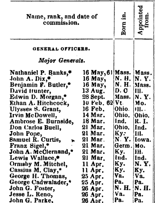

Reno had received an appointment to be a Major-General of Volunteers from Lincoln just before the Maryland Campaign, with a date of rank set to be the 26th April 1862. This was the authority he had during the Maryland campaign.
If so, then you no doubt can post a copy of the order saying this about Reno. I have asked for this previously, but I have not noticed you posted an image, a reference that can be verified, or a link to the order. All you have to do to establish your position is to do so.
Reno had also been appointed to the "rank" of Corps Commander by Lincoln, which gave a raft of special privileges. In effect, the law had created a higher grade of MG, to which Reno was assigned.
Please post a reference, a link, or an image of this appointment so that we can verify what you are referring to here.

Now, all this is very simple. Documents are produced by the War Department when an officer is promoted. There were actually fill-in-the-blank forms for this purpose in the War Department. If you are right, all you need to do is to produce one from the War Department notifying Reno that he was being appointed to the rank of Major-General with the earlier date-of-rank you are claiming. Please do so.
It may well be that Reno was recommended for promotion with that date in mind. This might explain why that date was used in the link you gave to the registry. It does not appear that he was actually promoted by the War Department with that date-of-rank. If he was, there would be a document promoting him and a later, second document correcting to the actual date-of-rank.
