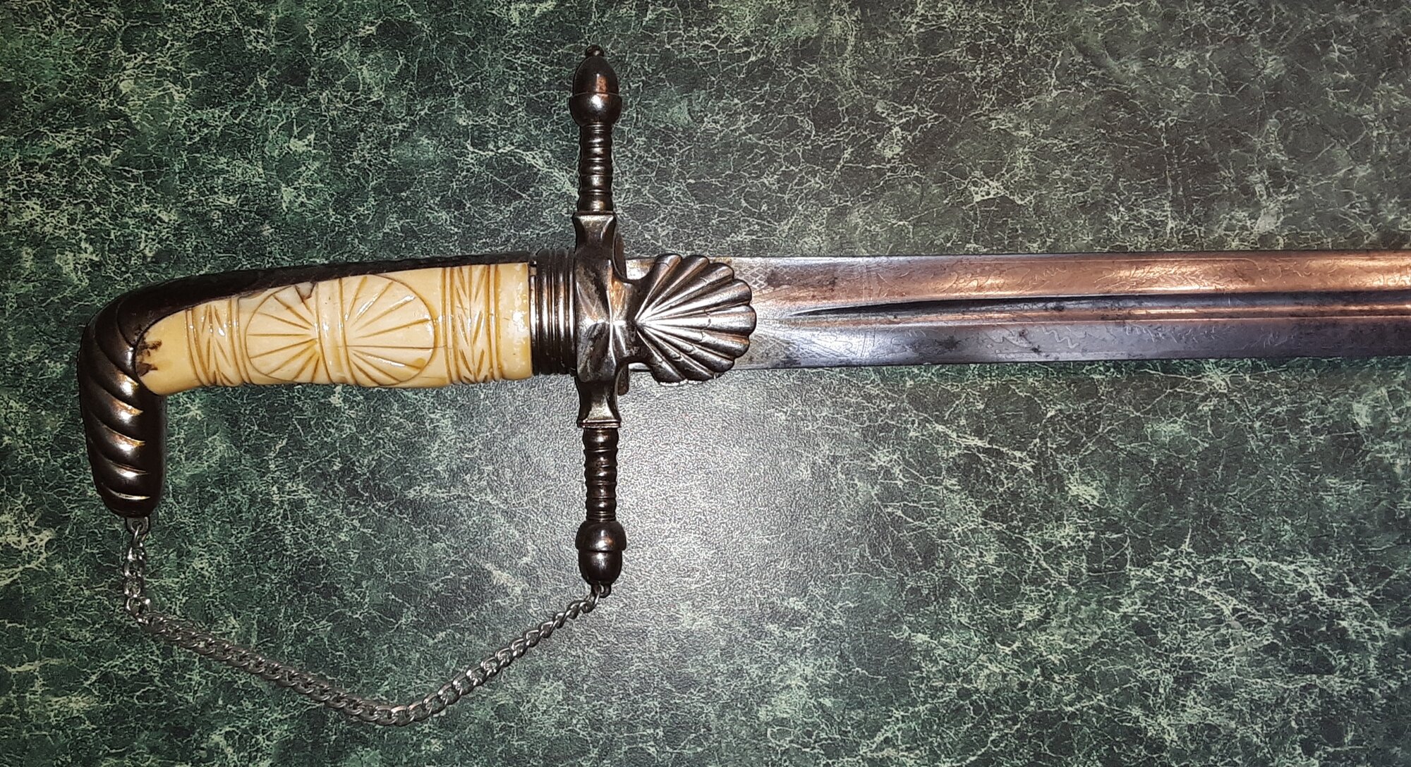

I'm not a sword expert by any means, but straight cross guards with "clamshells" are not unusual on dress swords. In fact, my immigrant ancestor carried a similar sword in the Revolutionary War. I'm guessing your cousin is posing with a couple of studio props. One is an older, light sword with a clamshell and perhaps a chain guard. I think the object on his hip is actually the muzzle of a rifle leaning against him. Hard to say for sure. I expect someone with more knowledge will chime in very soon.
Appears to be a militia officer's sword from the late 1840's through the Civil War period. A similar style hilt with the cruciform cross guard, large clamshell langet, and chain is pictured in Thillmann's book on Army swords, page 569. I don't feel comfortable posting a photo as images in the book would fall under the copyright protection.
