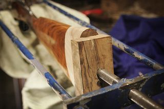

Let's say some chap inherited a rifle or shotgun but it was a bit too short. Are there any known period ways of extending the stocks of guns from the time? Perhaps adding and shaping a block of wood to match the shape of the stock like this?

Let's say some chap inherited a rifle or shotgun but it was a bit too short. Are there any known period ways of extending the stocks of guns from the time? Perhaps adding and shaping a block of wood to match the shape of the stock like this?View attachment 341564
I believe you had it right the first time. It would be very hard to find a stock for an inherited (antique ) gun that would work. It would also be rather expensive to have a stock made to fit the gun. Adding a couple of inches to the butt would probably be the easiest thing. I would think the hardest thing about doing that is to match the finish so it doesn't show. People back then weren't as big as they are now.
If anything, I dont mind the color difference as long as the clear coat is even, ya know, a light stock with a nice deep walnut butt, I would like to reshape it a bit to accommodate the original buttplate though

And what's the stock made of? Maple or Walnut? If you can match the wood, including the way the grain flows, to the original wood, you may be able to hide the extension. I would use Tite-Bond II for the glue, as it may hide the glue line better, but do some research on that.
