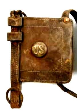

I picked these up today and couldn't find any similar examples with the US insignia. Any help dating is appreciated. Thanks.
Welcome From THE Heart Of Dixie. The reason you can't locate any others is someone has take a US bridle disk and applied it to the stirrup covers. Most US Army Cav stirrup cover were embossed with a US. Also, the maker and or inspectors marks should be stamped in the wood on the bottom of the foot piece.
No problem we are always willing to help.
Civil War McClellan saddle stirrups were made without the later stamped US in an oval on the leather hood itself (similar to the CW Union belt buckle) but this occurred during the Indian Wars time period in the late 1870's and was in use from that point on until the McClellan saddle was done away with before WWII. That stamped US in an oval is correct for those later time period stirrups as shown by ucvrelics and would have been on thousands of these stirrup "hoods." After the ACW, the width of the wood stirrup tread was increased to 4" wide about 1869.
I have no idea why the US brass disks from horse blinders were applied to those stirrup hoods and why they are missing the stamped version on the leather.
Civilian made to appear military?
