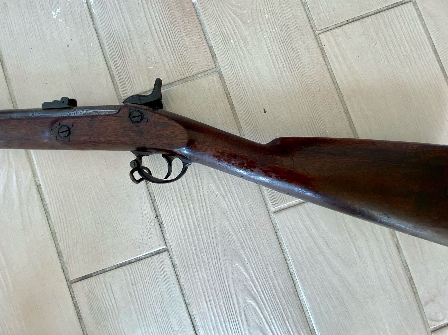

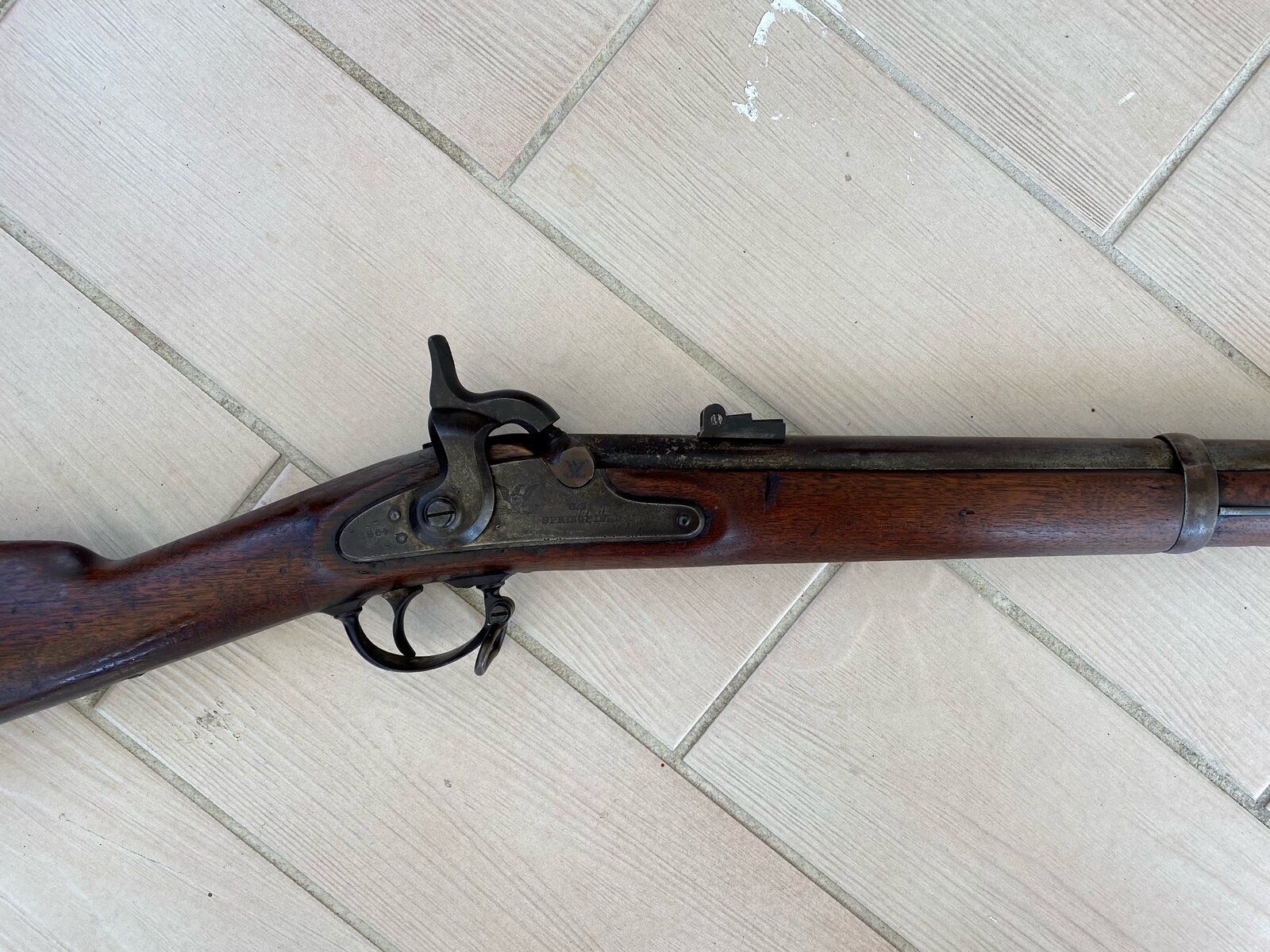

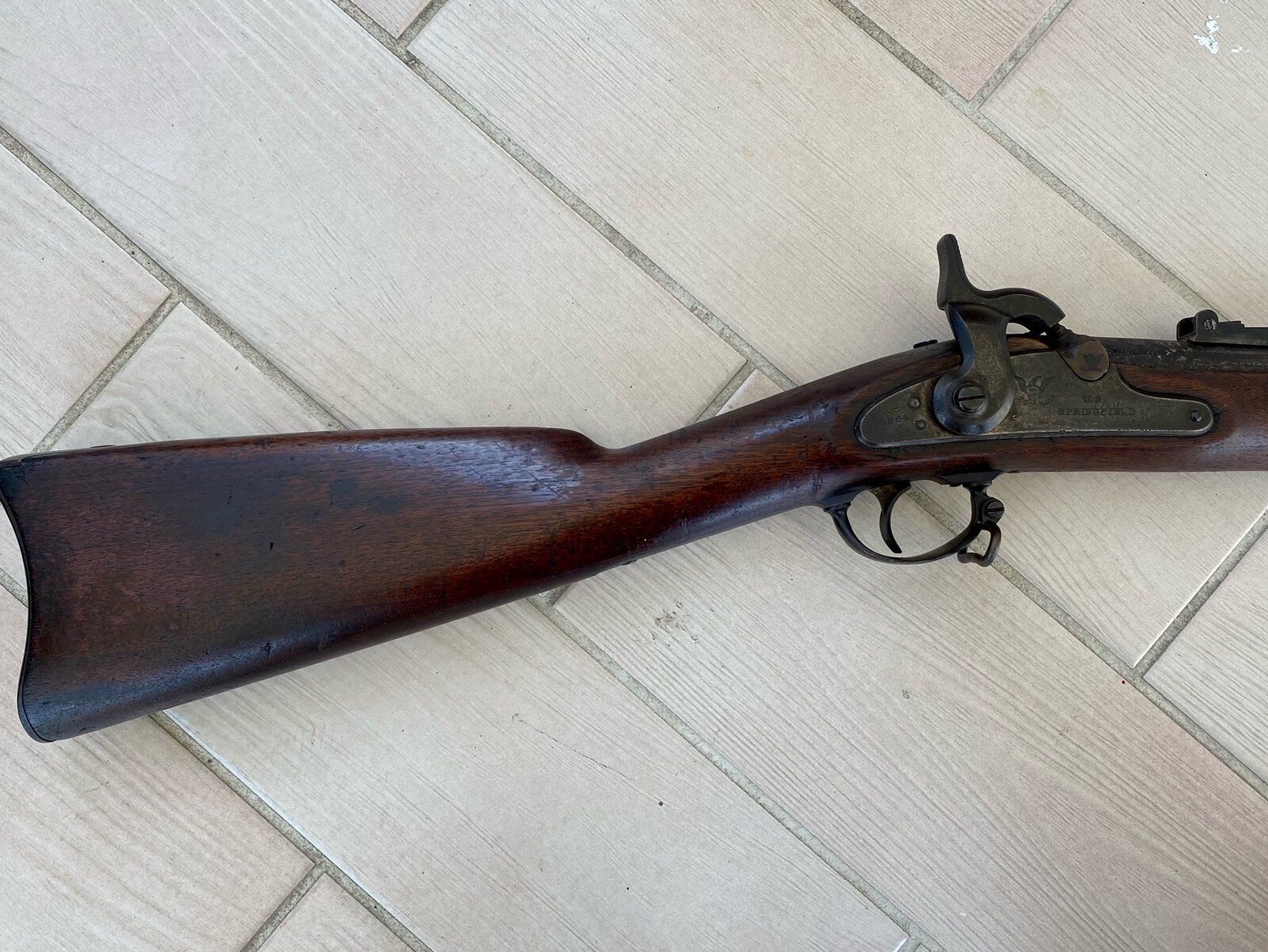

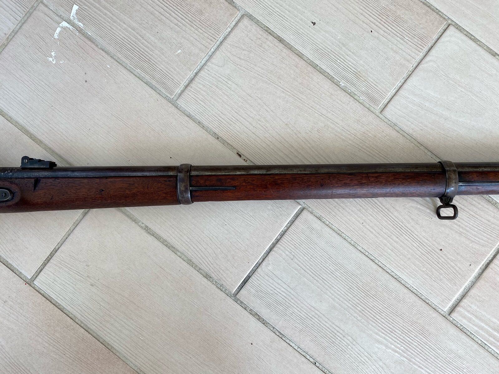

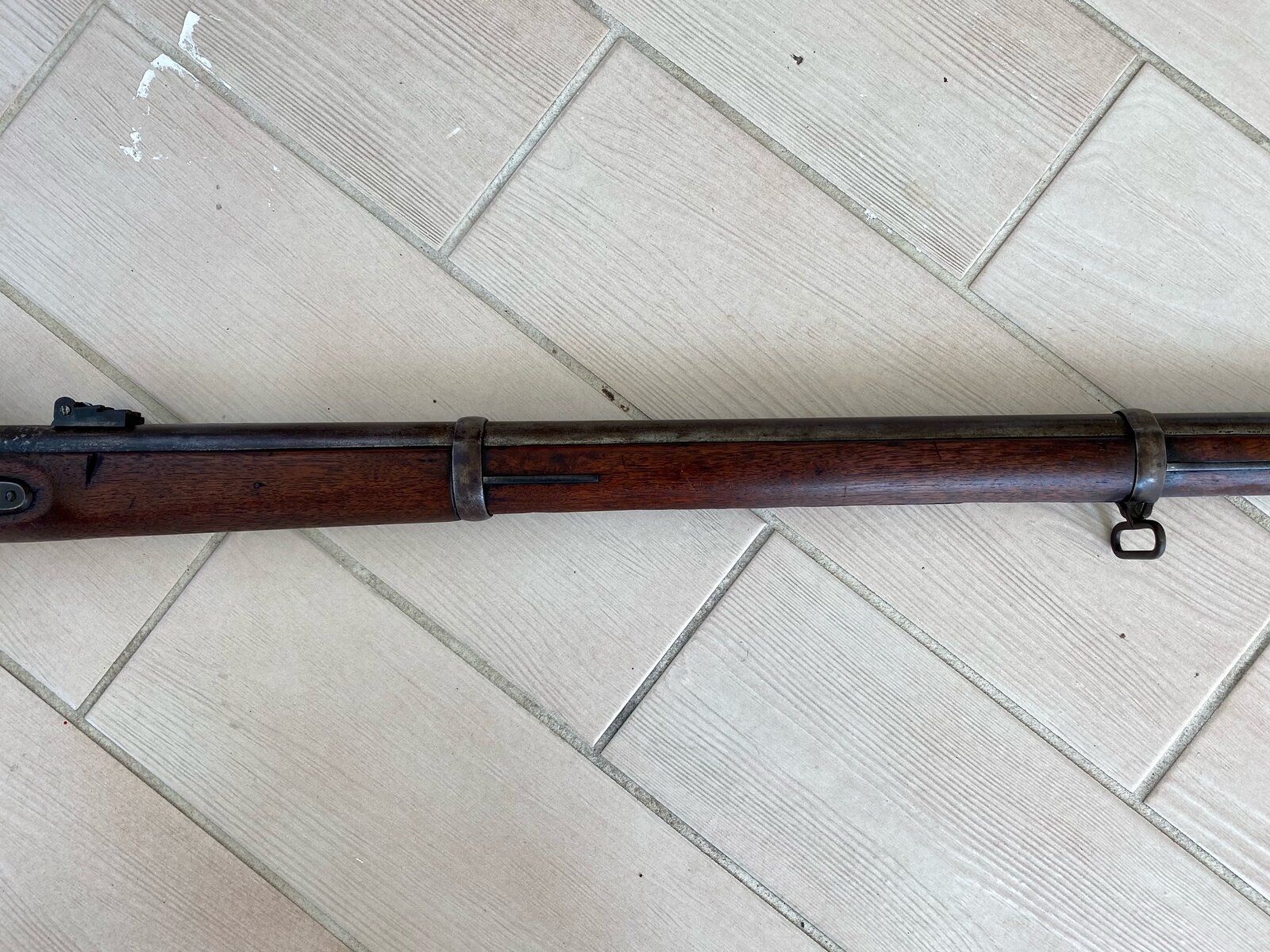

Hello,
I'm not exactly sure how to refer to this, whether a model 1863 type 2 or model 1864. I've seen both. Anyway, this is a recent purchase. It's pretty much exactly the type of rifle musket I was looking for as far as price range, conditio, and appearance. I am new to this but I believe it to be original-bayonet was purchased separately but patina and overall appearance match up well.
It is quite dirty, though. By just handling it, my hands get dirty and rust stained. I gently wiped it with a damp cloth, but am hoping to clean it up a bit- to make the components look more distinct and to conserve it.

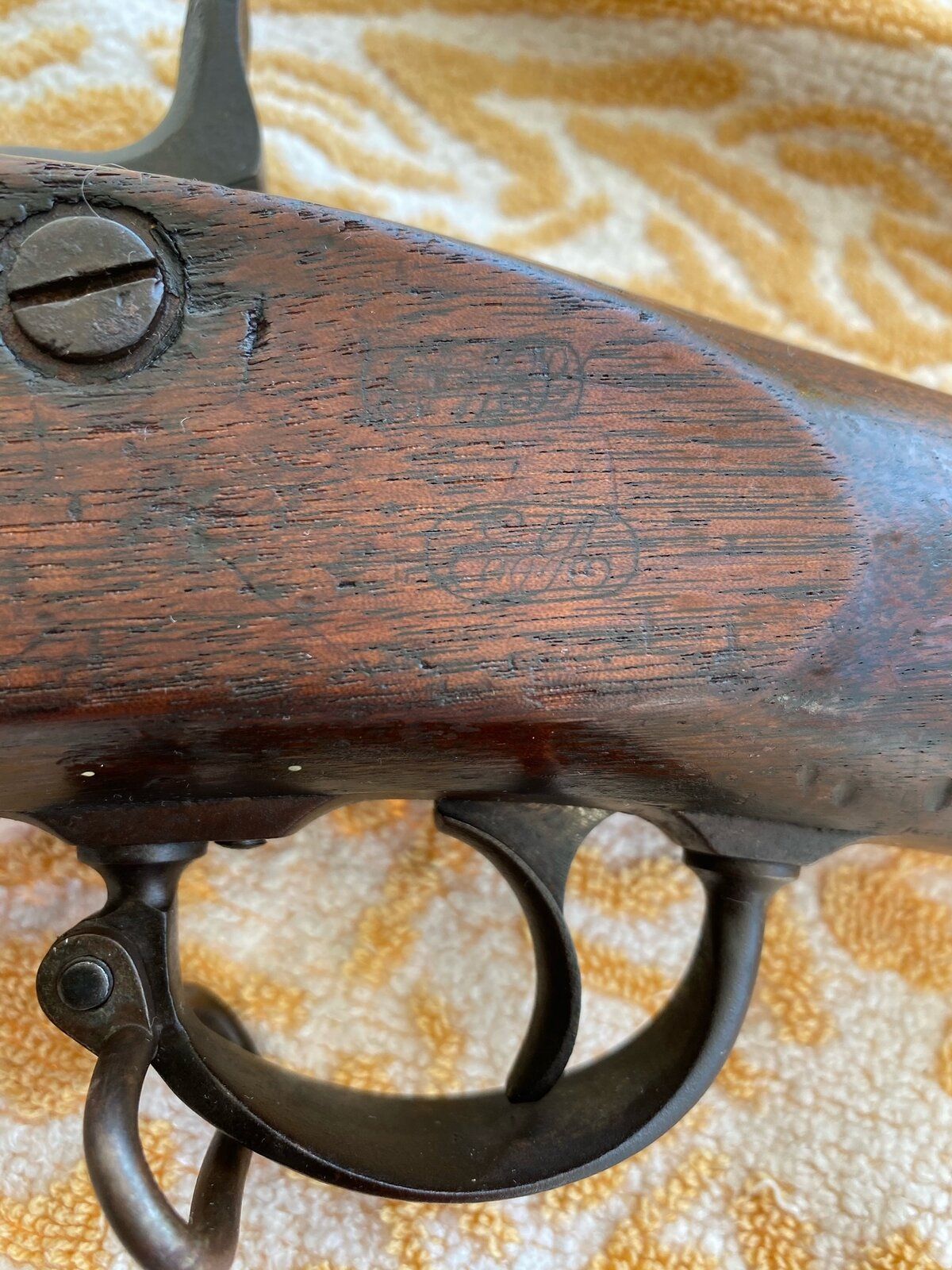

I read on the NRA museum page to clean these with a little dish detergent and then dry. After that, they recommended mineral spirits. Would that work? I don't want to get it to the point where you see hairlines all over the metal. I like the used, old look. I would like to bring out the markings. There's also a barely visible cartouche- is there a way to bring that out?
Thanks everyone.
You could remove a lot of the surface rust and stop any active rust by using Balistol wipes or applying it from the can using a soft cloth. On any of the stubborn rust use nothing more abrasive than a soft toothbrush. Truth is a lot will come of with the Balistol alone by gently wiping it. Leave a light coat of the Balistol or oil on the lock, hammer, barrel and barrel bands, It is safe for the gun and for you, but open a window because it does smell a little bit.

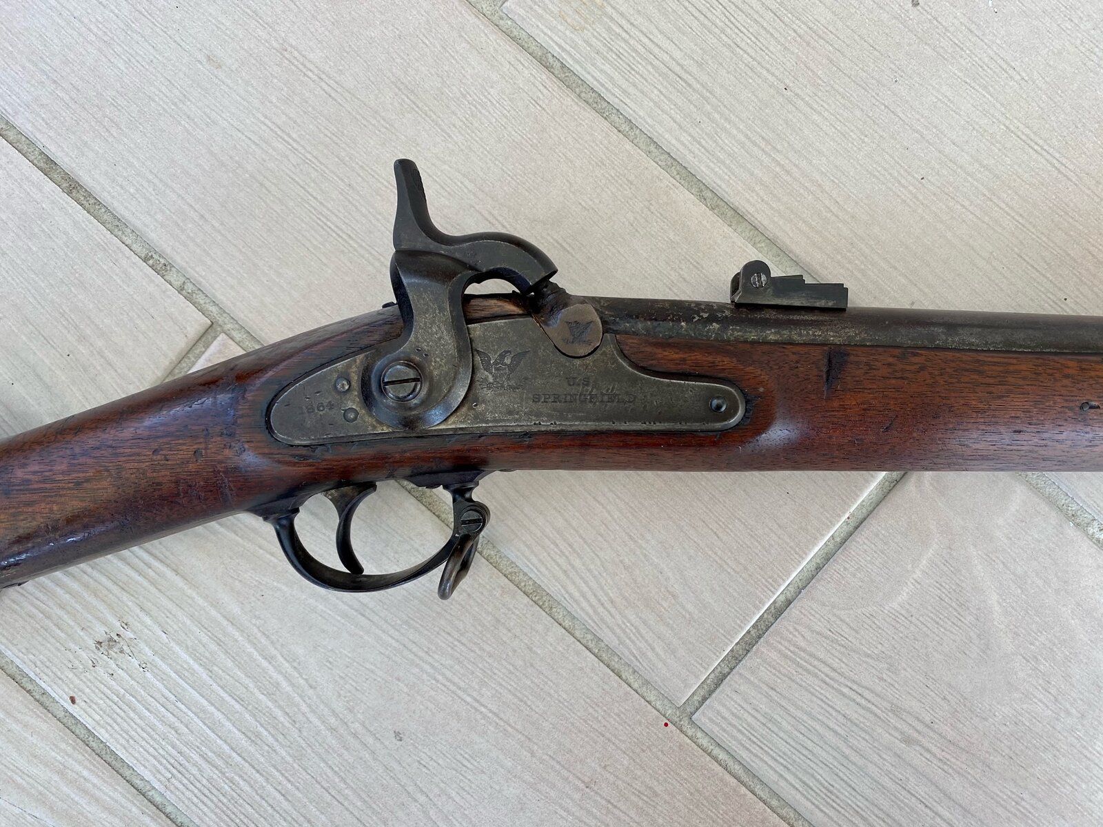

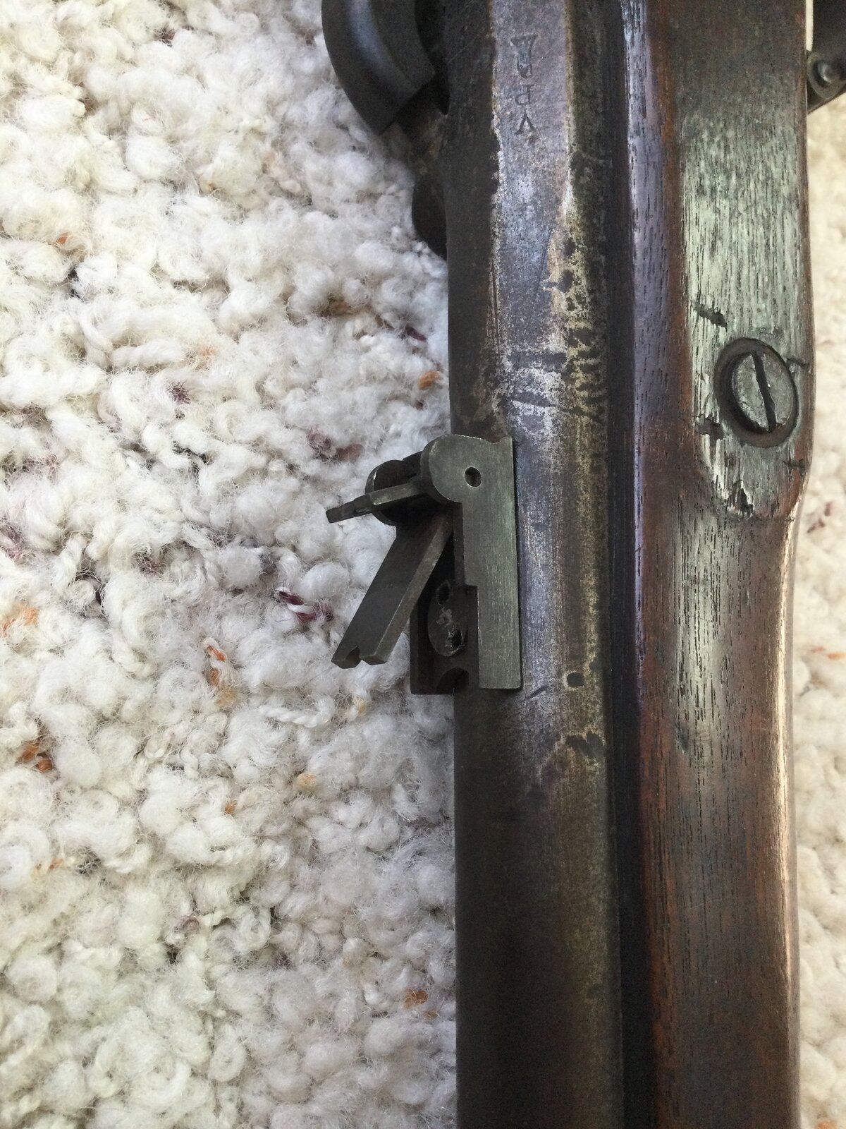

Thanks for the comments. I like it a lot, but I'm not sure if the rear sight is correct. I know it was added. I read that the type II's have a single leaf sight as opposed to the first type m1863, which had double leaf sights. However, I also read that sometimes the double leaf sights were used on the early type II rifle muskets. This one has two leafs (I'm assuming the leaves are the pieces that fold up and down).
Reading through some posts here, I see that a product called Kramer's Best Antique Improver is recommended. Seems to be a good cleaning/conditioning option. I'll give that a try.
I think I am good with it now. It's a lot cleaner and I believe the wood is conditioned. You can see where the original finish came up and was worn. I wouldn't mind getting the lock plate a bit cleaner, but I don't want to mess with it too much. I'll let it sit for a couple of weeks and then apply some ren wax. Thanks for all the advice on purchasing and care. Now on the hunt for the next one...

She looks nice. An M1864 with nothing to be ashamed of.

As with the Stock after a very close examination I spotted the cartouch, I used scrub brush sponge with Dolbie pad with Murphys soap with hot water. Got all grime off then a few coats of Boiled linseed did the trick. One site I used to help was this one for cleaning "Procedures to clean your M1861 Springfield Percussion Musket" Google it and its a free download.
