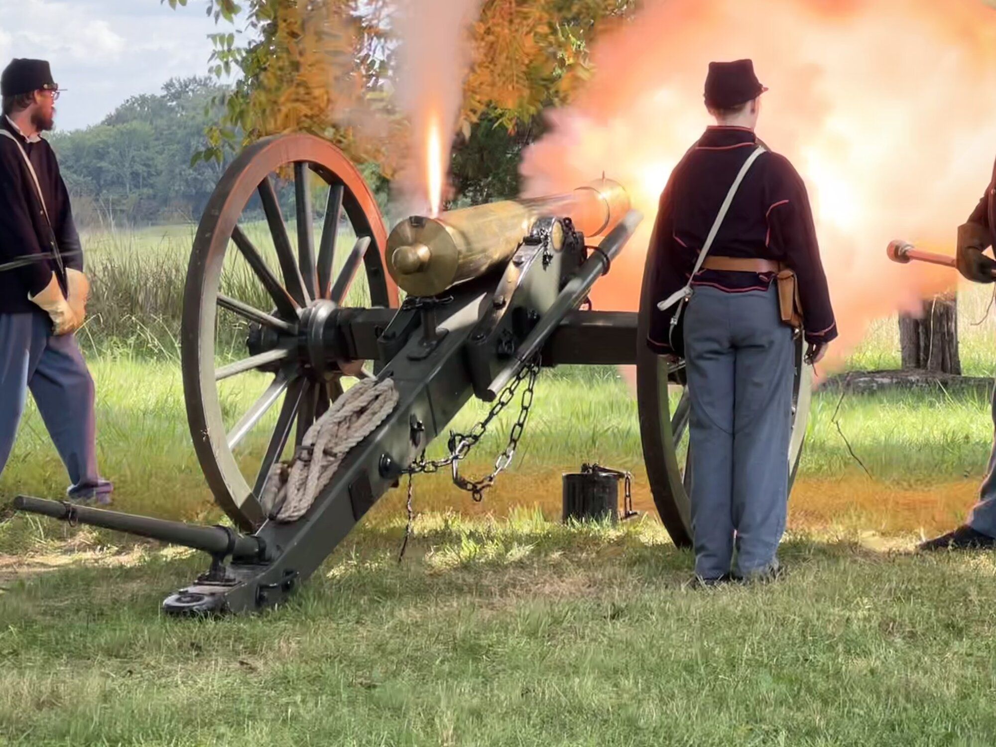

The chains are attached to wedges that lock the caps in place. No axe necessary, they are intended to be removable. The chain is there to keep them from getting lost.
I should clarify this - I meant to break the chains that held the cap square to the carriage ( They were also attached to the carriage with a chain) , then either take it with you or throw it away somewhere away from the gun. You could easily find a replacement for the pin, but not for the cap square.

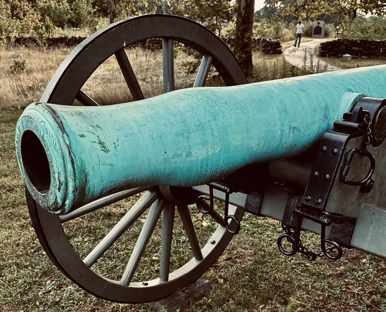

This 12 pound Napoleon on display at Gettysburg may have been deliberately slighted. The bulge in the chase could have been caused by loading a charge & then wedging a ball inside the muzzle. The expansion of the gas in the blocked void is extraordinarily violent. This could have been done deliberately or by happenstance.

Another quick way to disable a gun was to remove the cheek caps.
All they had to do was pull the keys & throw the caps away. That happened at Gettysburg. It would be an adventure to fire one round… Using the handspike as a lever, it is simplicity itself to stand the gun onto its muzzle & push it over on the ground.
