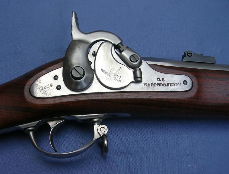

Model 1855 Second Pattern Harpers Ferry rifled musket. Cal. .58. Lockplated dated "Harpers Ferry 1859." Fully operational Maynard primer. All correct proofmarks; defarbed by John Zimmerman. Armi Sport manufacture. While this example is sold, send us your rifle, and we will set up a working Maynard tape system on it for $700.00 plus shipping/handling. Who else does a Maynard tape system? It is about a week's worth of smithing, but well worth the effort.

So, just for one example...look at the images of the Zimmerman repro US 1855 with functioning tape primer lock (above), which is nicely done. Note the flash shield behind the cone in the bolster area. The US model 1855 did not have that. The hump portion of the lock plate negated the need for that. That flash shield was a feature beginning with the US model 1861.
I've messed with one of Zimmerman's '55 locks and it is very well made. Of course, however, it begs the question as to why go through that expense of getting a fully functional Maynard primer lock, much less the trouble of making one when there are no Maynard tapes to use? Aside from simply being able to look at it and go "wow" it serves no purpose to us today - unless we can convince CCI or RWS to offer Maynard tapes. ;-)
