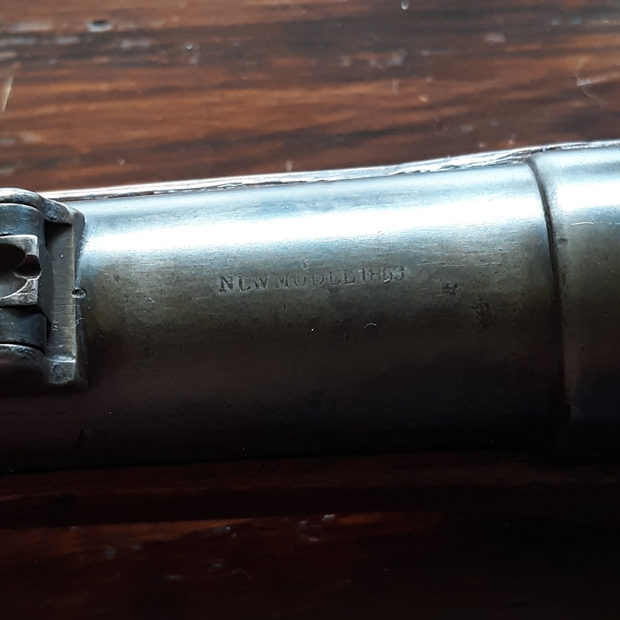

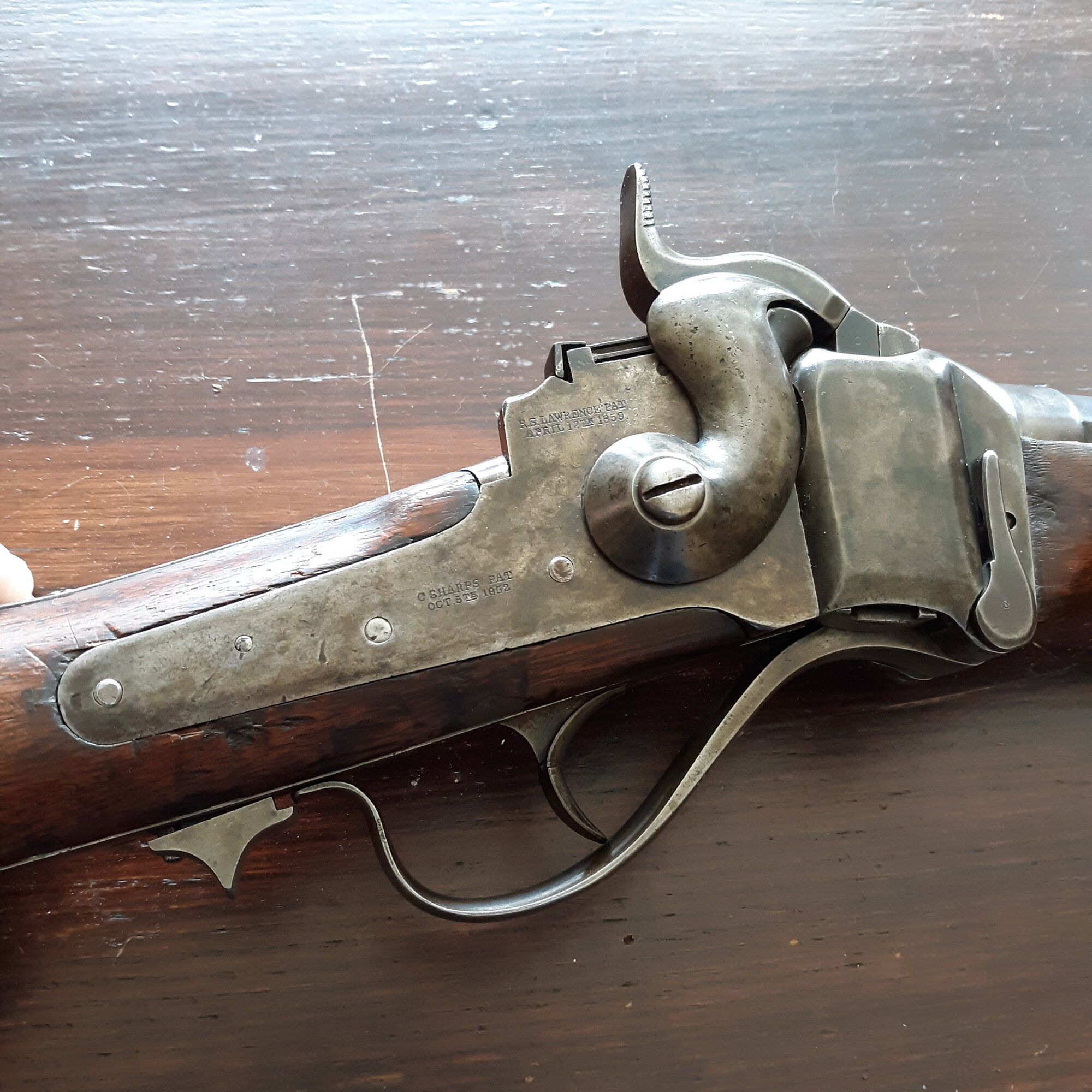

Hi Guy's, new guy here. I just bought a Sharps carbine, serial # C9950. The barrel serial # matches. It Looks like .50 caliber. Can anyone advise if this has a Unit history? Any info would be greatly appreciated.

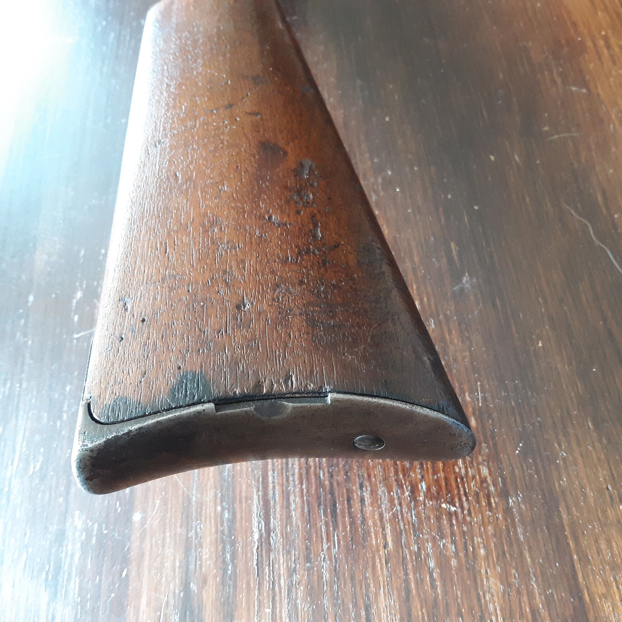

Also has a 3 groove barrel and does not have a patch box stock but has the notched patch box butt plate.

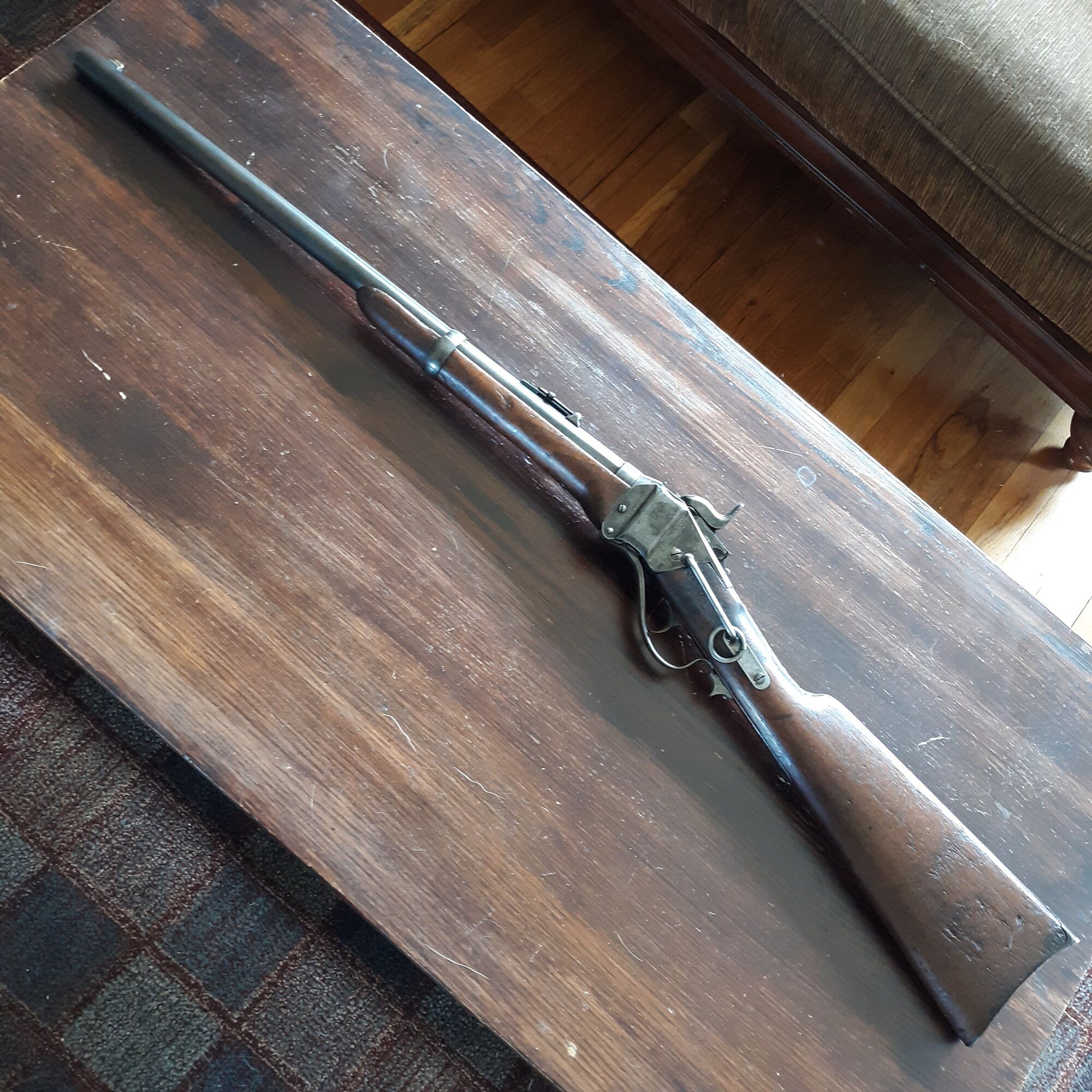

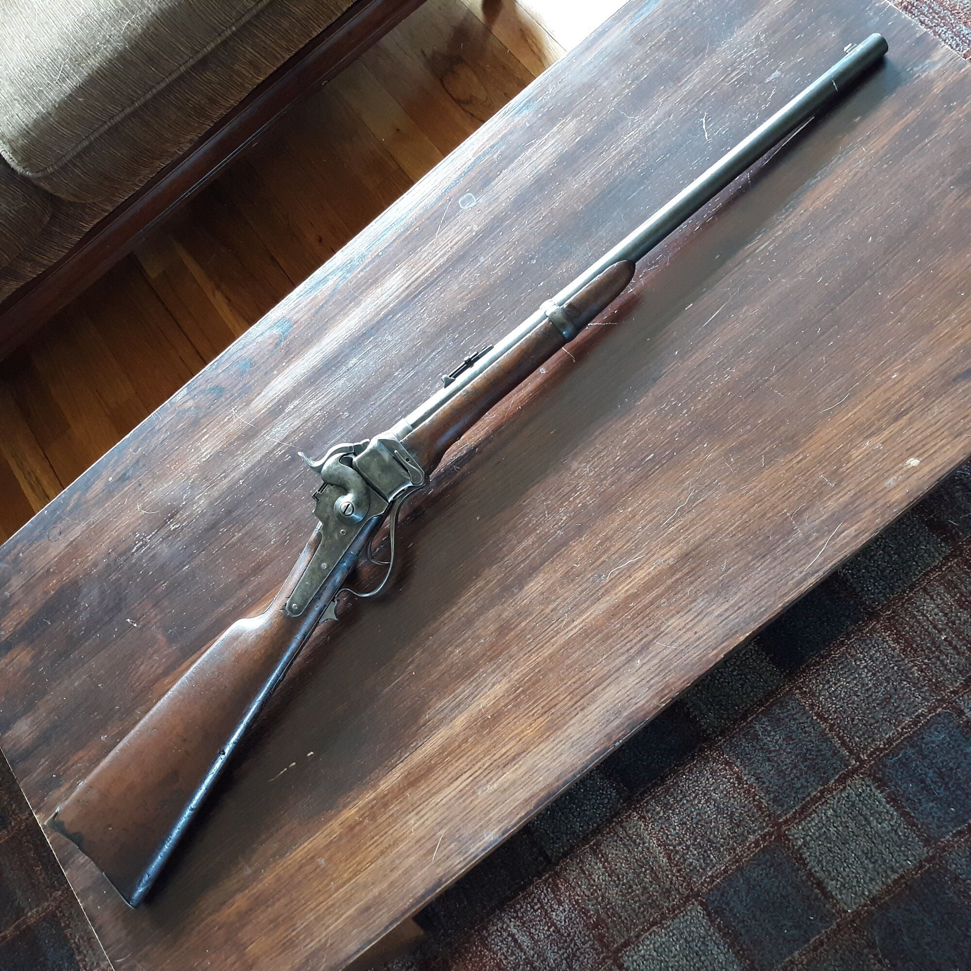

Photos added
You have a Sharps Carbine that was converted to .50-70 that any collector would be quite happy to have. It's been through at least one arsenal rebuild. The butt plate if off an M1859 Sharps carbine which is fine as these were interchangeable arms and the armorer really didn't give two figs about collectability. He just wanted it out the door.
