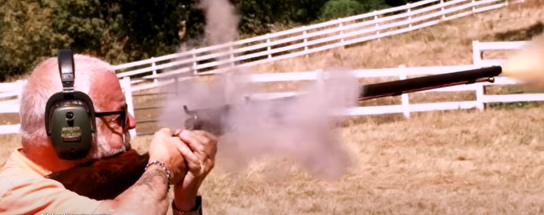

Just to prove my point - here is one of those 1855 Colt revolving rifles being fired:
Now that's a worthy picture of a smart shooter. I'm sure the side blast is even more intense with the rifle barrel containing the gas longer. Notice the cylinder gas has cooled with flame no longer present but still plenty of flame at the muzzle. It was a poor design alright along with the detachable stocks Colt offered with their revolvers for the unwary. FWIW the cylinder gap on my Colt Navy measures .010", my S&W .38 Special Target Masterpiece is only .003" since powder fouling isn't an issue with smokeless powder. YGMV (your gap may vary)
