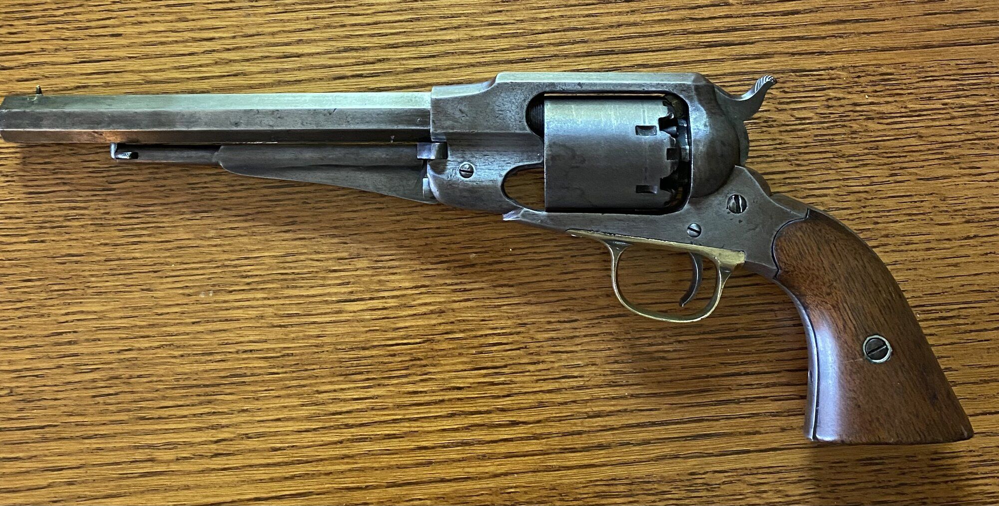

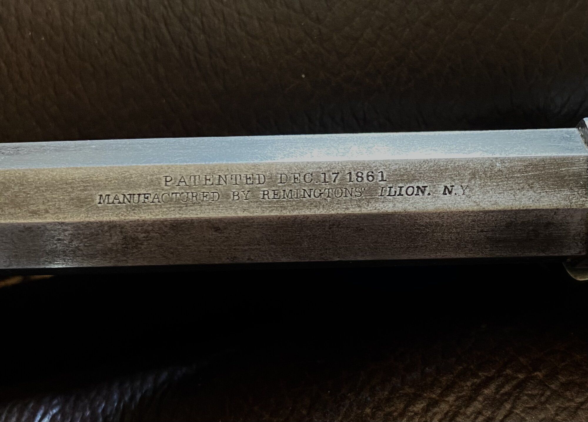

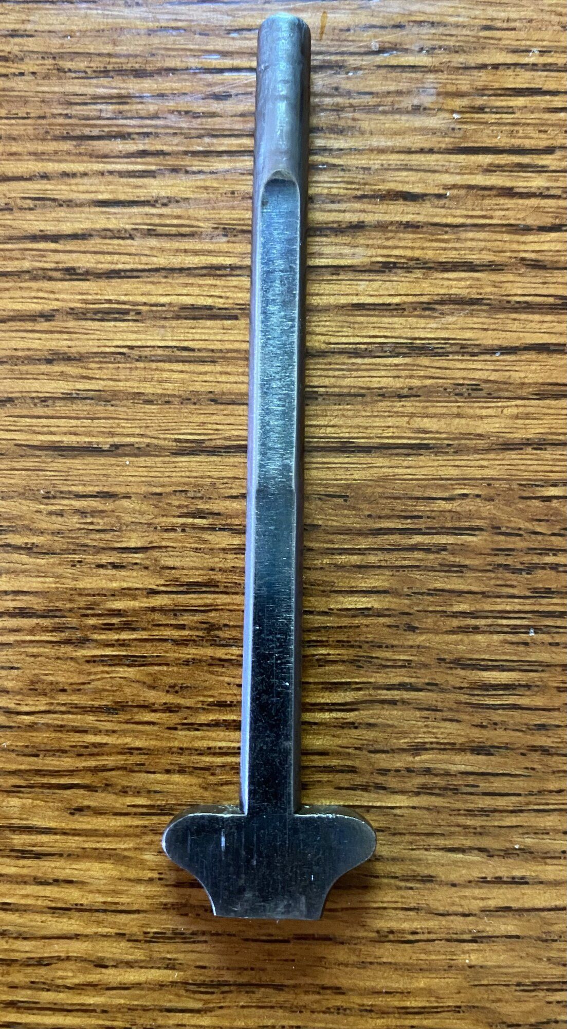

I have been told that my revolver is a transition model. Can anyone help me confirm this?

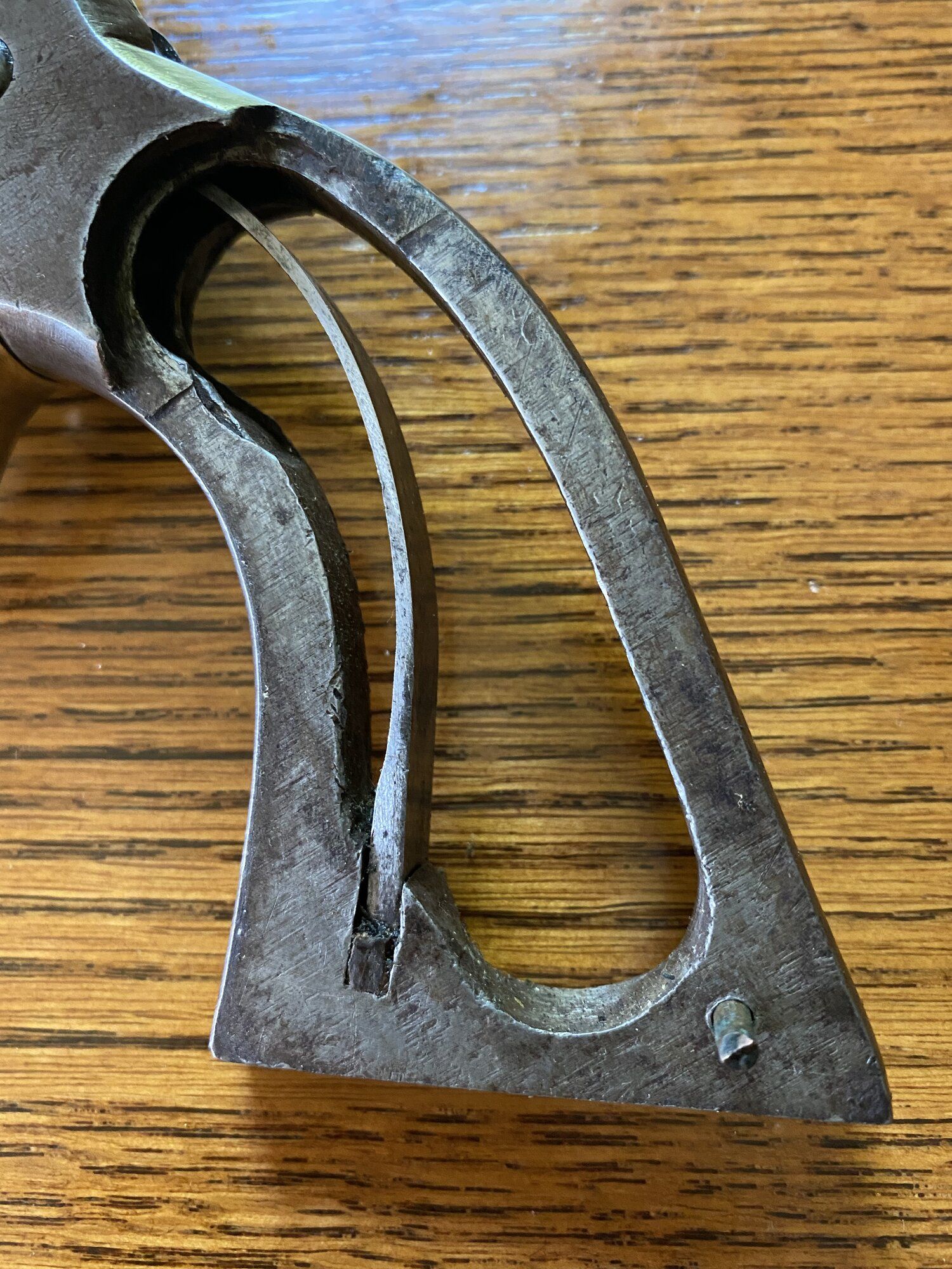

Can anyone explain the absence of a serial# under the left grip? The screw on the trigger guard is frozen so I can't remove the trigger guard.
This was an estate auction of a homesteader from western Nebraska who, according to relatives, had brought the revolver home from the Civil War.
View attachment 447206View attachment 447207View attachment 447208View attachment 447209View attachment 447210View attachment 447211View attachment 447212

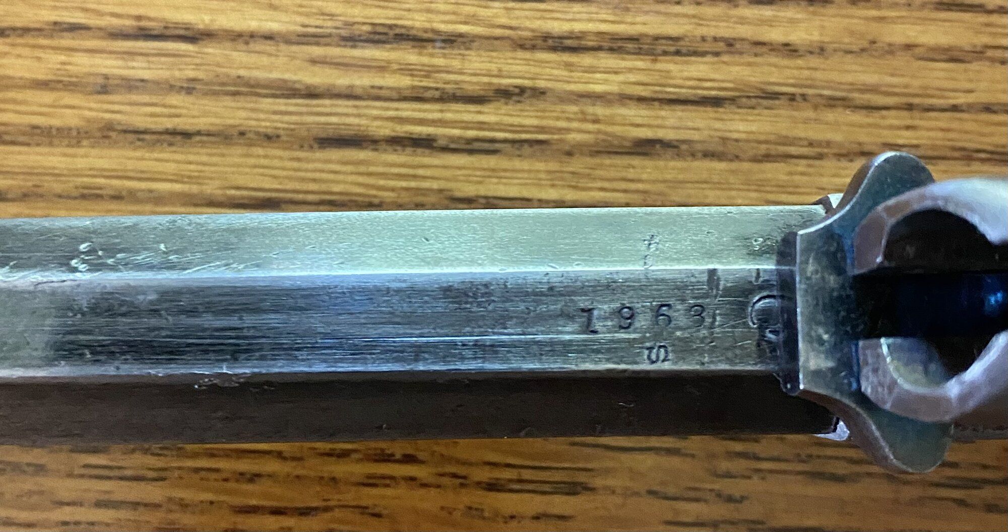

Nice Remington. The 2 line address is an early production. The transition models ran from serial # 10,000 - 22,000 and with this one being 1863 it is not a transitional Remington. Are there any marks on the trigger guard?
Nice Remington. The 2 line address is an early production. The transition models ran from serial # 10,000 - 22,000 and with this one being 1963 it is not a transitional Remington. Are there any marks on the trigger guard?
They all are supposed to have the serial on the side of the frame, which you pictured, showing no serial. I don't understand that.
IF you take the brass trigger guard off, the serial will be on that tab that is hidden when the guard is in place.
