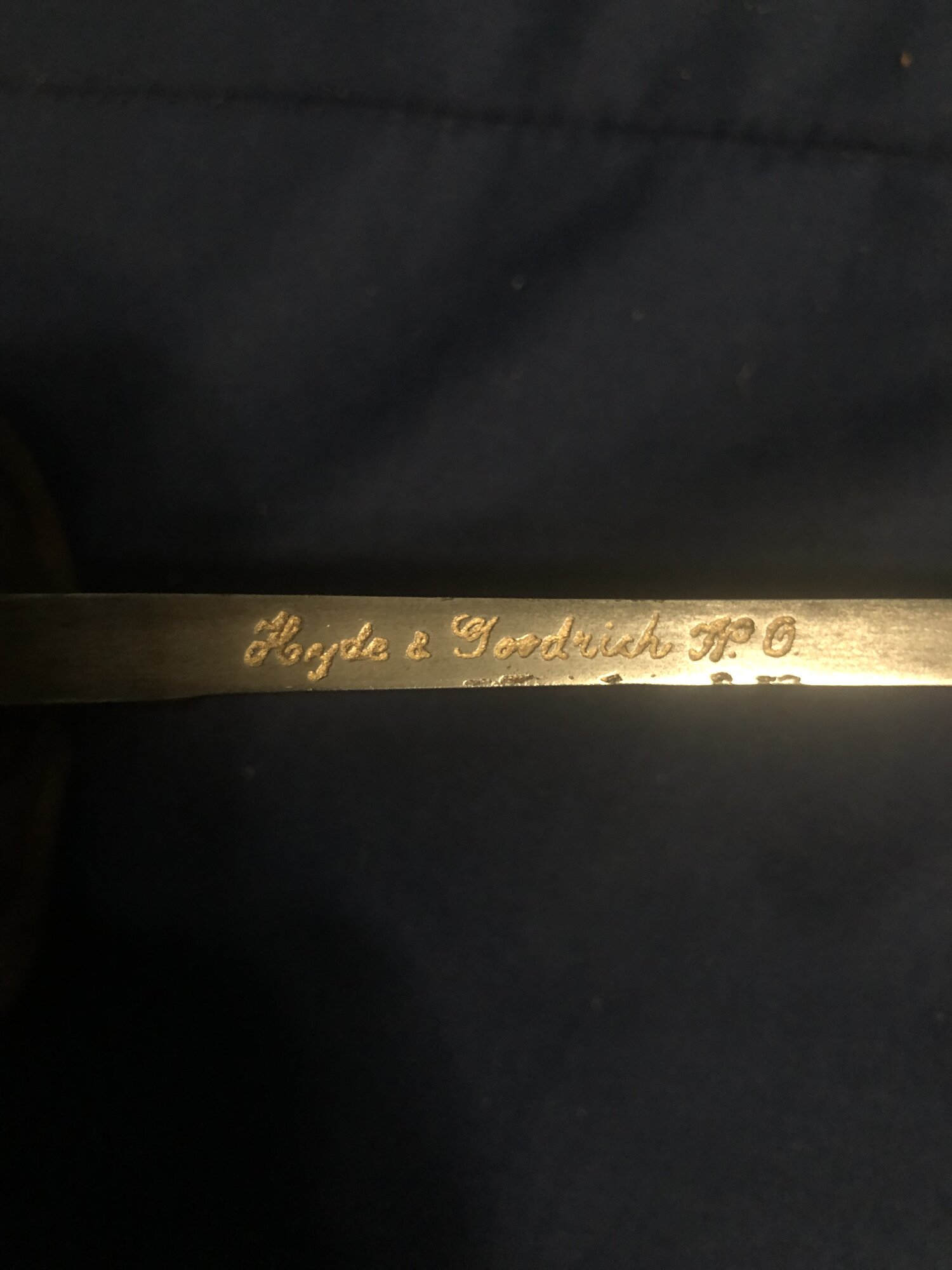

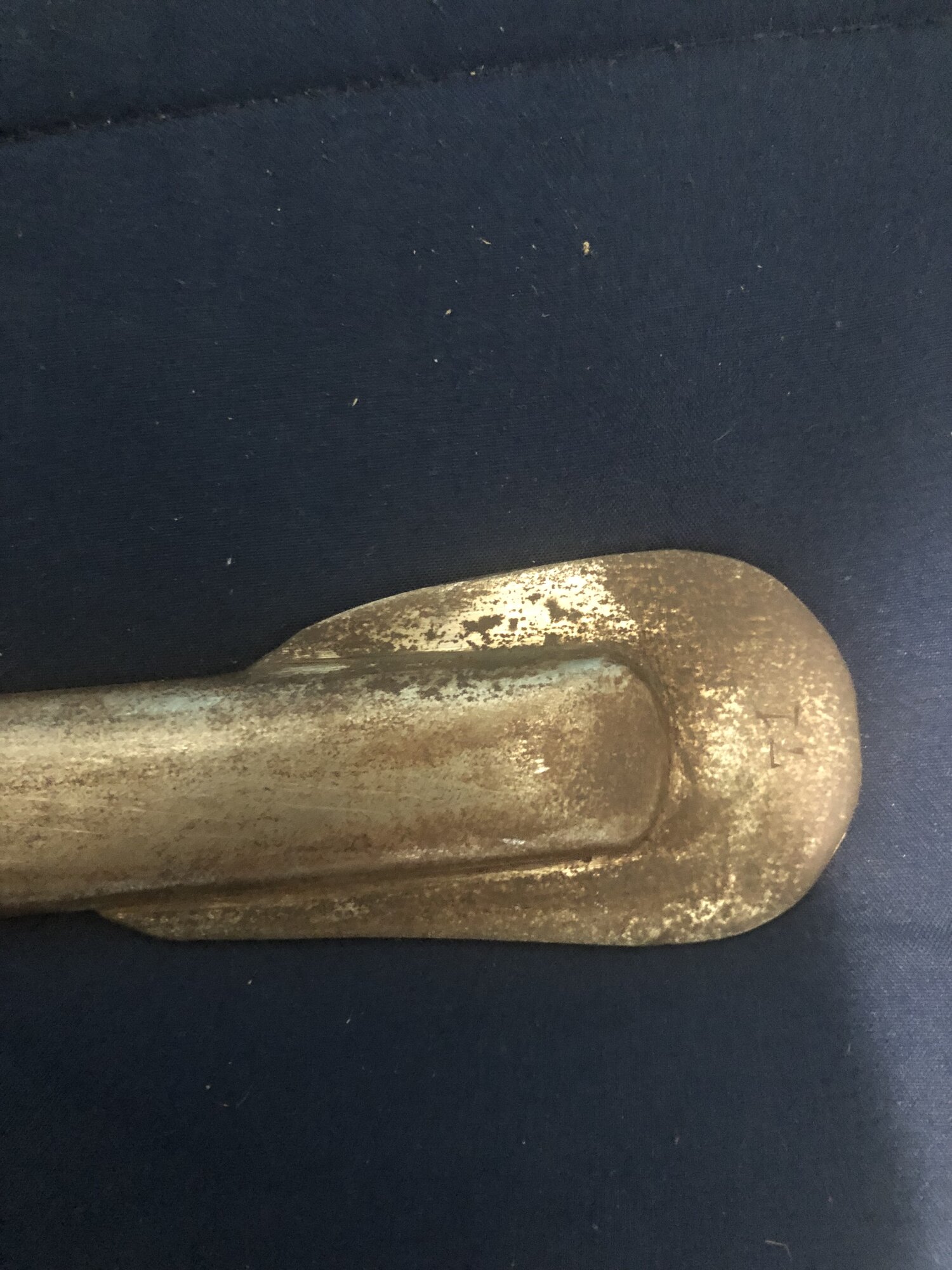

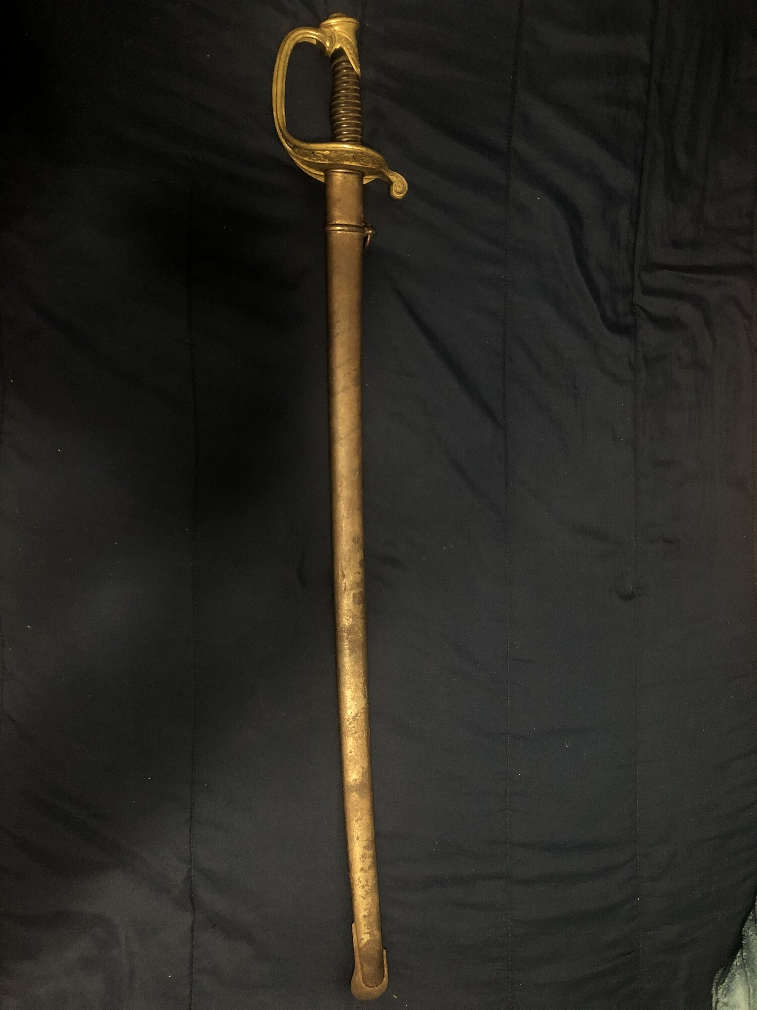

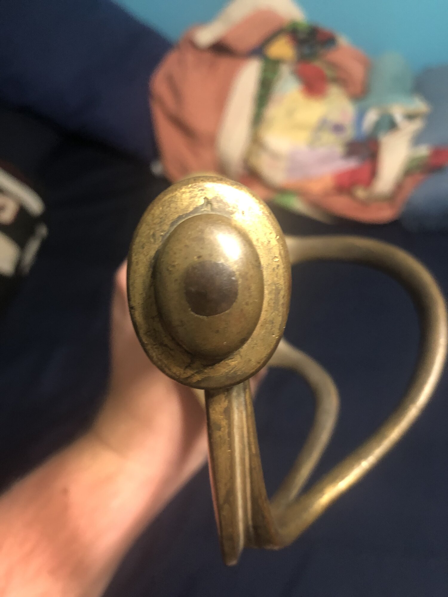

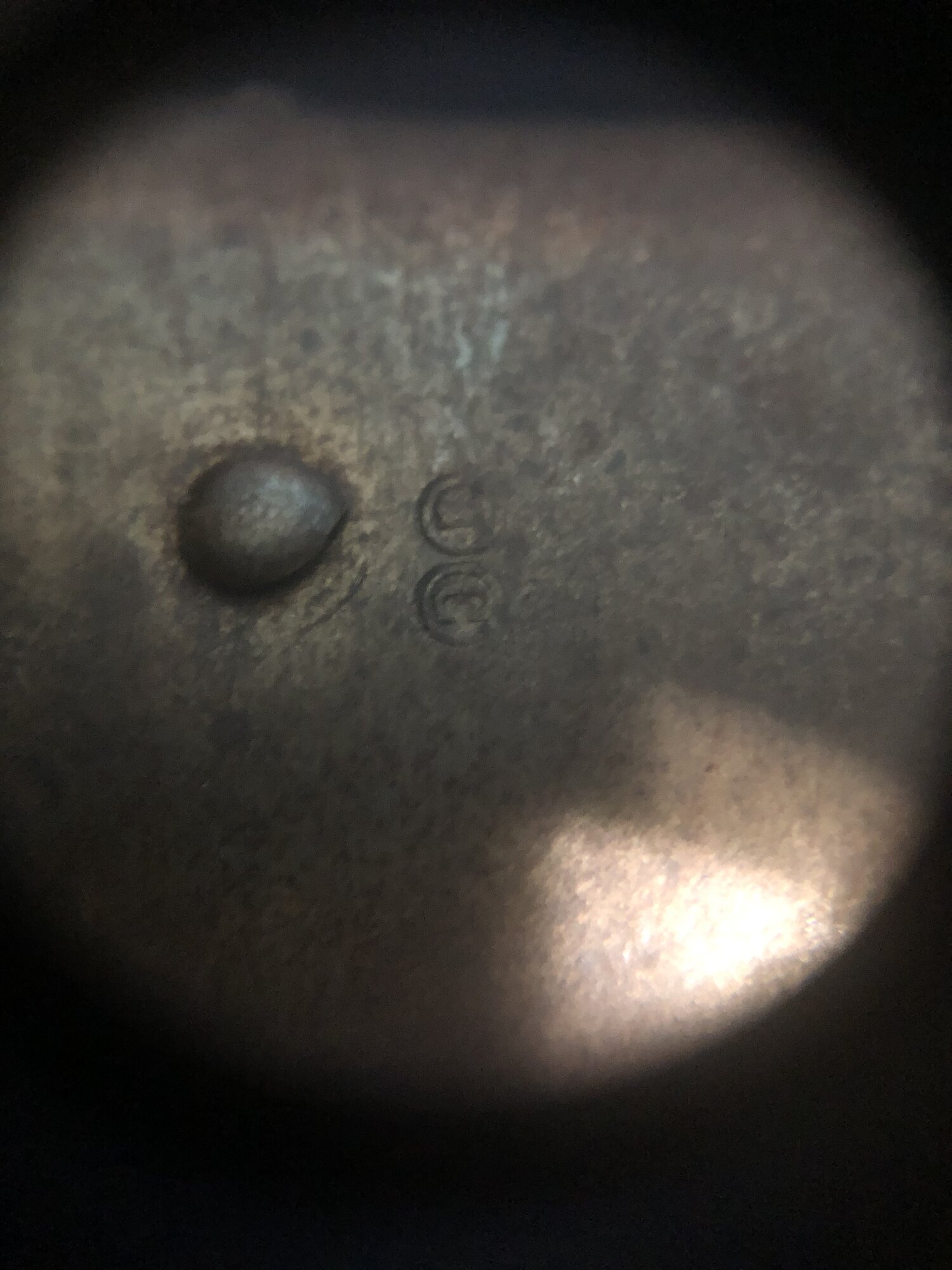

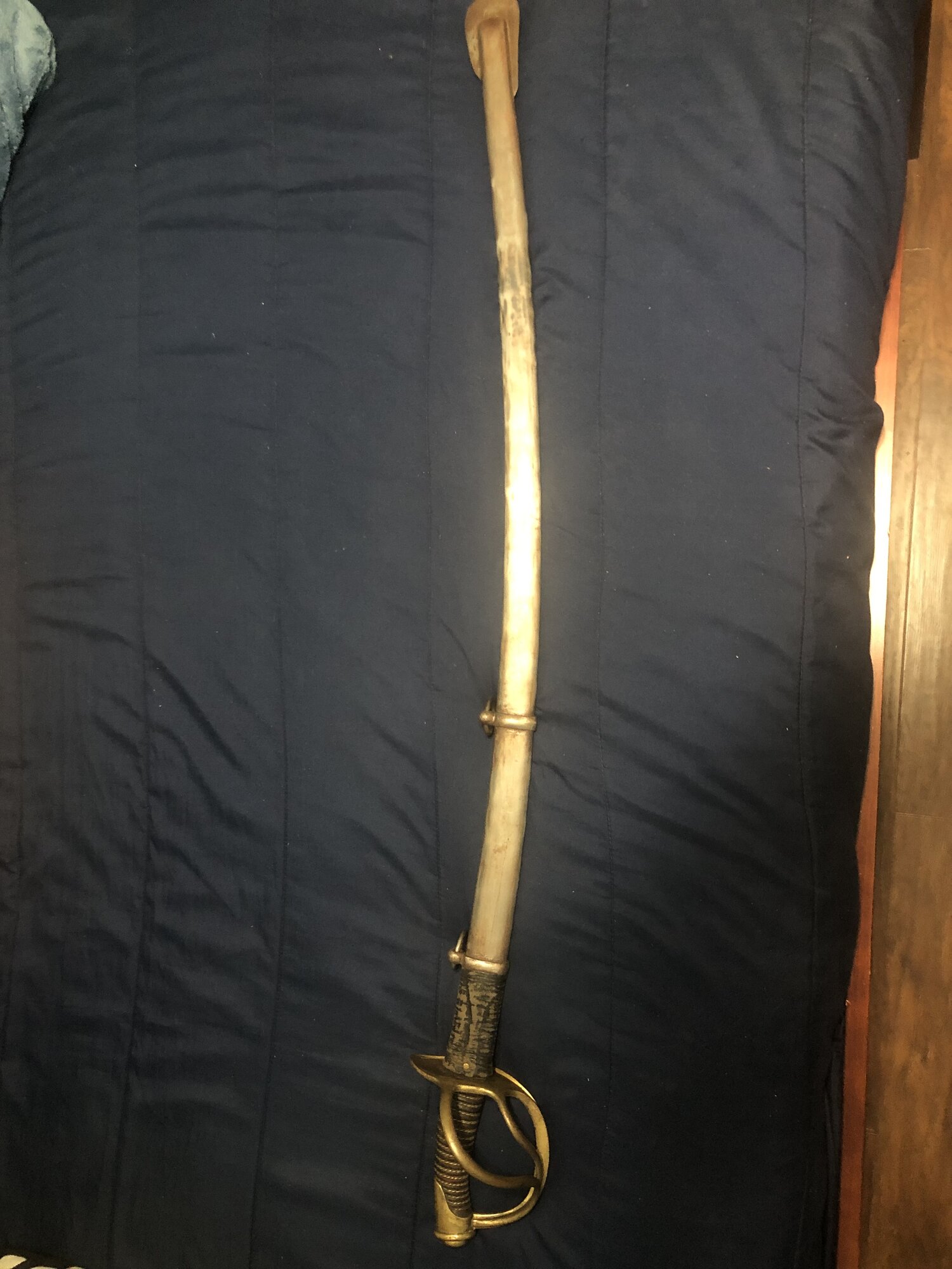

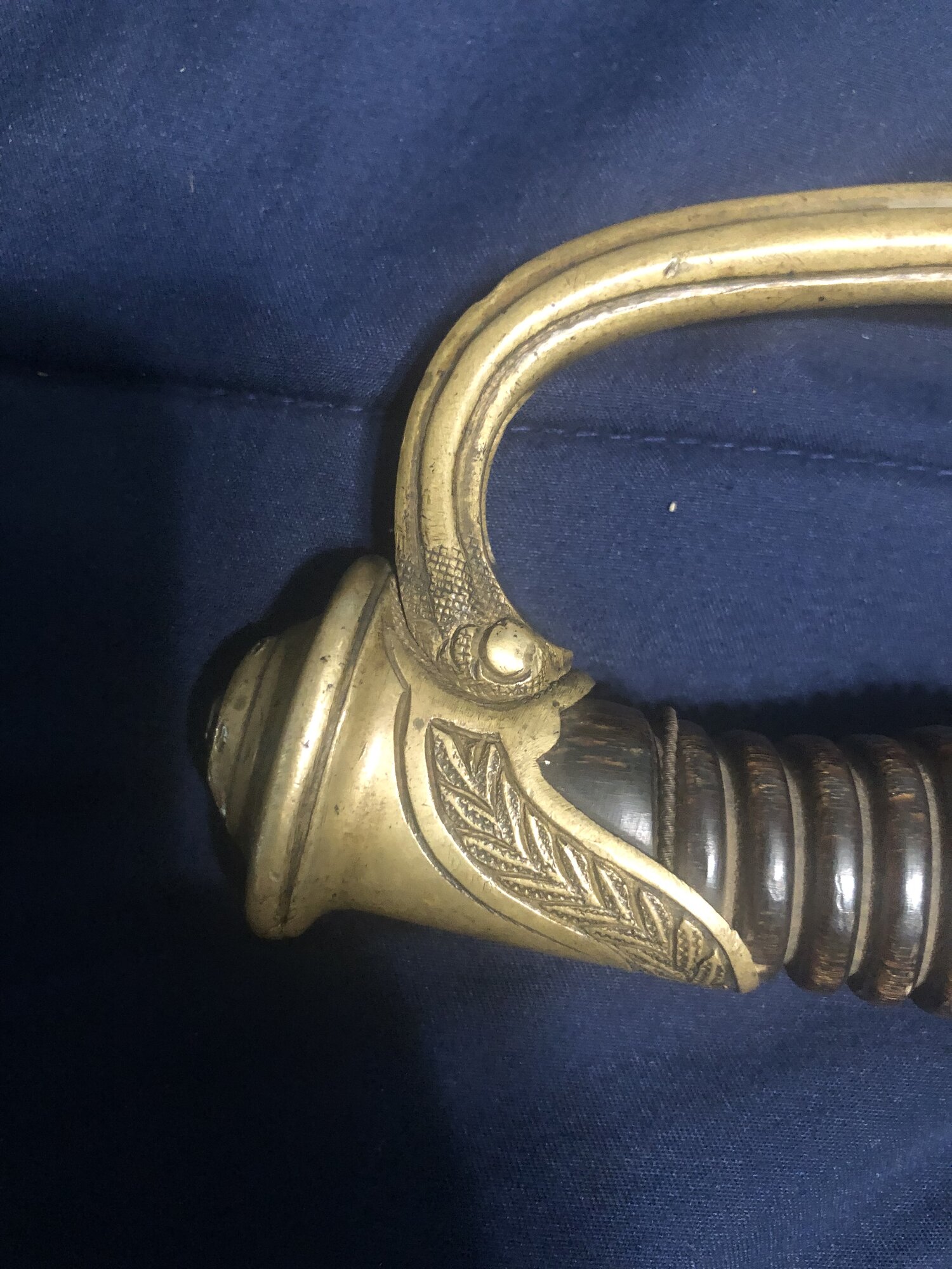

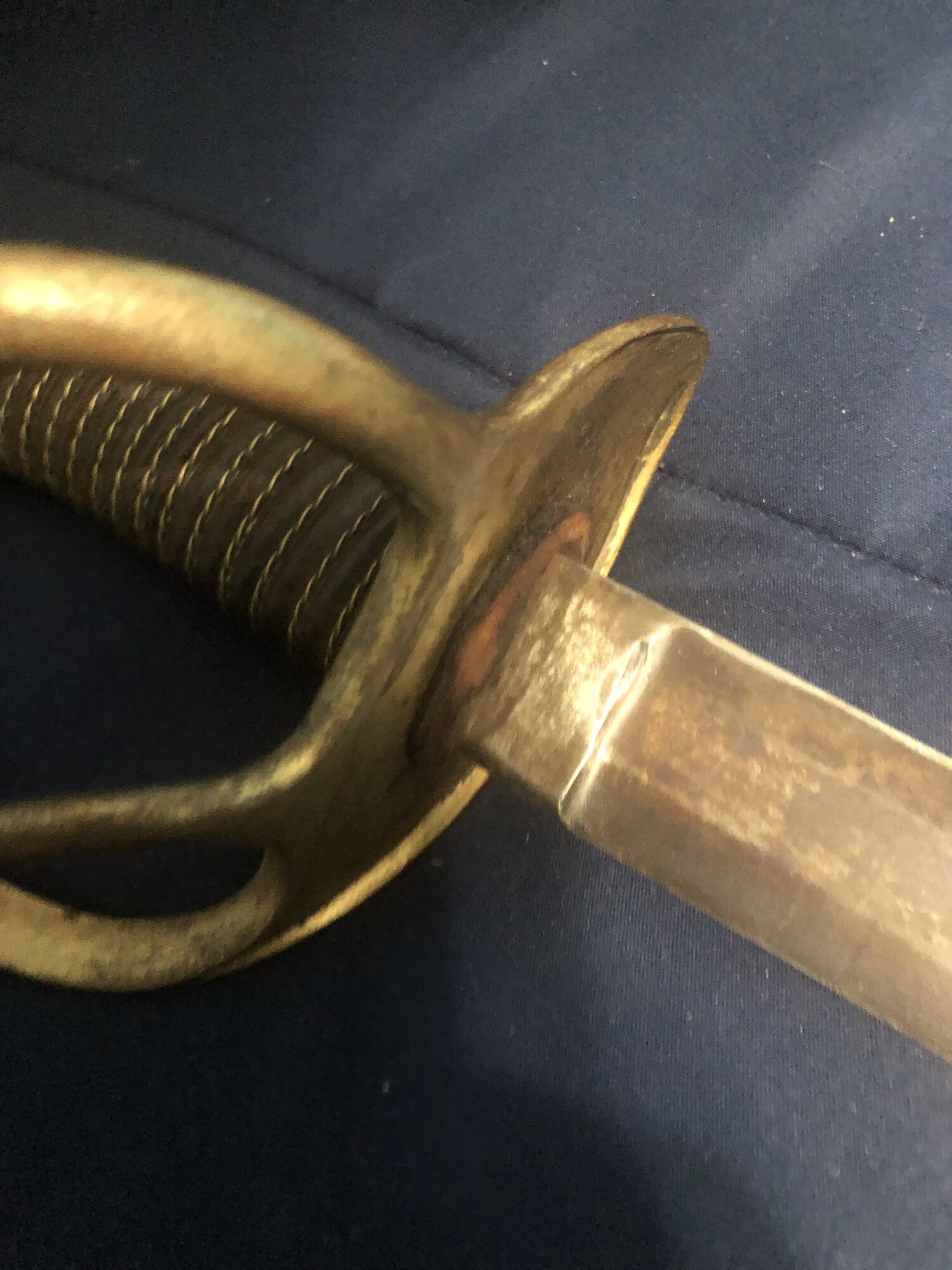

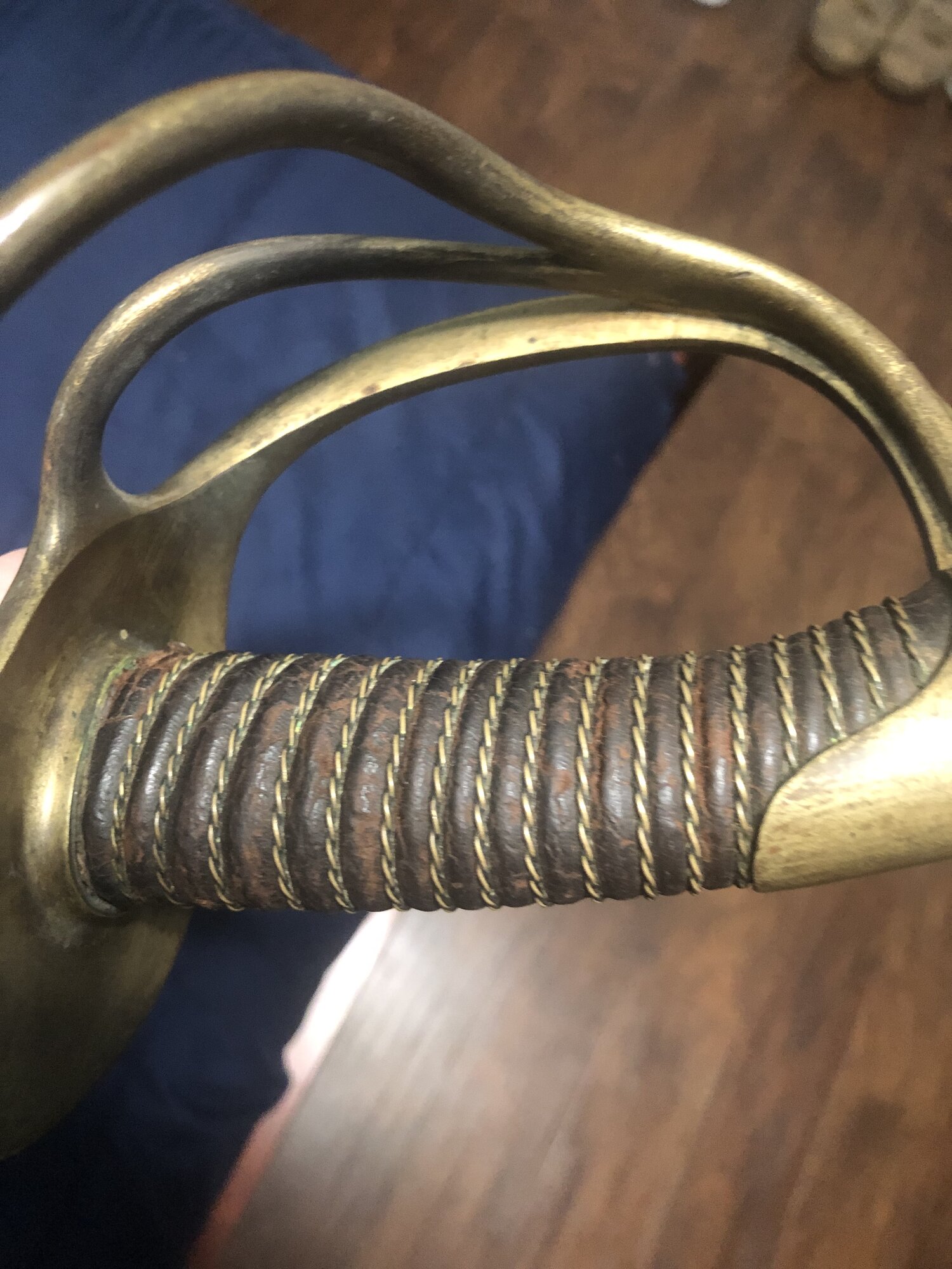

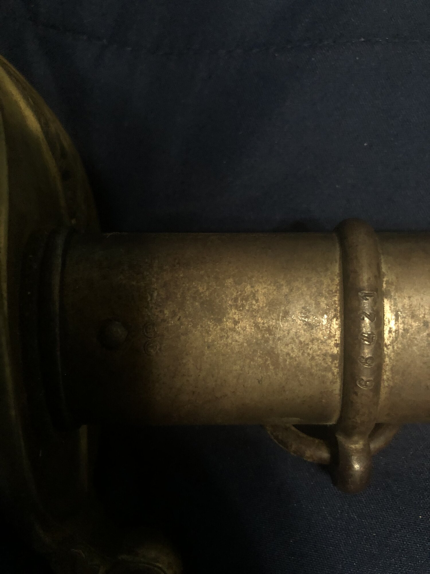

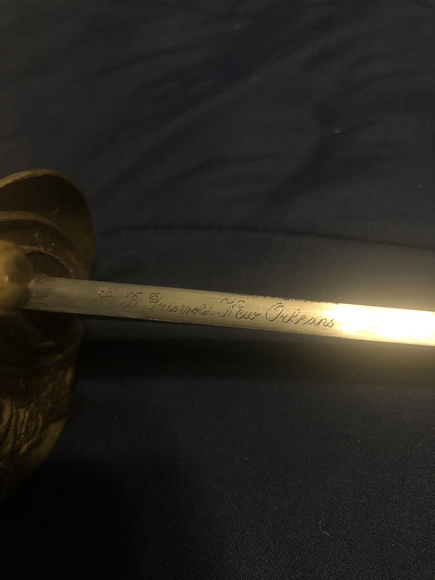

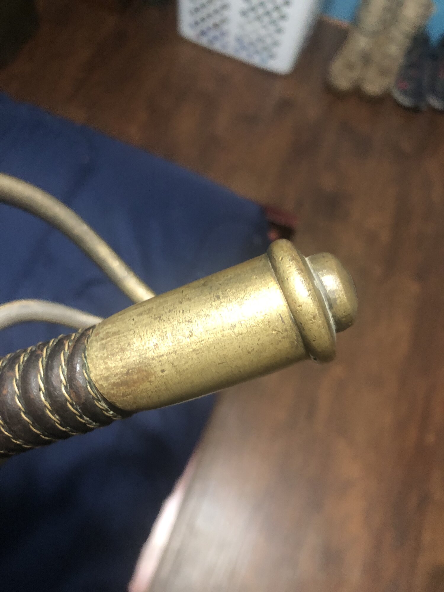

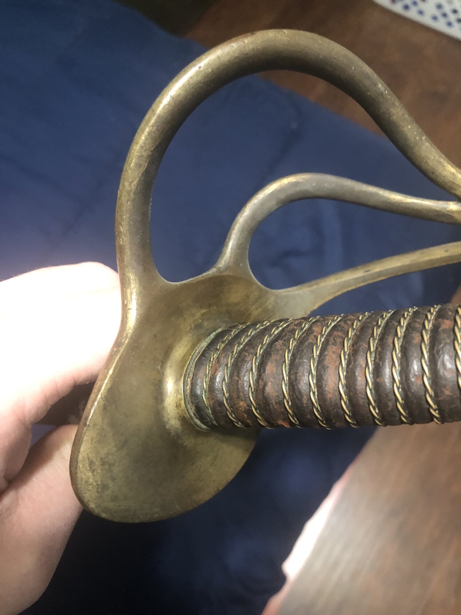

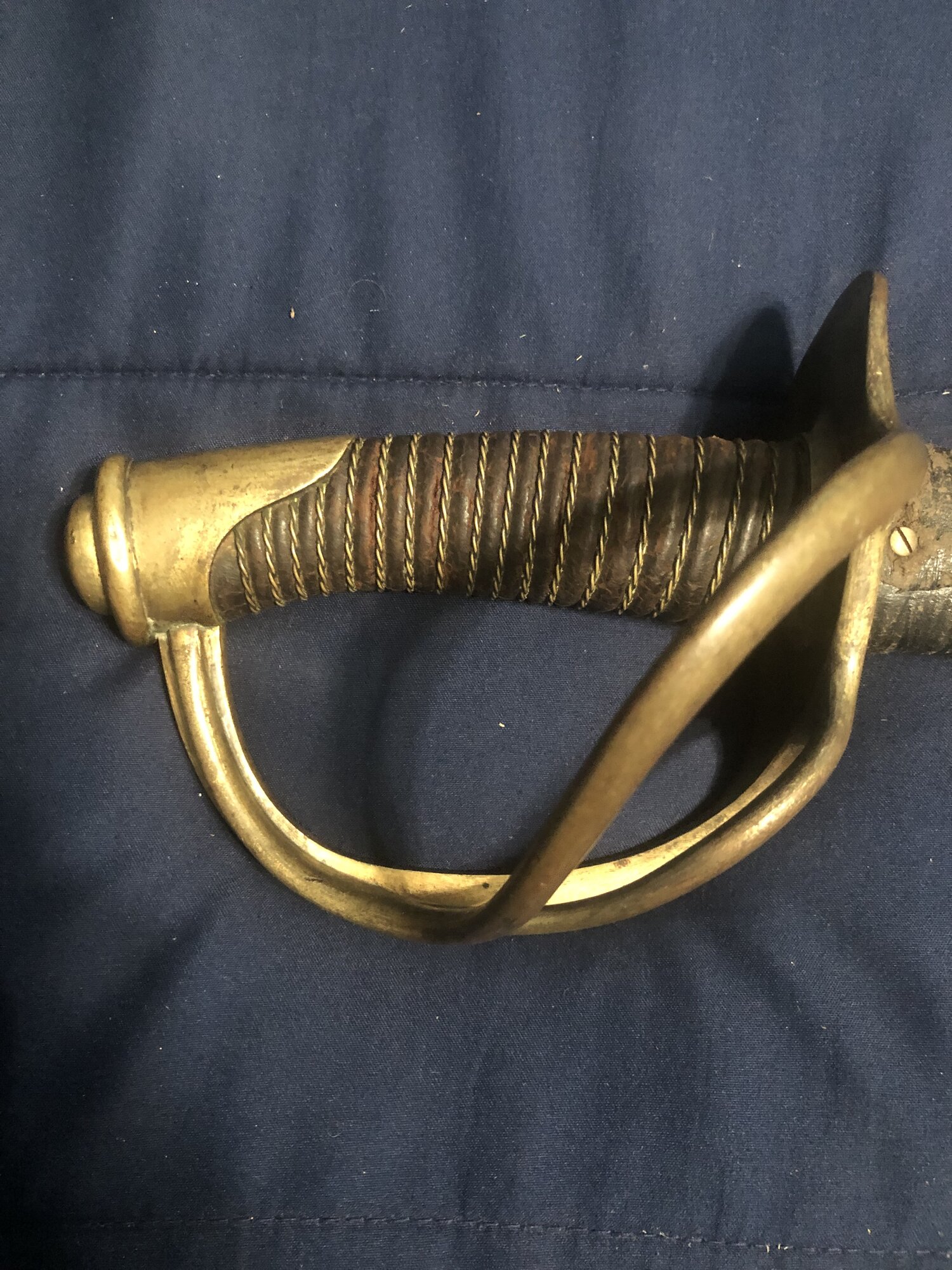

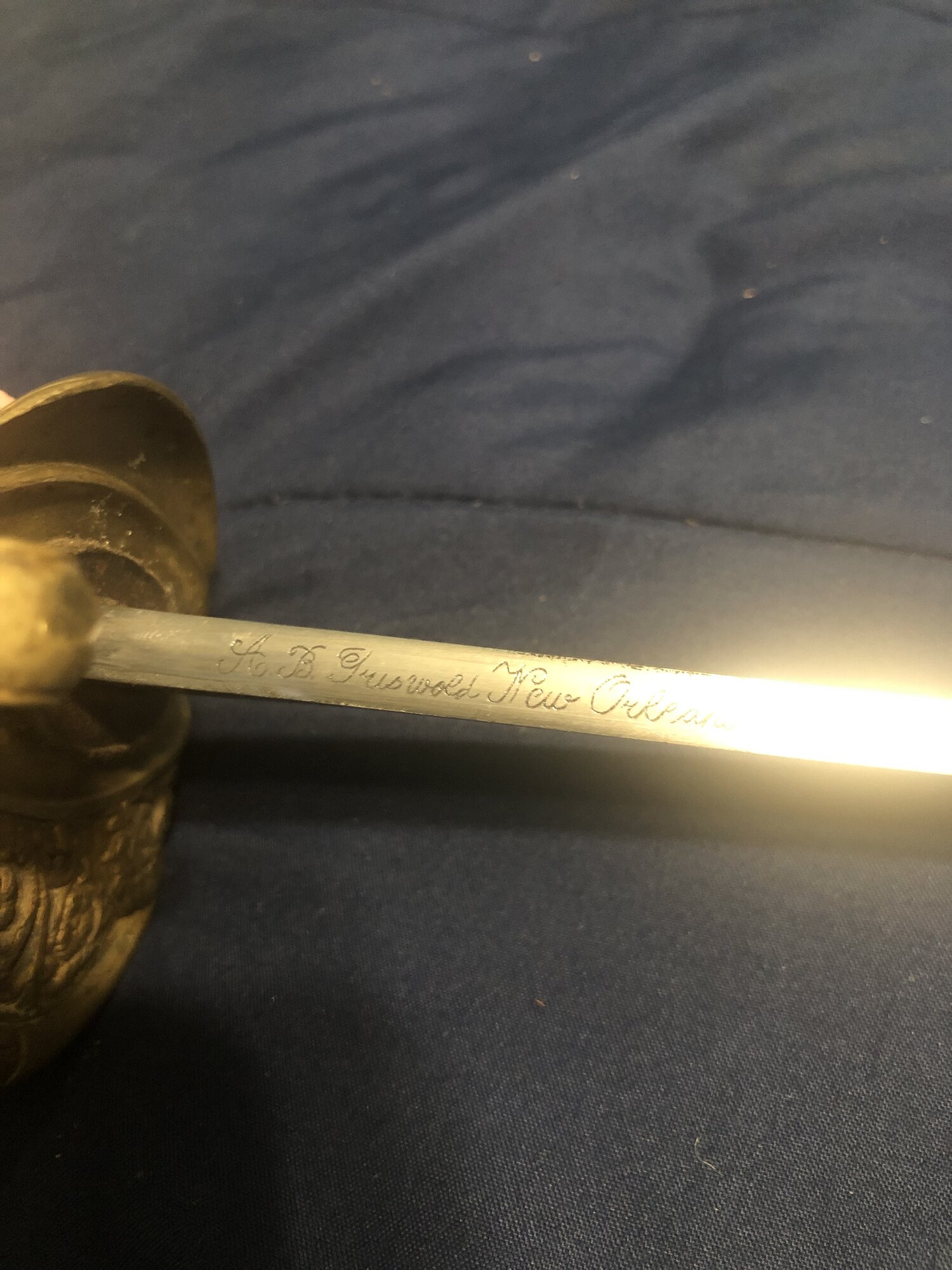

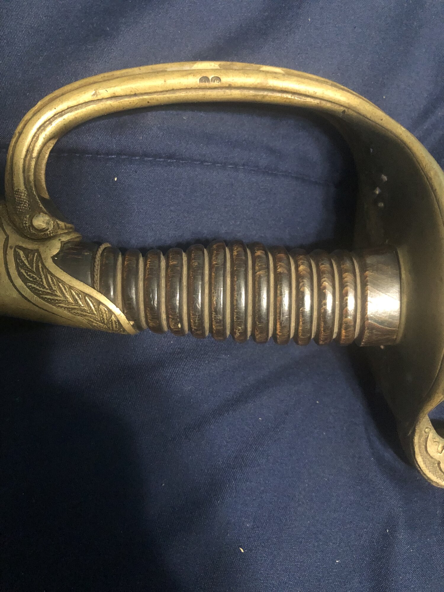

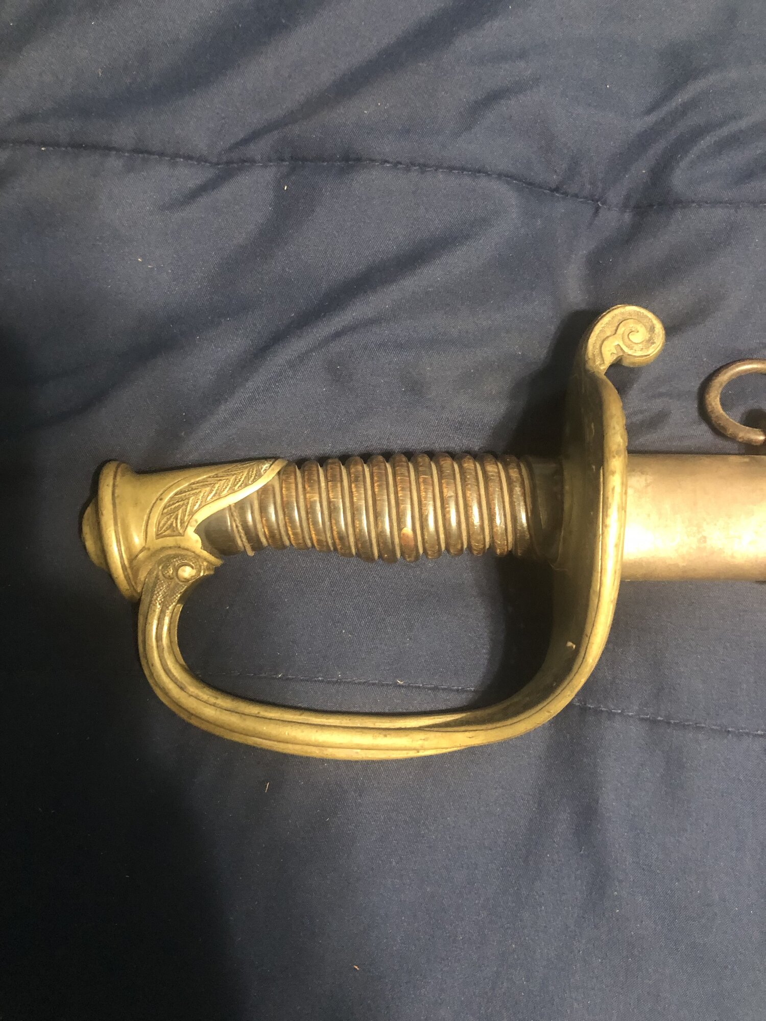

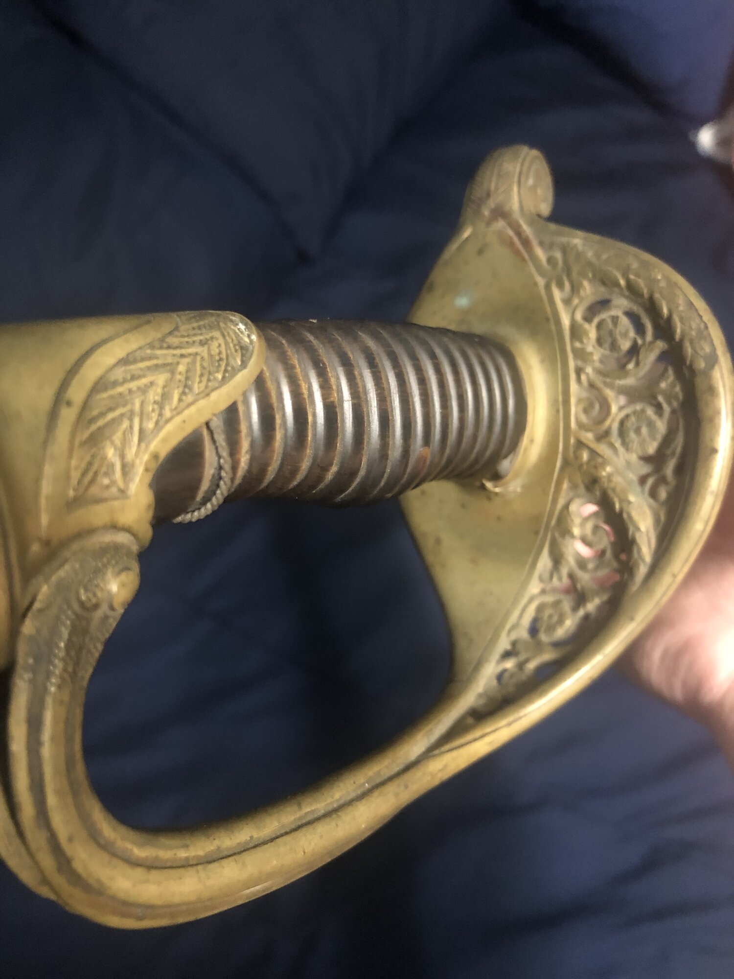

Hello everyone, I am new to civil war collecting, I recently acquired 2 sabers. However, I don't really know what model they are, or even if they are real. I was looking for any information anyone has by looking at the uploaded images to help me determine if they are real. Thank you for any and all input and I look forward to reading all the information, Thank you for your time.

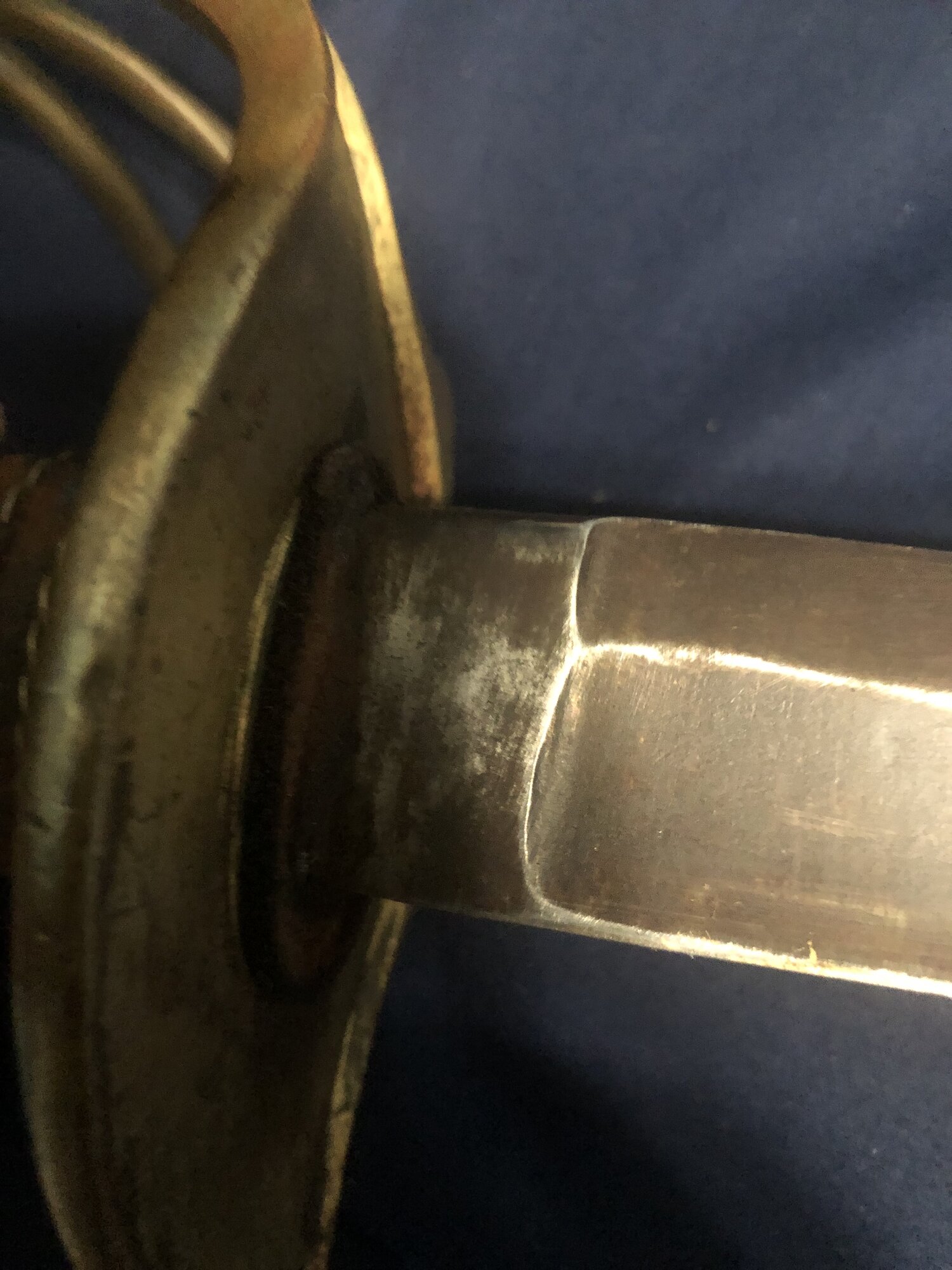

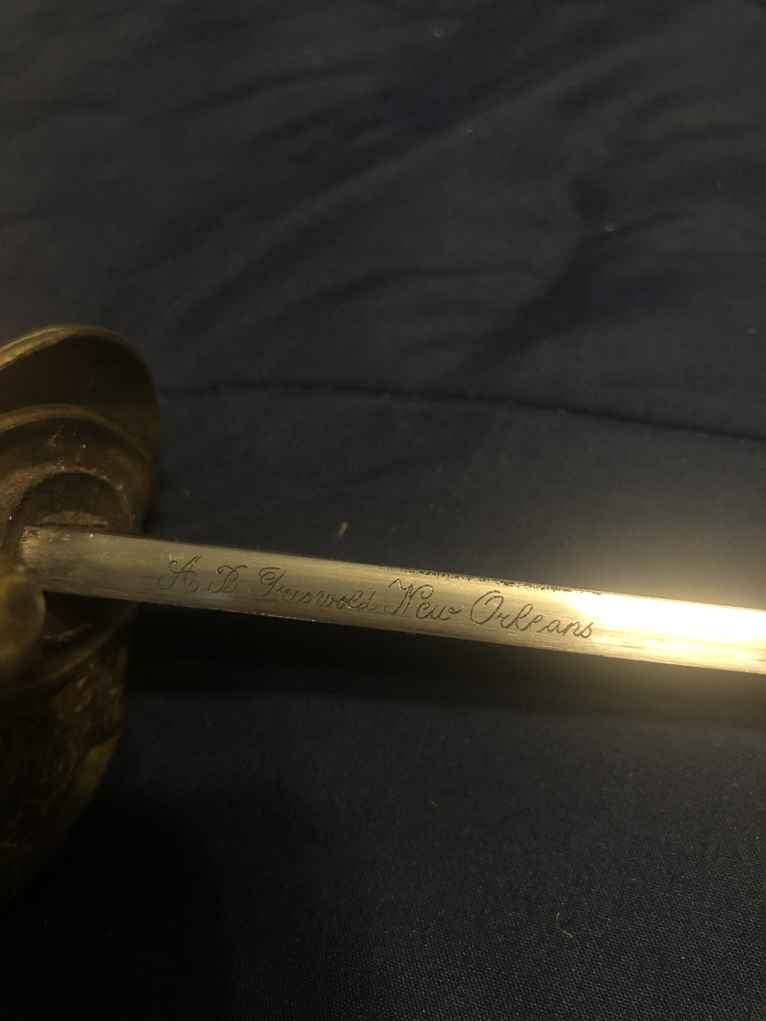

The swords are real, the markings on the spine of the blade are fake. Neither maker marked swords like that.
Unless there is US etching on the 2nd sword's blade, since it appears to have a horn grip it may be a French officer's sword that someone was trying to pass off as Confederate. The first style sword is also one that was used extensively in Europe, it also may have never seen the ACW unless there are some markings to prove otherwise.
If your new to ACW collecting I would say take them back to where you got them, get your money back, and start over again. Pay attention to posts on this site or buy some books on the subject, then go buy!

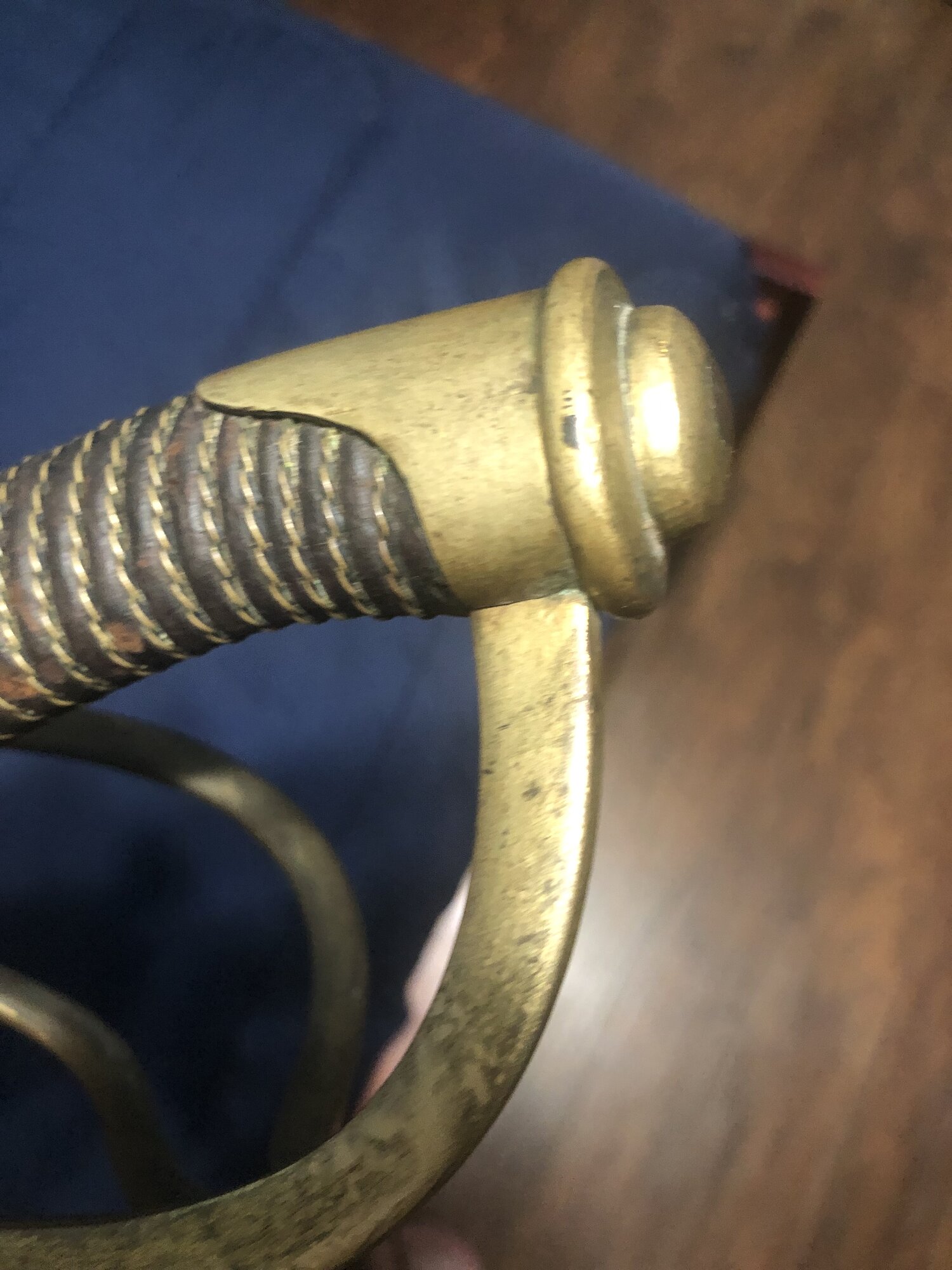

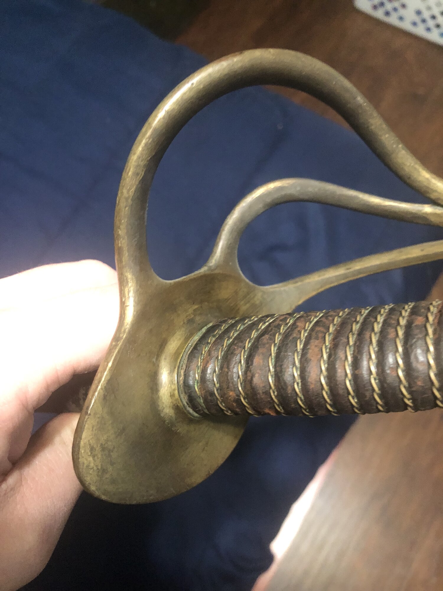

As said above, the engraving on both spines is fake. The first sword appears to be a model 1840 cavalry sword made in Germany. The grip appears to be wrapped with cord, covered by leather and then wrapped by wire as would a German import be. The wire used is not as tightly twisted as on many imported swords. The grip contour is of the model 1840 style. There are no inspection stamps on the hilt or blade which would be consistent with a foreign import. The bottom of the brass guard has a lip running around the edge. The screw holding the throat on the sides of the scabbard rather than the edges is also a German trait. This sword, except for the false markings on the spine, looks like a typical imported model 1840 cavalry sword that could have been used by either side.

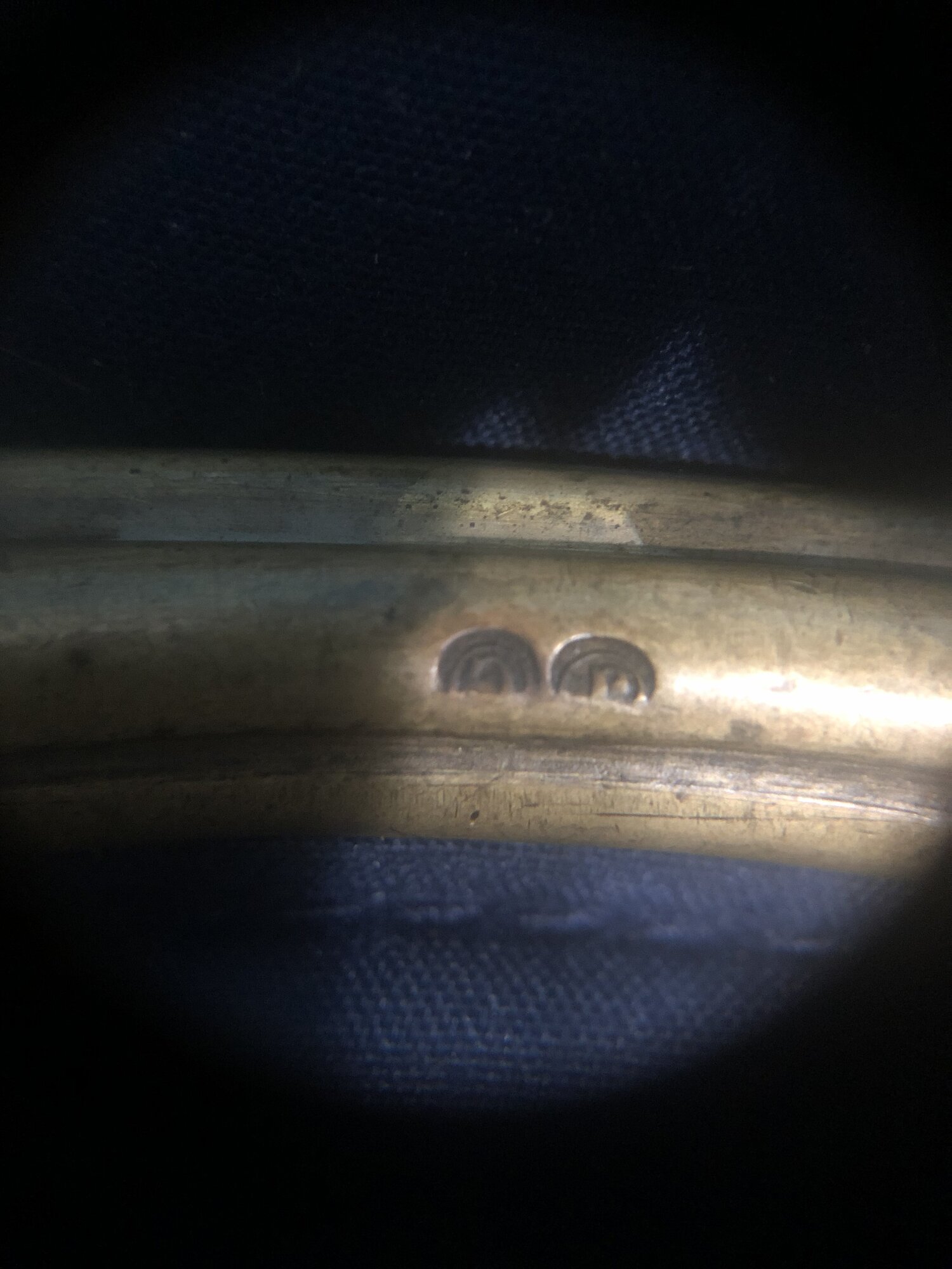

The officer's sword looks French. The horn grip makes it look French and the stamps on the blade and scabbard are French. Unfortunately the "C" within the raised circle is not earlier than about 1890. That suggests that the officer's sword is more likely associated with the First World War.
The false engravings on the spines of the blades greatly devalues the swords.
