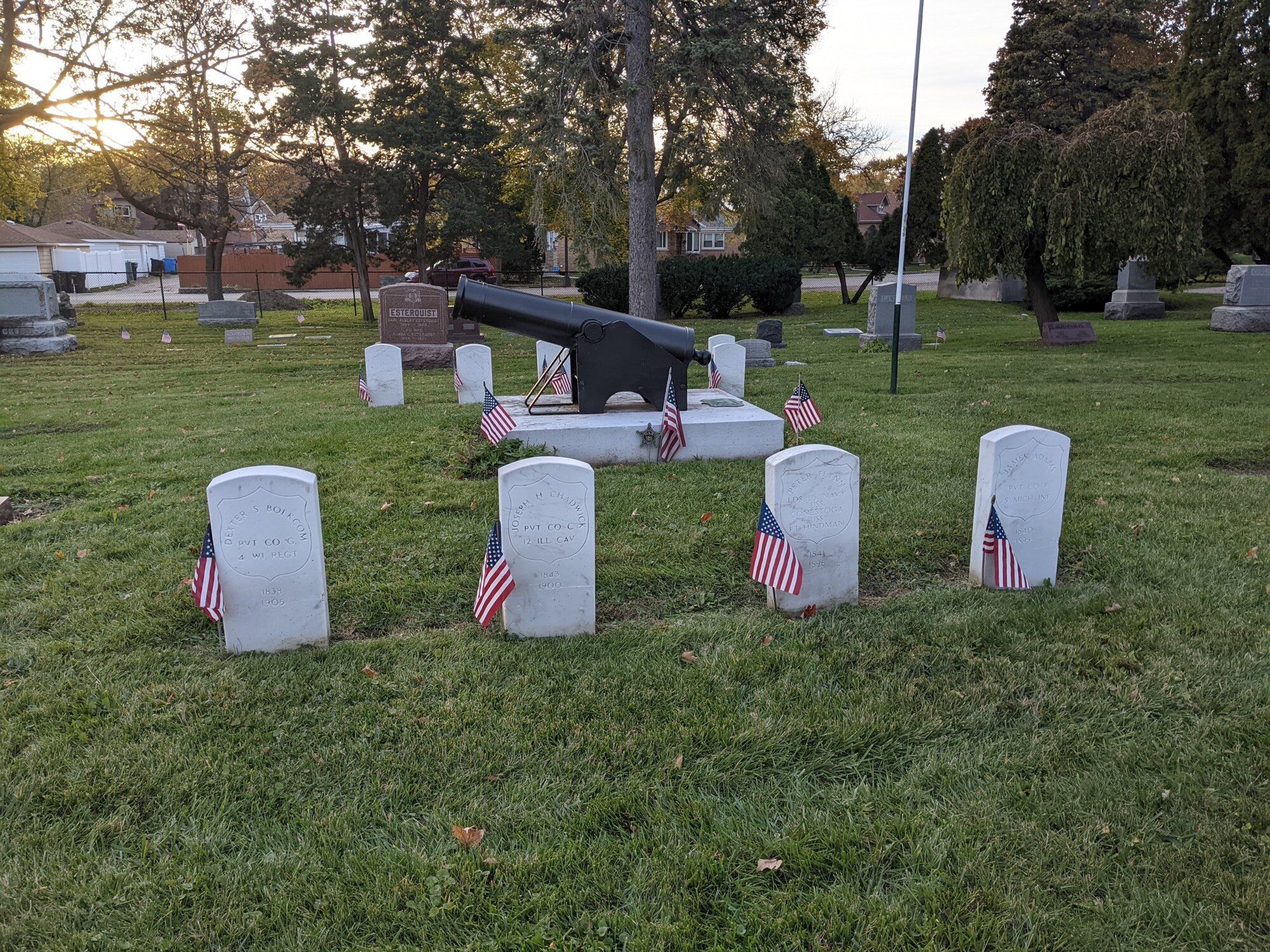

Knowing nothing about cannon, I am curious to know - is this real or fake?
From what I've read so far about the limited use of these cannon, I'm wondering if it could have been used at Camp Douglas POW camp in Chicago or if Illinois or Chicago had any defenses on Lake Michigan during the war. Going down the rabbit hole of speculation 😏 which is always fun and sometimes rewarding....
Thank you @Kurt G !
I have to admit I was expecting it to be fake. Don't quite see how it could be fired but will google 24 pounder flank howitzer 👍👍

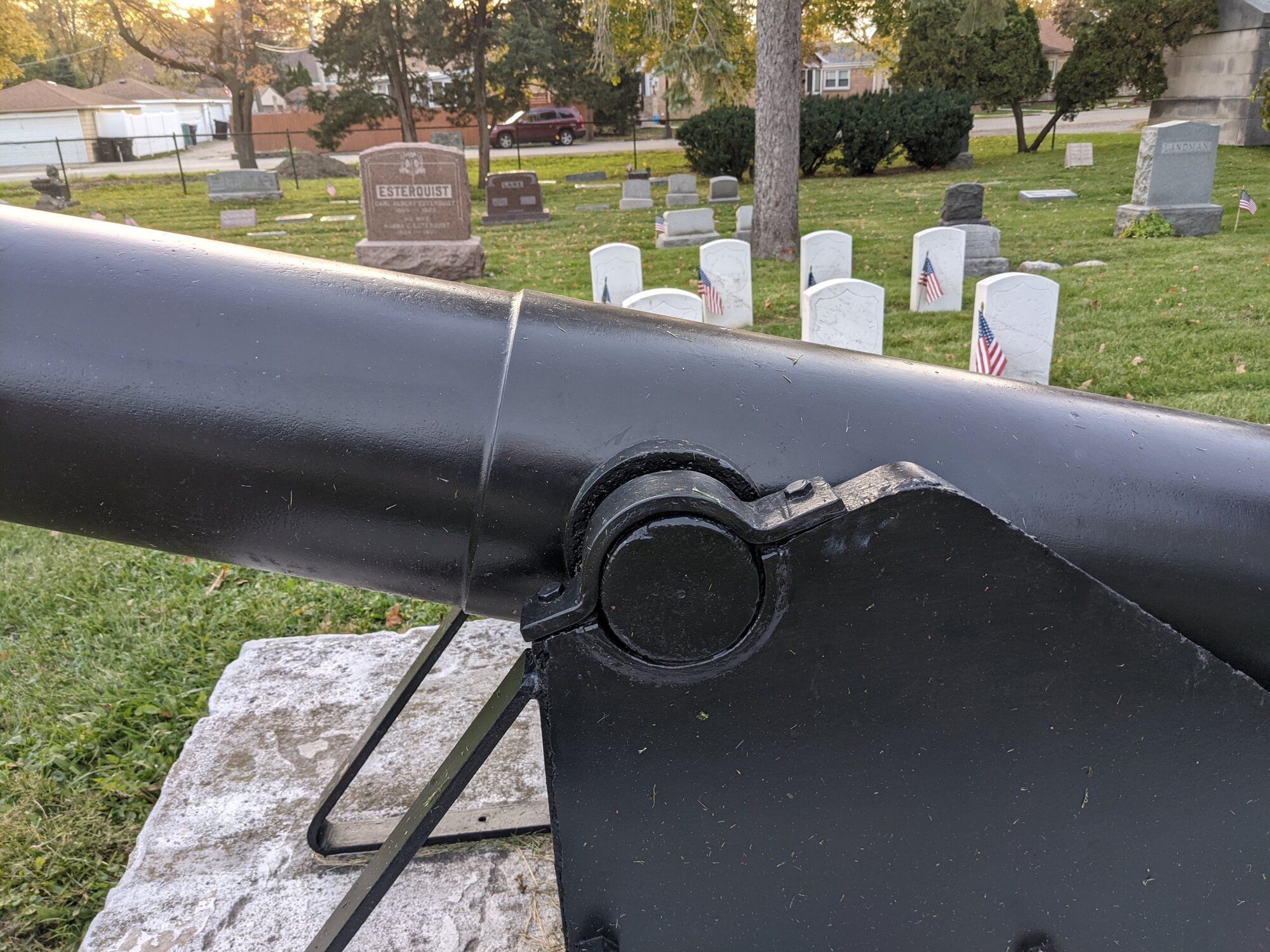

It is, of course, mounted just for display, and would never be fired from such a 'carriage.'

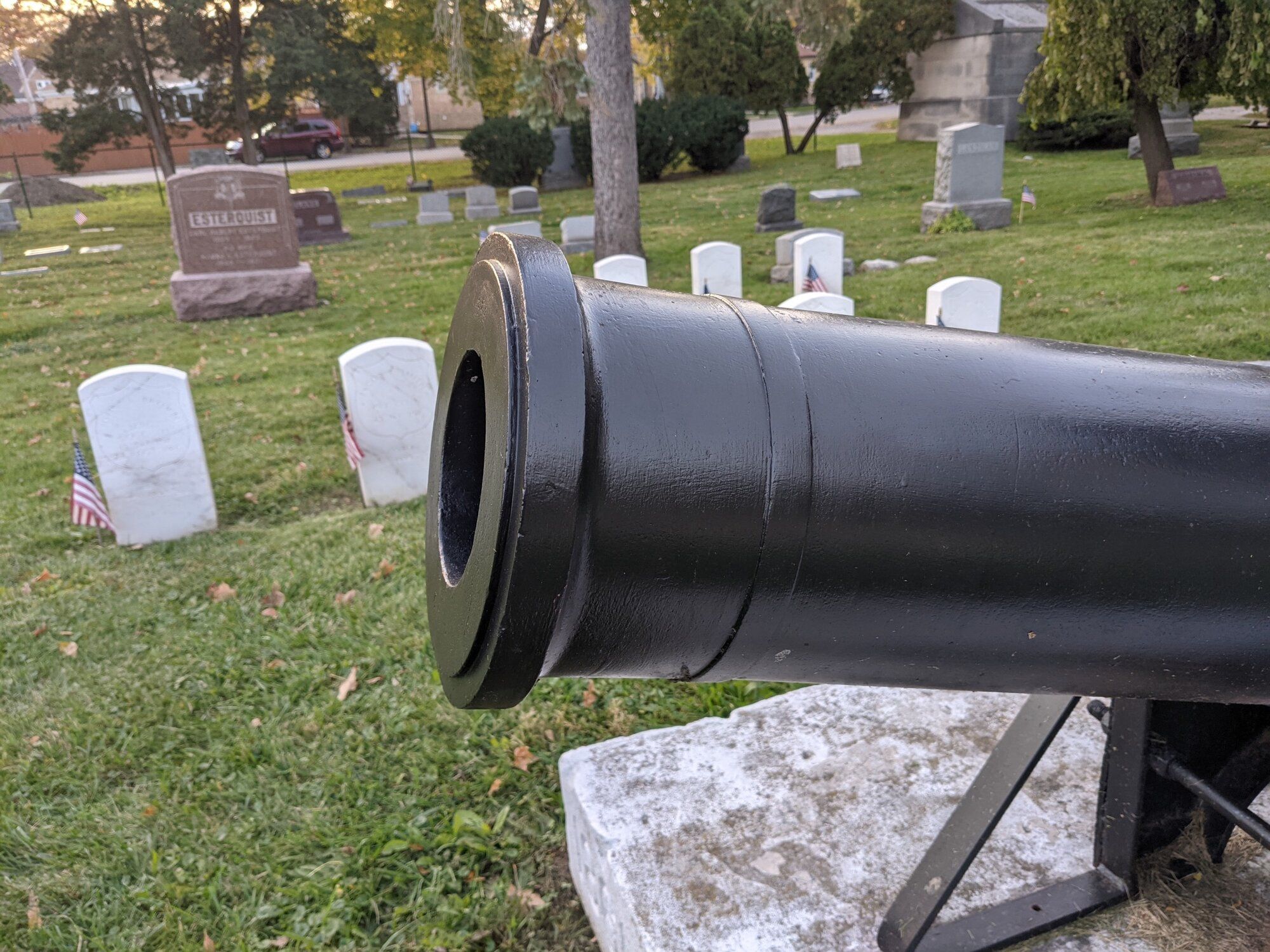

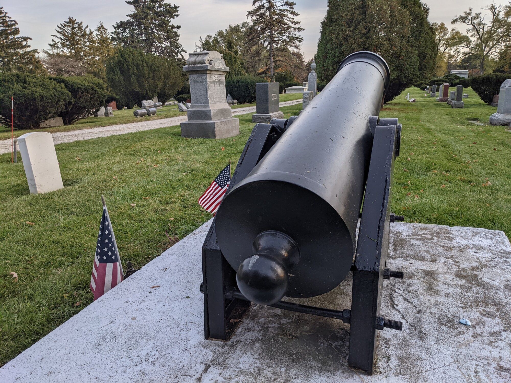

It also appears to have been mounted UPSIDE DOWN - note there appears to be NO touchhole or vent! This is not unknown in display guns: for example, we discovered the huge 13' mortar at Grand Gulf State Park in Mississippi is similarly displayed upside down on a "carriage" or mount that is nothing like it would've been mounted on originally.

Unlikely, because it was rare for pieces of ordnance to simply be left in place after the government abandoned the garrisons or positions. It was usual for them to be removed and placed in storage, though there WERE exceptions, as in the case of several 100-pounder Parrotts that were sealed up within Fort Sumter's lower casemates. Around the turn of the Twentieth Century after it was obvious that pieces like these were obsolete they were offered to communities for service in memorials, monuments, and cemeteries across the nation, no doubt how these got to where they are today.

The one from Northport is also mounted upside down . I wondered if they may have done this to prevent some one from trying to fire it .

Without a doubt, the information on a "Flank" howitzer has proven to be an elusive beast, however this is what I have found :
First off a "Flank" howitzer is an American outgrowth of the British custom of using carronades to protect casements in fixed fortifications.
The first American order (of three) for Flank howitzer(s) was placed with Cyrus Alger on 24 April 1845 for 100 24 pound iron field howitzers for flank defense.
By 28 July 1849, 300 cast iron flank howitzers had been manufactured by Alger (CA& Co.-Photo #8) and accepted by the US Government.
577 Flank Howitzers were eventually made by seven different manufacturers including the Tredegar Iron Works in Richmond.
Of these 577 manufactured, 258 survive.
A gunner and two cannoneers were needed to man the piece and with a load of 2 pounds of powder, they fired a 21 pound canister or a 17 pound shell containing a 12 oz. bursting charge.
The tube weight averaged 1,400 pounds.
This information came from the book The Big Guns by Olmstead, Stark and Tucker.
Same here, but I was waiting for the experts to reply.
As usual, they did not disappoint.
That explains much.
It does resemble a carronade more than a traditional howitzer of that era.
