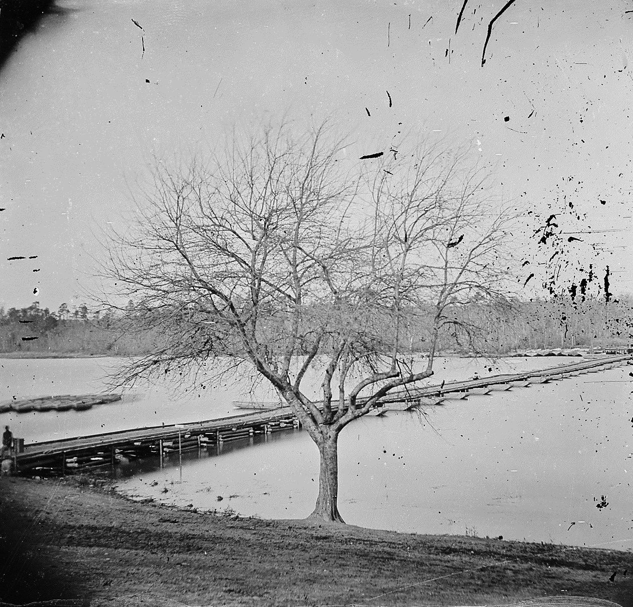

Some of these may be familiar to members here- some I've seen in other photos but not these shots. One of the pontoon over the James, where ships were used to counter the current, I'd come across ages ago but not in use. The one I found in our Archives has an entire wagon train making use of it, amazing.
LOVE pontoon bridges, don't ask me why, have since the first time one caught my interest. Perhaps it's the engineering part- can NOT imagine how difficult it would be to make one! Think about it- what amounts to boards over boats, perfectly lined up and constructed so that WAGONS pulled by mules, horses, the odd ox could get over the thing. Photos of wagon trains, artillery- over these boats with wood- roads over WATER, for Heaven's sake- crazy! Then, should one be in a river where current is an issue? Find entire SHIPS to apply tension, keep the whole snake in line. Crazier!
Yet we see them, large and small all through those years. some constructed under fire ( Fredericksburg ) some under massive pressure, a whole army's safety dependent on one, some the single connection after civilian bridges were destroyed in acts of war. Hopefully the only photos here are ones not posted yet but if so, please excuse. They could use a second look anyway.

Pontoon landing, think it's also the James?
Untitled because I'd be guessing......... looks permanent, maybe part of the Potomac somewhere?

Great photos.....those boats are well engineered so the least possible force from the current is applied at the upstream end. There are only four major components to the bridge....the boats, the stringers/beams that span the gaps between boats, the boards for the roadbed and the railings, that presumably help hold the roadbed boards in place. I'm willing to bet that the boats fit perfectly in a standard wagon. Would have loved to see one of these as it was laid down.
The pontons on a French style bridge train actually become a part of the wagon and store/ carry the materials. The collapsible Russian style canvas pontoons folded so their specially designed wagons could carry maximum load.
