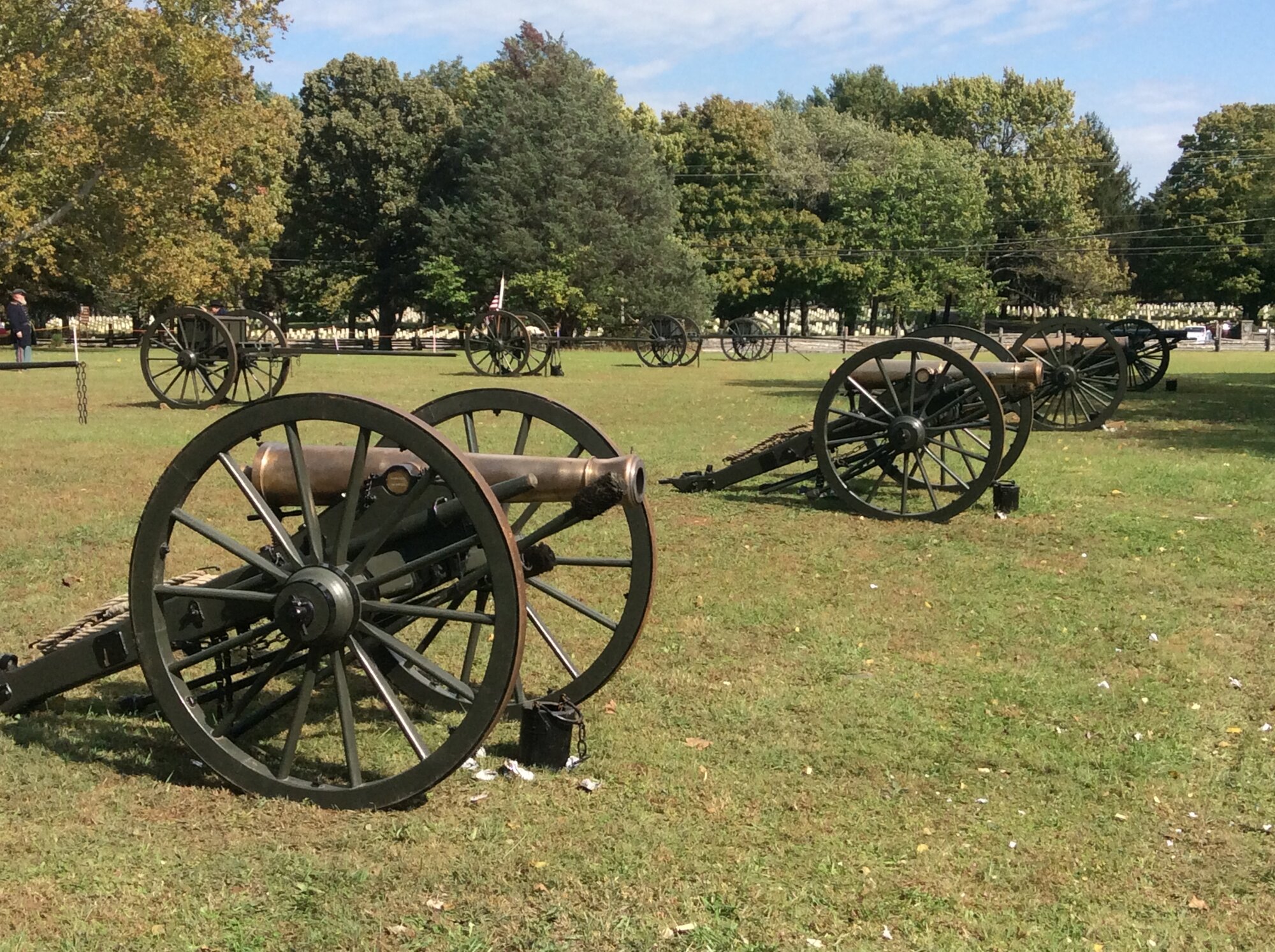

At Stones River we have a section of bronze 1841 six pounders. A special needs class from a local high school shines them to a mirror gloss.
That early in the war, they were still polishing bronze guns. On humid summer days the mirror polished 1841 cannon & howitzers give off a golden haze. The atmosphere glows twenty feet into the air, white tents are gilded. It is really quite an effect…
…It was, of course, the equivalent of launching balloons holding a banner declaring, "Here I Am Please Kill Me."
Given the mania for polishing everything in sight that lurks in the military mind, sergeants must have wept openly when they were ordered to let the bronze oxidize.

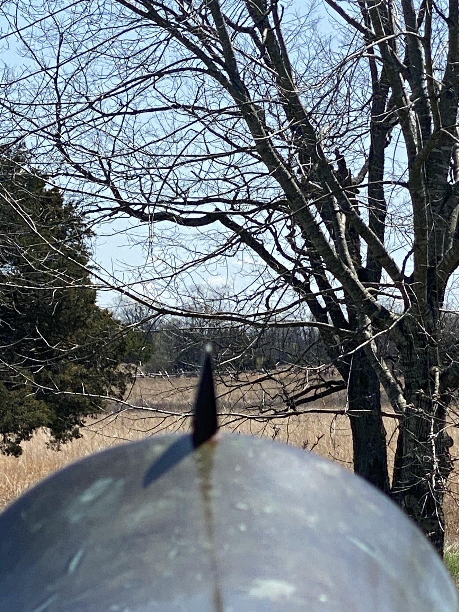

It is blinding to stand next to them during drill, no kidding, squinting down the barrel is down right painful. Note the reflection of the front blade sight.
