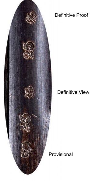

The butt plate fit is always debatable since much time - and effort - has been expended on the wood - the most likely part of the rifle to be on the ground. I have one Liege example where the butt is considerably shorter than the standard with the badly distorted plate rarely flush with the wood. It may well have been shortened to fit! If it is of British origin, it will have civilian proof marks on the barrel to the left of the breech like this:
That shows the barrel at least was proofed before leaving the factory. No military P53 has these unless is was 'sold out of service'. Belgian made barrels and rifles have different proof marks. If no British barrels were available, they would occasionally use imported Belgian ones assembled to a British stock and lock in Birmingham. Quite often, the makers name is on the top of the barrel too.
Your P-53 RIFLE musket was probably Birmingham made {5 proof stamps on the left side of the barrel breech, as posted above}, and the 2 names you found were members of the very large gun making community there. Confederate rifles {I have more than a "few"} do not have {"typically"} butt plates that overhang {to protect the wood from damage}. There are no marks on your P-53 making it Confederate.

Like this...? Just didn't know what these meant.

The 24 means it was a .58 cal so not a CS import and the butt plate think is not even close.
