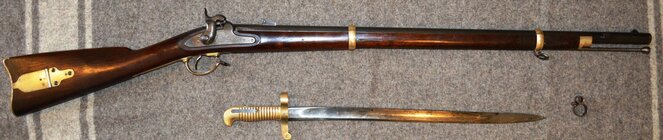

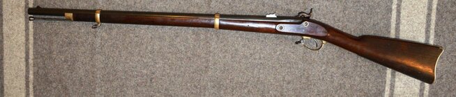

Hallo!
Another pieces from my collection, it's a Zouave 7 groove barrell, but the lockplate it's different from the ones I've always seen (in Italy); they are usually marked this way:
"REMINGTON'S <over> "ILION N.Y." To the left is an eagle symbol <over> "U.S."
My lockplate it's correct?
I was wondering if someone could identify, Thanks!
my lock plate:

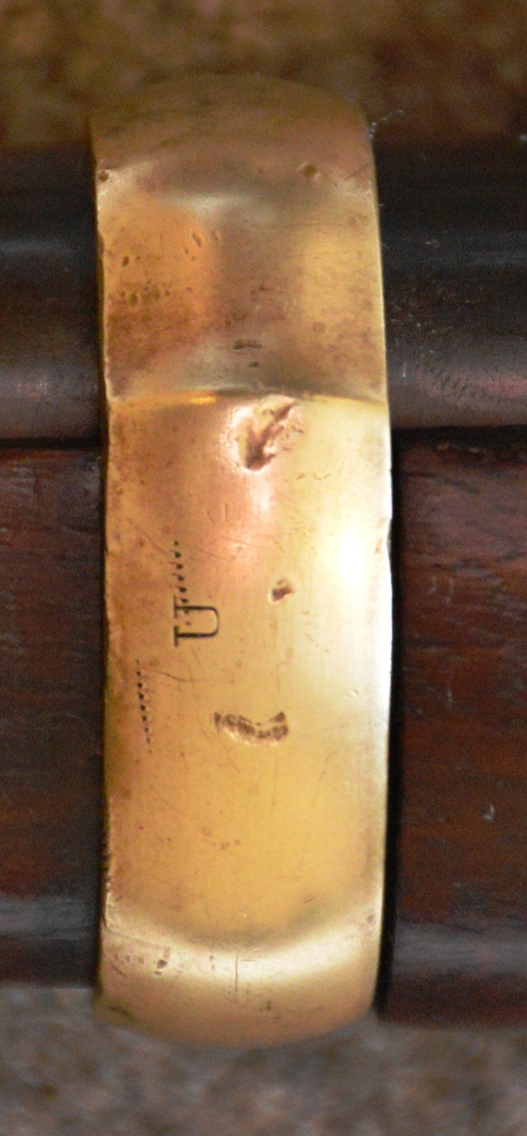

B.H. on the bayonet: inspector?
what does it mean G.P. under V.P ?

Most of the Zouave's Ive seen had a barrel mark as the one below. What you may have is a Remington sub-contract musket. The BH is for Benjamin Hannis, who inspected many different weapons for the US.
