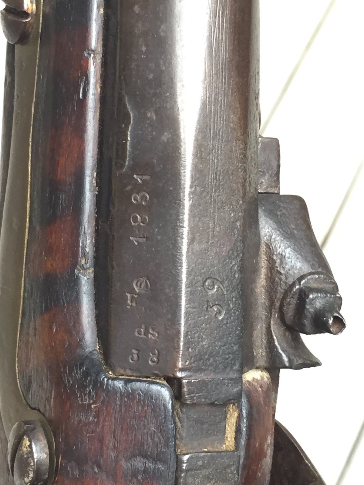

I think that your carbine started out as a Muster 1809 Prussian, flintlock, smoothbore, infantry musket manufactured at the arsenal in Suhl in 1831. At some point, it was the 59th musket assigned to the [8th Company?], 19th Prussian Infantry Regiment. It was subsequently converted to percussion ignition as a M1809/39 UM musket. Large numbers of the M1809/39 UM Prussian muskets were imported to America during the Civil War, and were used by both the Federal and Confederate Armies. At some point, your musket was further transformed by being shortened to carbine length [two barrel bands vice its original three band configuration] and its rear sight was removed. Whether this was done by the Confederates for issue to a cavalry trooper, or done post-war to make it into a fowling piece, I don't know.

Am curious in the first photo does anyone recognize the marking stamp in front of the hammer, above the faded lettering?

After reading your posts I took even bigger interest in the rifle. As for „tiger lines”: to me they seem to be wood texture. Gilding though I’m not sure - I can see leftover in the area of lock. I understand from what you’re saying that it’s impossible to examine whether the arms could have been used during civil war. In my opinion, if „19 IR 59. 8C” meens 19th prussian infantry regiment, 59th rifle, 8th Company” than 8C should be written as 8K (from german - not Companie but Kompanie). Is it possible that this sign is connected with Union or Confederate army?
The Federal and Confederate Armies didn't mark shoulder arms with unit markings, while the Germanic armies generally did, which takes me back to the Prussian Army. But, I understand your point about "C" vice "K", which is why I put a question mark after my comment.
