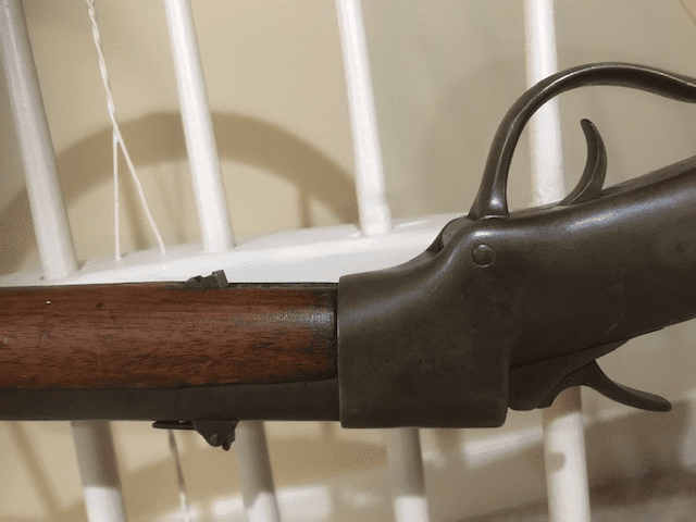

I just became the new owner of what I've come to learn is called an Old Model Ballard carbine. It's in really good shape mechanically and the only thing I think is replaced is the extractor knob. But that seems to have been done long ago. Sadly the receiver patent and address info was scrubbed at some point to make it more readable I guess. It's been difficult researching this piece as there is some conflicting info. Some of the best online sources of info I could find were from auction houses - Morphys and College Hill, etc. But I've also got a copy of Glickman's "US Muskets, Rifles, and Carbines" but since it's a bit dated I'm not sure if there's newer research that the online sellers have used. Anyway, my confusion is to caliber. It's a "54 Ballard" carbine which I've read is the same as 56-56 Spencer. And it seems 56-56 Spencer had a range of actual caliber sizes. My 56-52 Spencer round (I don't have a 56-56) is swallowed up by the carbine's muzzle. A 54 Burnside bullet goes in up to the lube grooves. So my 54 Ballard must be somewhere in the middle. It measures just over .54" on the micrometer. Does anyone know what a 54 Ballard actually measures at and what might be comparable? Or has anyone seen an antique cartridge around for sale?
Also, confusion surrounding the actual contracting and use of these. The Old Model name seems to be used (per Glickman) since these were the first Ballard carbines made then later on they started producing the more common 44. But online I've seen that the 54 was a 'side order' as it were where all carbines made in that caliber - between 2 contractors - were sent to Kentucky. So my second question is, which is it? And were all 54 Ballards used by the Kentucky state militia?
Attached are some photos and a couple next to my 44 Ballard. Interesting that the 44 has a half octagonal/half round barrel and the 54 has an all round barrel and receiver.

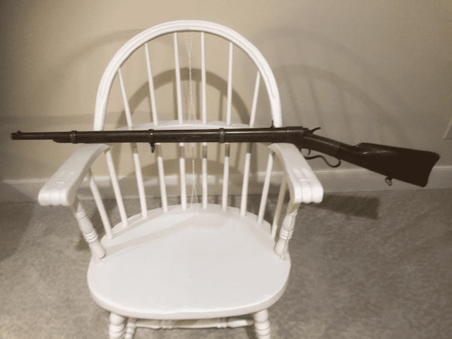

I am a first time participant on the forum,and hail from Alberta,Canada. [+28C and sunny] I recently acquired a Ballard rifle and am trying to learn more about this firearm. Reading posts here and elsewhere has been very interesting and helpful . The serial number is 10761. It has 'Kentucky" stamped on the barrel in front of the breech. It is 45.25" overall with a 30' full round barrel. The markings are for the most part worn off,but on the left side there remains"...…..is " and below that "...….Mass." On the Right side is "Ball..... " and below that is "Nov,1 1[8][6]1 I can't really determine the two middle digits. From the info if read it seems that it could be a .44 [or .46] cal . The gun is missing the ejector knob and screw and also the "u" shaped piece of metal directly under the ejector knob. Other than that, the overall condition is very good . I am hopeing someone can enlighten me on positive identification of it and possibly a source for the missing parts . Looking forward to any info and comments. Happy Day!!! Jersey
"Jersey Cadet" Welcome, enjoy. I own 10406 which I put about July, 1864. .46 RF Ball & Williams. Part of the 2nd Kentucky order of 3000. The 1st order was 1000 at .44RF. Is it full stock like mine? Parts are not easy to find. I have been searching for the ejector frame without any luck. You can try S & S on Long Island, NY. Lodgewood and Gunderson. Never know

Hello John Thanks for the info. Mine also is fully wooded . If my limited technical skills prevail, there will be some photos of my rifle. Based on what you have said re the date/man. mine probably was cranked out later[355 later] in 1864!! I have crafted some parts for some other firearms I own and will probably make the piece under the ejector if I am unable to locate an original replacement part...….also the knob. I have determined the thread on the ejector is the same as the bolt on the buttstock and the breech. Makes it easier if I need to have a thread cut/bolt made. I'm not sure which knob configuration is the correct one, what is on yours? I'll contact the Co. you suggest and see what transpires. Regards Jersey
