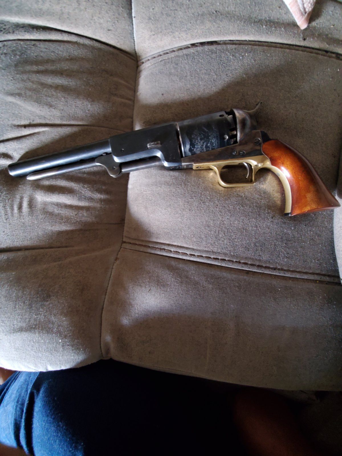

My first purchase for my first reenactment
Says made in Italy on top of the barrel... 1847 us on the side
The "1847 US" stamping on the barrel lug was present on both the original Colt Walkers and modern replicas. If there are no proof marks or date code present on the frame, most likely it was created from a CVA kit. Italian law only requires those on completely assembled revolvers, not kit guns.
This is what ASM frame stampings look like. Arrow at left is the ASM logo, arrow at right is the date code. Proof marks are there, also.

$125 is an excellent price. The 'CVA', if there, will be in a circle a bit smaller than a dime on the right side of the frame between the grip & the rear of the trigger guard .

If the maker was Armi San Marco, the right side of the barrel will be marked SM or ASM at the beginning of the logo. The bottom of the frame where it meets the barrel lug will have a stylized ASM in the form of an equilateral triangle above the serial #. The date code will either be 2 alpha characters in a rectangle above the serial# or in Roman numerals on the right side of the frame. All markings are normally stamped very lightly. That would be the good deal revolver, but ASM folded in 2002 and parts are scarce as hens' teeth.
