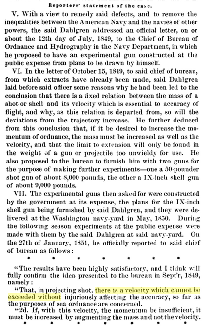

Having searched on this phrase, I find it mentioned in the 1870 court case around his death.
I will point out here that the (VI) summary of the letter states that there is a fixed relation between the mass of a shot or shell and its velocity which is essential to accuracy of flight was Dahlgren's position.
This seems to suggest (to my reading at least) that in the 1849 letter he's not actually talking about a specific and invariant "everything goes wrong" velocity which is constant across gun calibres. Instead the velocity varies with the mass of the ball.
In his 1851 report he does indeed state that there's a velocity that you can't exceed (and that you should increase the mass, not the velocity) but without more information it's actually quite hard to tell what velocity he's talking about. Given the focus in his work on bouncing the cannonballs across the water, I wondered briefly if it could be related to skipping the ball across the water, but he prescribes shell (not shot) on the next page:

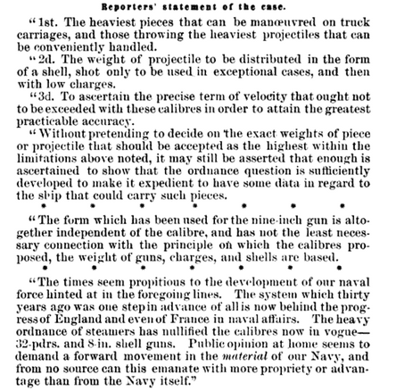

And he talks about the precise velocity that would give the greatest practicable accuracy.
I have to admit, I'm at a loss as to the effect Dahlgren could be talking about here - if you're willing to put in the rounds to establish range for a given muzzle velocity (and he was, he fired one experimental gun over 1,000 times until it burst) then everything about the behaviour of a smoothbore should be completely predictable except for the last-bounce and corresponding Magnus effect, plus the wind.
In Shells and Shell-Guns, Dahlgren states (as a rule) that "Accuracy is derivable from the uniformity of axial motion, inevitably incidental to all military projectiles of whatever shape, and the configuration of the trajectory". In the following section he talks about how the Lancaster gun, because of having a smaller muzzle velocity than a smoothbore of similar diameter (because it's heavier and has a smaller charge) would have to be fired at a higher trajectory *and that would make it less accurate*.
He also says that "(so far as) the relative accuracy of the two projectiles depends on the directness of the trajectory, the round ball will have the advantage at the lower elevations, the elongated at the higher". So a flatter trajectory for the same range is an advantage.
He repeatedly specifies in Shells and Shell-Guns that a flatter trajectory is an advantage.
If we could locate the report from September/October 1849 we'd be able to actually tell what he's talking about. I can't find any mention of the effect in Shells and Shell-Guns itself, so it's at least possible that it was a theory he'd dropped by the time he wrote the book - that or he didn't feel it worth putting it in, though it contains just about everything else.

Yes, that's what I'm saying. I'm saying that (in my hypothesis), Dahlgren had a formula which did not work at high initial velocities, but which did work at low initial velocities.
First, that is what I have been telling you for months. The ballistic formula for a projectile fired above the speed of sound is not the same as the one for a projectile fired below the speed of sound. Dahlgren is clearly saying that there is something about higher velocity that makes the shot inaccurate in his 1849 report and the 1850 letter. He knew nothing about the "sound barrier", but he knew there was an unexplained problem before him.
Second, the task Dahlgren is working on when he wrote that September 1849 report is the test firing of the USN 1845 standard ordnance: all six types of 32 pounders and the new 8 inch shell guns. His results led him to conclude that the heavier 32-lbers lacked accuracy while the lighter 32-lbers lacked power. He is proposing the development of a new gun to simplify all this, a heavier gun that can fire shell and shot (which would also simplify a logistical mess).
As part of his testing, Dahlgren is plotting the fall of shot and the trajectories to the best of his ability. He is not trying to match the shots to a pre-existing formula, AFAIK -- but he would certainly be trying to make sense of inconsistent results. He is working from the data, not trying to make the data match a theoretical construct.
In November 1849, Dahlgren was almost killed when a 32-lber being tested had a breech explosion. A little after that, he got permission to design his proposed new gun (the IX inch). His design was submitted in January 1850. His design was based on the concept in the 1849 report, mentioned in the 1850 letter.
That is not what I was trying to say.
I was trying to say that Dahlgren (in my hypothesis, which is a hypothesis and not confirmed) had a formula into which the inputs were "muzzle velocity" and "elevation" and for which the output was "range", and which worked except at high velocities.
What I've been trying to understand, or trying to get you to explain, is this.
If we start with an empirical set of values forming a range table for a muzzle velocity of 1,400 feet per second, or higher, then in what way would the firing of a cannon at 1,400 feet per second deviate from that table?
If it doesn't, then doesn't that mean that the gun is actually accurate?
You yourself said that the definition of inaccuracy was:
My use of the word "inaccuracy" is this: the shot will be less likely to hit where the gunner believes it will.
But if the gunner has a range table for a cannon at 1,400 feet per second, the gunner has all the information he needs to believe correctly where the projectile will land, right?
The only ways I can reconcile what I know about the physics with Dahlgren's statements consist of the following.
1) There is some physical effect which means that a high velocity projectile deviates from an empirical range table, in a way that a low velocity projectile does not. In this case the high velocity projectile would indeed be inaccurate because no range table could capture its behaviour, but I do not know what that physical effect could be.
In this case, Dahlgren would be correct, but I do not see what the physical mechanism could be. It is not the higher drag coefficient because that is predictable and consistent between firings.
2) Dahlgren's statements in his late 1840s and early 1850s letters refer to his tests not matching up with the range table he has determined (in some way, possibly through calculation) and he has concluded (at the time, though perhaps not by the time he wrote Shells and Shell-Guns) that this is the projectile being inaccurate.
In this case, Dahlgren would be observing the effects of the higher drag coeffiicent. He would, however, not be correct in claiming that it was impossible for a high velocity projectile to be accurate, because all that is required is a better range table.
Now, in the 1855 treatise which I read and quoted from extensively, this inaccuracy-at-high-velocity effect does not get mentioned and instead the principle that higher accuracy is obtained from higher velocity is reiterated over and over. The treatise does mention that the resistance of the air to the projectile increases markedly at high velocities, in a specific way.
This tends to reinforce my sense that (2) is the correct situation, though I am of course open to what the physical effect could be that causes (1).
