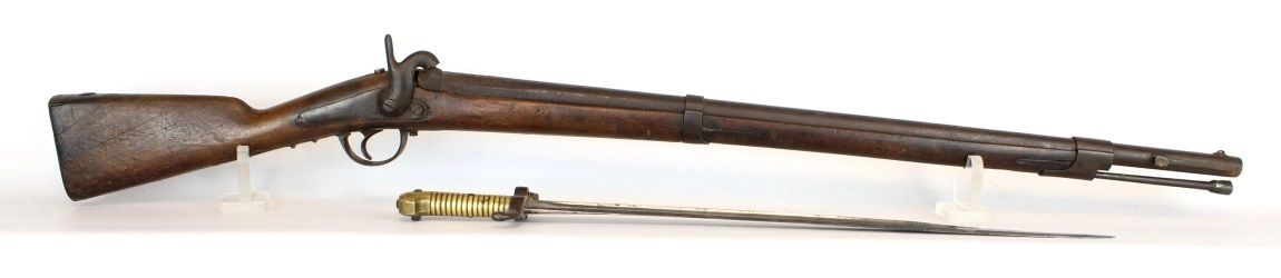

That seems to be the case, as far as the hybrid construction method of the german mfg Enfield style, yet the French brass grip, and the belgian crossbar,, and according to Tim Prince, it would be for an 1859 Pondir rifle, which in itself was a french/english/belgian hybrid rifle based on an 1842 french, a 2 band Enfield, yet mfg in belgian. Pondirs were known to have NJ surcharges, which fits why this bayonet has them as well.
Another one to add to the list! Also called the m1859 'Carabine de Vincennes' Rifle and appears in a number of older threads on this site.

I will admit to copying and pasting, but is there a better site to find out from? More research reveals these were OHIO regiments and, luckily, Ohio kept detailed records of types and issues.

Only 3,241 of these guns were imported and it seems most of them were sent here and reissued a number of times since the numbers here add up to 4,870!
More info: from: https://civilwarguns.blogspot.com/2015/04/rifle-muskets-civil-war-scandals-civil-war-guns.html
Case No. 2. John Pondir, Philadelphia.
He contracted to furnish 10,000 Light Minie Rifles with saber bayonets, at $18.50 each, July 26, 1861. The rifles were described by Pondir as These are the beautiful Minie, which ... are at the low price of $18.50. They are a light .58 or .577 French pattern arm, of the Chasseurs de Vincennes style, back action lock, brass trim, made for Pondir under an order he placed at Liege. Barrels are blacked; long range rear sight, weight about 7#, barrel 32V4". The fabricant of these arms is unknown. Deliveries by Pondir on February 3, 19, 20, 27, March 6, and 11, totalled 2,288 arms.
The Commission recommended he be allowed to deliver the full 10,000.
Awesome finds! I wonder how many ended up in New Jersey as well? There is one shown on a previous older post and it has a New Jersey surcharge like my bayonet does, but I can't find any info on NJ issuances.
