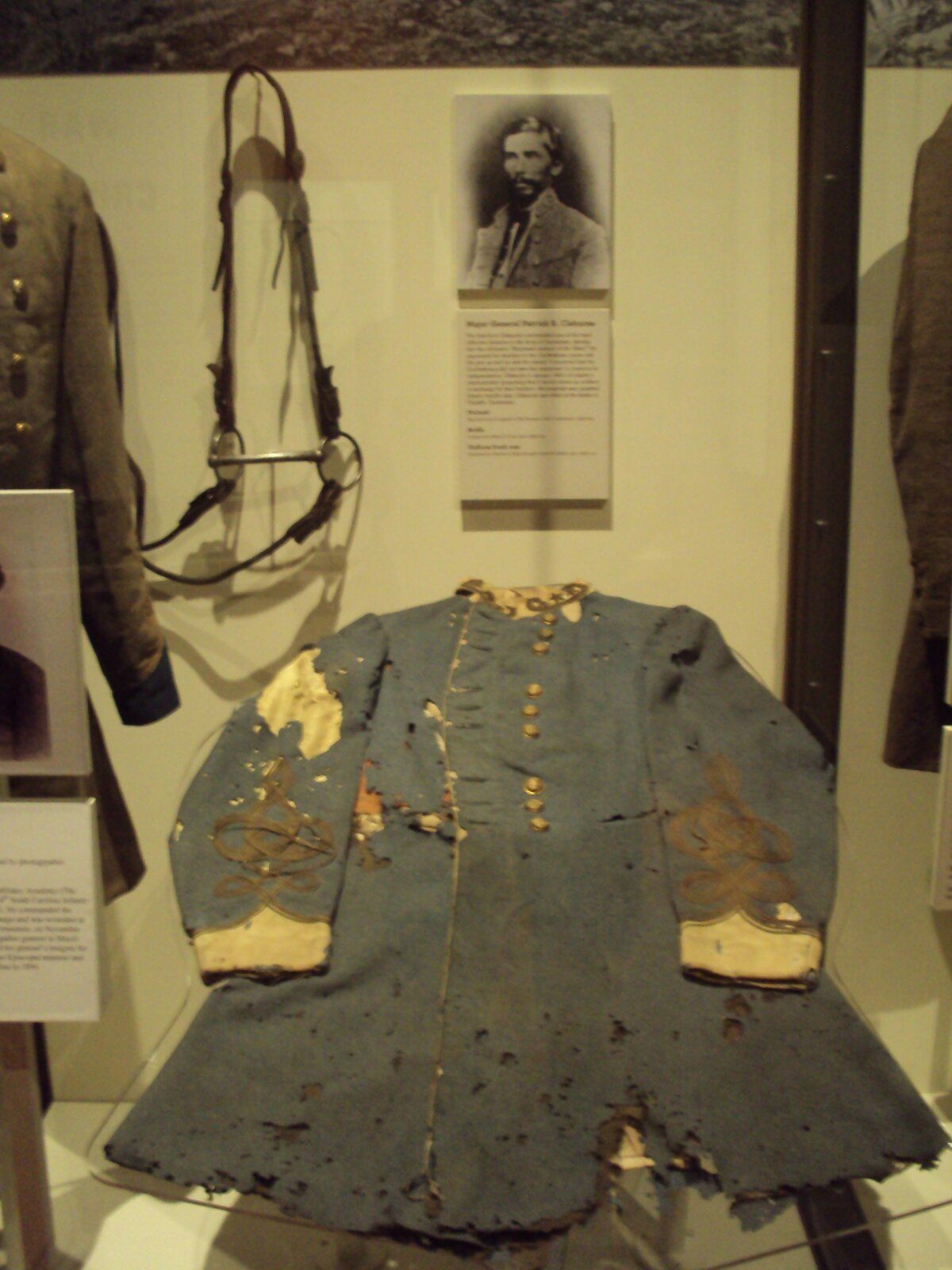

Another noted fatality of the war was Patrick Cleburne who was reputedly also wearing a new officer's sack coat instead of a frock when he was killed leading the charge at Franklin, a much-moth-eaten example of which is displayed in the Virginia Civil War (formerly Confederate) Museum now relocated to Appomattox. He was likely buried in the sack coat - this frock turned up much later when items were being donated to the UDC for the museum.
Thanks for the info. Now the follow up: would you have a photo of a general's sack coat so that I can see a clear difference. The Time/Life book, The Confederacy, has a photo of Buckner's "pleated fatigue jacket" (Page 91) it is a different style.

Offhand, the above photo showing Tennessee cavalry Col. Tom Scott is the only full-length example I seem to have a copy of.
Unless they're full-length it's difficult to be certain, but it's likely that both Harry Heth and A. P. Hill are wearing them in their familiar photos. The hallmarks of an officer's sack include: finer material than enlisted examples; a roomier, more comfortable cut than frocks; roll-over collars with relatively wide lapels; frequently, outside slash pockets like Hill's; and most importantly, are usually single-breasted instead of the double-breasted officers' style that was regulation for frocks.
