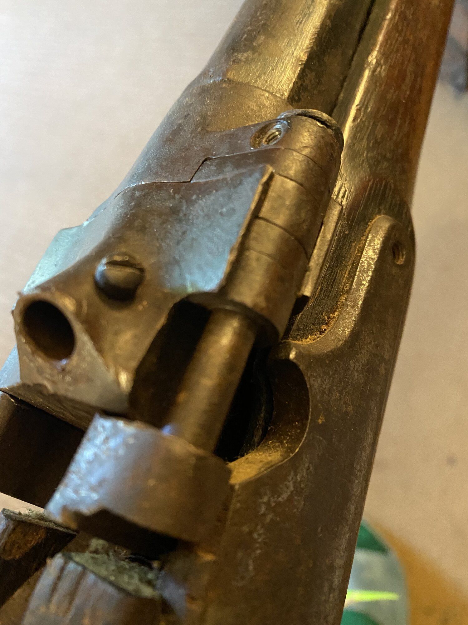

That's rather interesting. It seems a rather large mechanism on the breech end for a muzzle loader. Wonder if the plunger looking device is a breech lock? It looks like the mechanism should swing open to the right. Perhaps it's rusted shut.

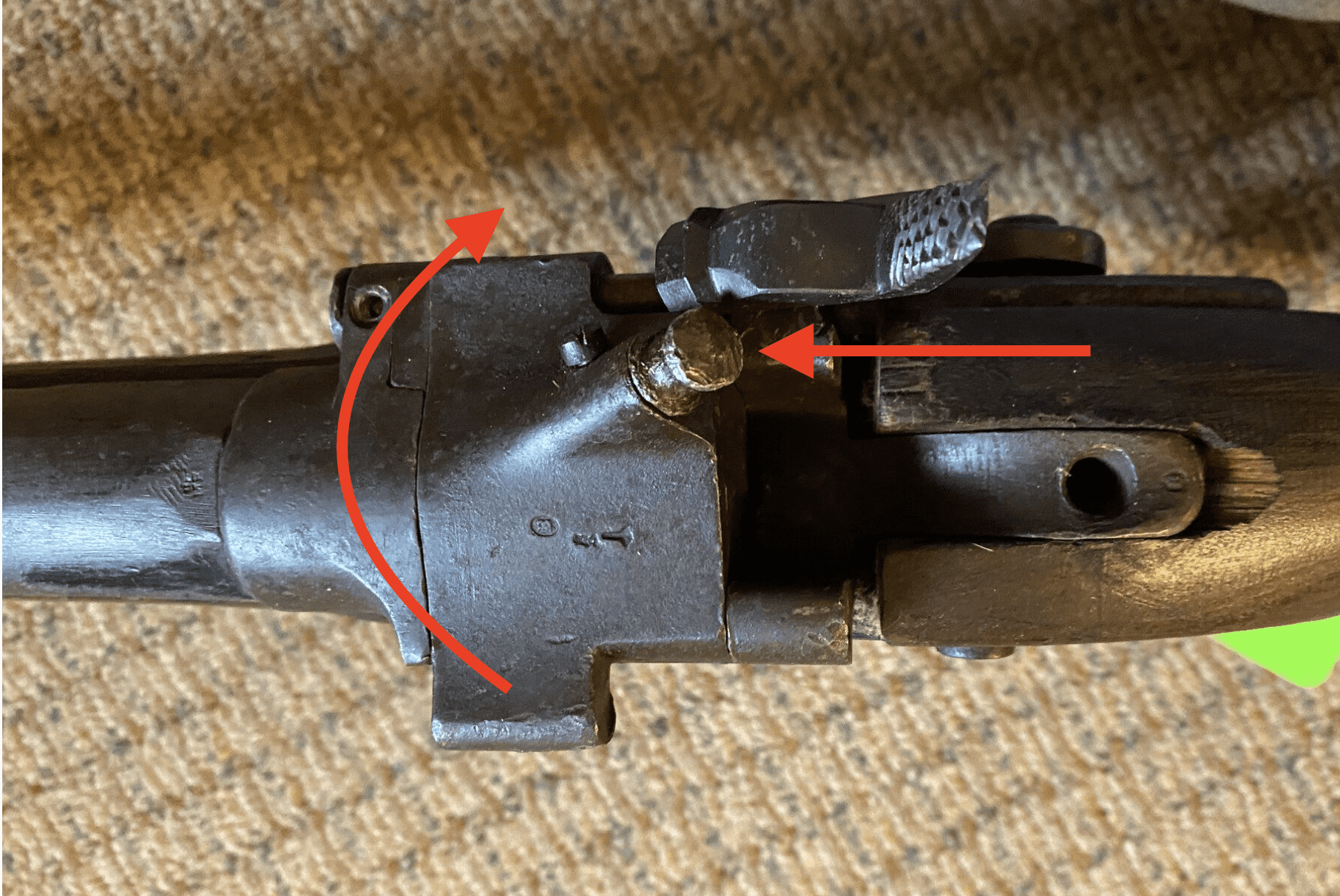

What looks like a plunger to you is *most likely* the firing pin.
The hammer (probably made for a drum-conversion) is flat (not curved inwards) so it'll never come in contact - and therefore, it's incapable of firing as-is.
@NH Civil War Gal - the thumbpiece on the left is how you open it.
Pull the hammer back to half-cock (if it holds), then rotate (as per the red arrow) from left to right.
Here's what an unmolested French one looks like https://www.militaryrifles.com/france/tabatiere
Addendum - the French conversions seem to be all brass, while the Belgians used an iron action (google "Belgian Zulu shotgun" to see what I mean). Think of these conversions as the European version of the Springfield Trapdoors (just not as good, they were chambered for some pretty lame cartridges).
So technically, your friend is kinda-sort correct in that these were post-war conversions of pre-war weapons (and the French percussion rifles *did* make it over here). So nod and thank him.

I kinda figured it might be a firing pin, but as the hammer is obviously not aligned to it I thought it just might have been a sort of breech lock, especially if it was designed to use a rim fired cartridge. Not being able to handle it to see makes it a bit problematic absent any in depth experience in musket conversions. But you have solved her puzzle, Bravo!

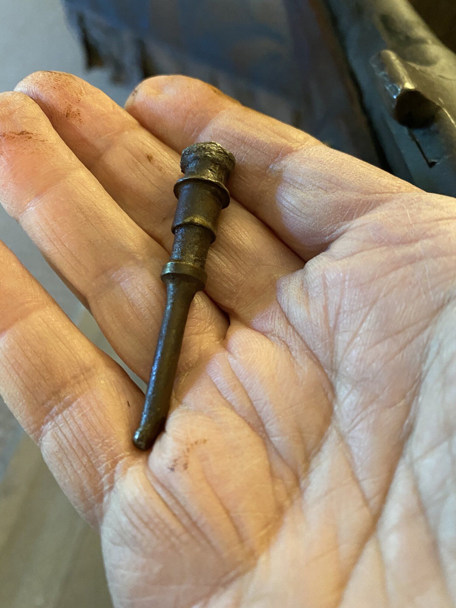

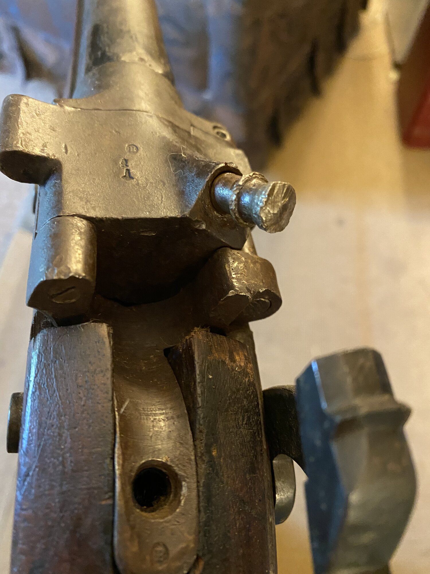

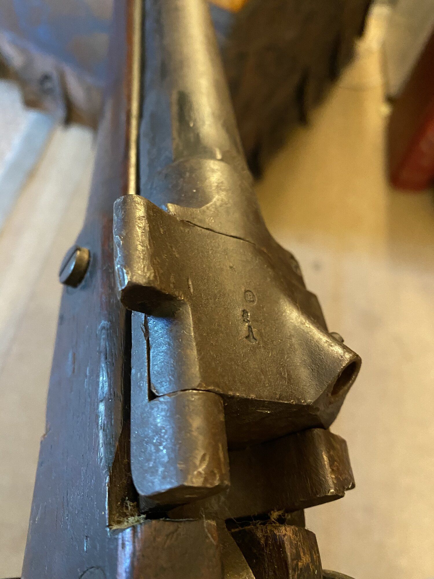

I had time again to play with this and take more pictures.
I cannot get this hinge to budge at all.
If I press up on this to try to get it to open, the whole works tries to lift off the stock.
May be rusted shut. Hammer time?

As a follow-up to my original post - I took the gun with me to Maryland this past week. I met up with @Stone in the wall and he took me to a gunsmith, who he trusted. This fellow took it all apart and we got the truth. The winner of all the comments goes to @JOHN42768. He hit the nail on the head. It is made of up various parts and needs a new firing pin to be built, etc.
It is American stock - walnut, he took the butt plate off to see if there was anything else to find behind it, but no. He opened the breech with a mallet and exclaimed that "people had done bad things to this a long time ago."
What I have is a late 1800s black powder shot gun and it would need to be entirely rebuilt to use soft brass black powder shot gun shells. Since I'm not going to shoot black powder (I have done it) with this, I have a wall hanger BUT the mystery has been solved!
