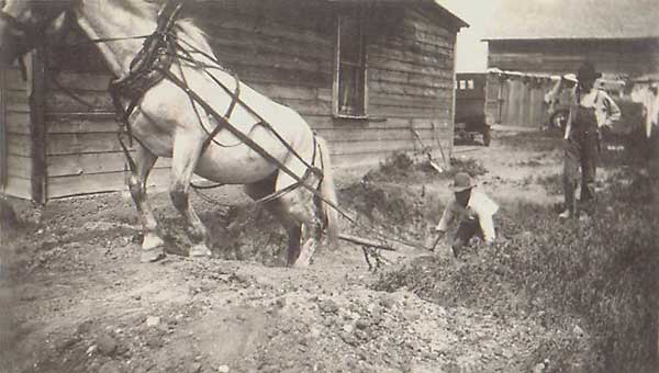

Heres a horse using one to dig a celler.

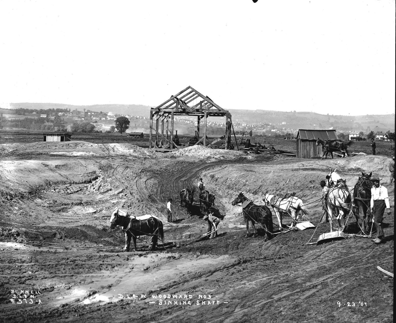

Here's a photograph of preparations for sinking a mine shaft in Edwardsvile, Pennsylvania in 1907....
Thats a great pic. You can see the circular runs each group of teams is making to clear out the hole. The scapers they are using are the same as the one I have with the two riveted skid bands on the bottom.
Unlike the video i posted there is no one upfront with the horses just the guy in back using the scaper with the reins around his neck. The horses know the drill and are working mostly on verbal commands.
Looking further at the pic, there has been a slow down in the work as the two teams in the foreground are standing and waiting for the guy in the hole to clear. Guy in the hole has his traces slack and team is not moving forward. Operator that is second closest to camera is getting impatient even has his hand on his hip holding reins. Guy closest to camera has turned away from the team probably talking to someone.
Funny how things change but some things stay the same on a job site.

Thanks. You are awesome at finding the pics.
:wavespin: Look at the horse up top right of the image. Wouldn't want to be the one to have to drive that team! :nah disagree:
For me, Ill take the team furthest left.....standing patiently with the guy bending over to pick up his handles. That's the team for me! ....no swishing tails (near right) and no stink eye (dark horse of center team foreground trying to look over his blinder) and definitely not the team on top right .....doing whatever they're doing. :D
Thanks for your response.
You certainly studied that photo. Glad you enjoyed it....
Yeah that guy in the upper right is holding them back and they want to move, lol. Funny that driver also appears to be looking at the guy in the hole.
There is a mix of different harnesses on the teams. The company either brought out their teams that normally do different jobs or hired on local guys and their horses to fill the ranks. The guy in the hole and the team descending into the hole to his upper right both have rigs that could be off the farm. Two in the foreground are more specialized.
