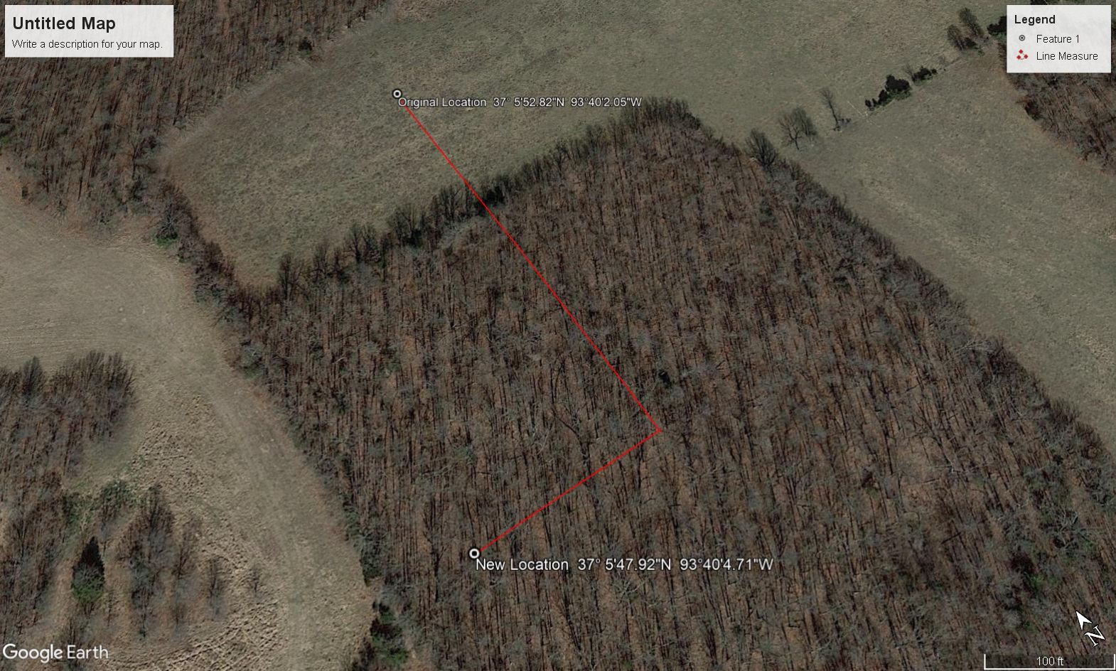

One way or another, I expect you will have to plot the original postion and then recalculate from that. You might try using Google Earth, that has plotting and measuring tools that will allow you plot and read the new location fairly precisely.
Here's a made-up example with the original coordinates (top), and a measure position 500 feet south and 200 feet west of it:

Google Earth will display coordinates in degree, minutes, seconds; degrees, decimal minutes, or UTM. You first navigate to the reference point provides, and place a Google Earth landmark there. Then using the measuring tool, mark off lines of whatever distance and direction required (in the example above, 500 feet south and 200 feet west). Then that will give you the desired position. Put another mark there and it will so you the desired coordinates of the new location.
Here is the same example as above using UTM coordinates:
