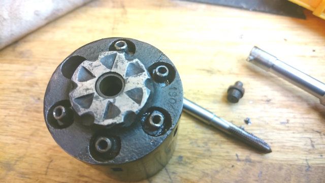

Cylinder takes the "regular" 225-32 nipples and these are installed at a slight angle,like on the Remingtons et al. As is clear to be seen,cylinders carry the serial too. In this case 1906

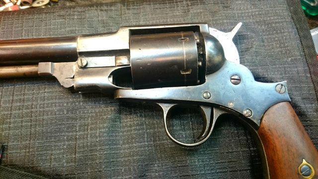

At the top of the absolute rear of the trigger guard is a small pin showing. This holds a small "fill in" piece onto the frame,where the cutout for the hand was made.
This..is very very often missing sry to say. Here you can also clearly see the lock setup for the plunger for the cylinder retention.

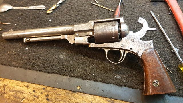

..friend Anders called me up one day and told that he´d gotten his mittens on a Freeman! About as scarce as hens teeth. This one broken too,which i knew how to remedy,and from the looks of it having lived a way harder life than my own.

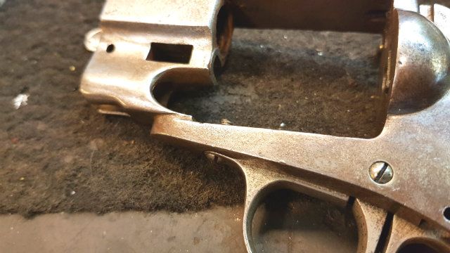

Indeed. Wrong stocks,had been nickel plated and what not. Action didn´t work,and the list goes on and on.. Also notice that that small "fill in piece" i speak of above was of course missing.

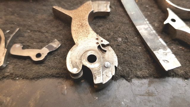

Took the thing apart,and sure enough.."Mr Handyman" had been at it. It truly escapes me why some people will refrain from taking advice from those in the know. Look at that hand..and bolt.
Really?

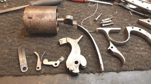

In turn the mainspring from a Remmy that had been cut down. Yeah. Good luck with that. But..be that as it may the mainstay of the gun was there at least so i set forth..
Indeed. An entire excenter missing,a few springs and what not.
There ya go. That´s how a STOCK hand for a Freeman is supposed to look. This then off of my own gun.
