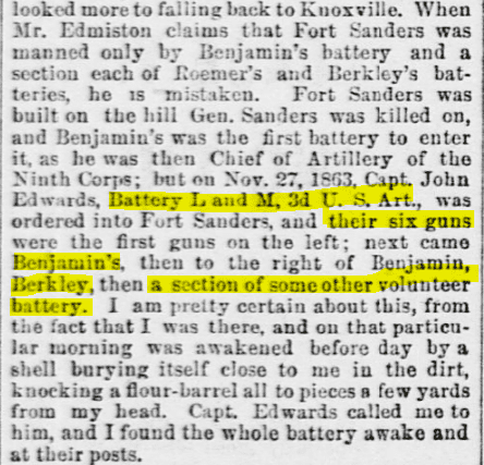

According to William Frederick Wieland, Bugler & Orderly to Captain John Edwards of Battery L, 3rd US Artillery, the US artillery in Fort Sanders was composed of Battery L&M, 3d US Arty; Benjamin's Battery; Berkeley's battery; and one section of "some other volunteer battery."

The National Tribune., July 07, 1892, page 4.
According to William Frederick Wieland, Bugler & Orderly to Captain John Edwards of Battery L, 3rd US Artillery, the participating artillery was: Battery L&M, 3d US Arty; Benjamin's Battery, Berkeley's battery, and one section of "some other volunteer battery."
