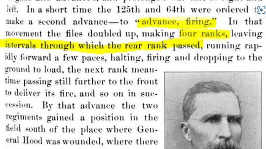

Many Western US units by Chickamauga were instructed in an informal mode of attack in line of battle called "advance firing" whereby every other file drops behind a neighboring one, making four ranks, and in the attack, the front rankers fire and drop or halt, and the others continue, with each rank firing reloading and advancing in succession.
This mode was credited to General August Willich, and his troops, and others including Harker's brigade at Chickamauga employed it. It was not dissimilar to the "fire advancing" drill of a skirmish line in Hardee's/Casey's whereby file partners alternately fire and take cover to reload as their partner advances and takes cover etc. ;but adapted for use by a line of battle for the purpose of attack. The 125th Ohio also employed this mode it at Chickamauga:
the history of the 124th Ohio notes on September 19 the attack of Johnson's division, McCook's corps; in column of regiments; the front regiment fired and fell to the ground to reload, "while the next regiment rushes over them only to repeat what those had done who had gone before." [Lewis, 1894, 59-60.]
Next, from "Steedman and his men at Chickamauga" is mentioned that after Steedman's division attacked the Confederate far left at the Horseshoe Ridge on the afternoon of Sept. 20, the Confederates of Patton Anderson's brigade, and Bushrod Johnson's Division, etc. attacked in a not dissimilar mode, over the broken and wooded ground in loose columns, sometimes up to eight lines deep, and the front rank would fire, fall to the ground to reload, and the rear ranks would bound over them to fire and drop as they in turn were passed…
