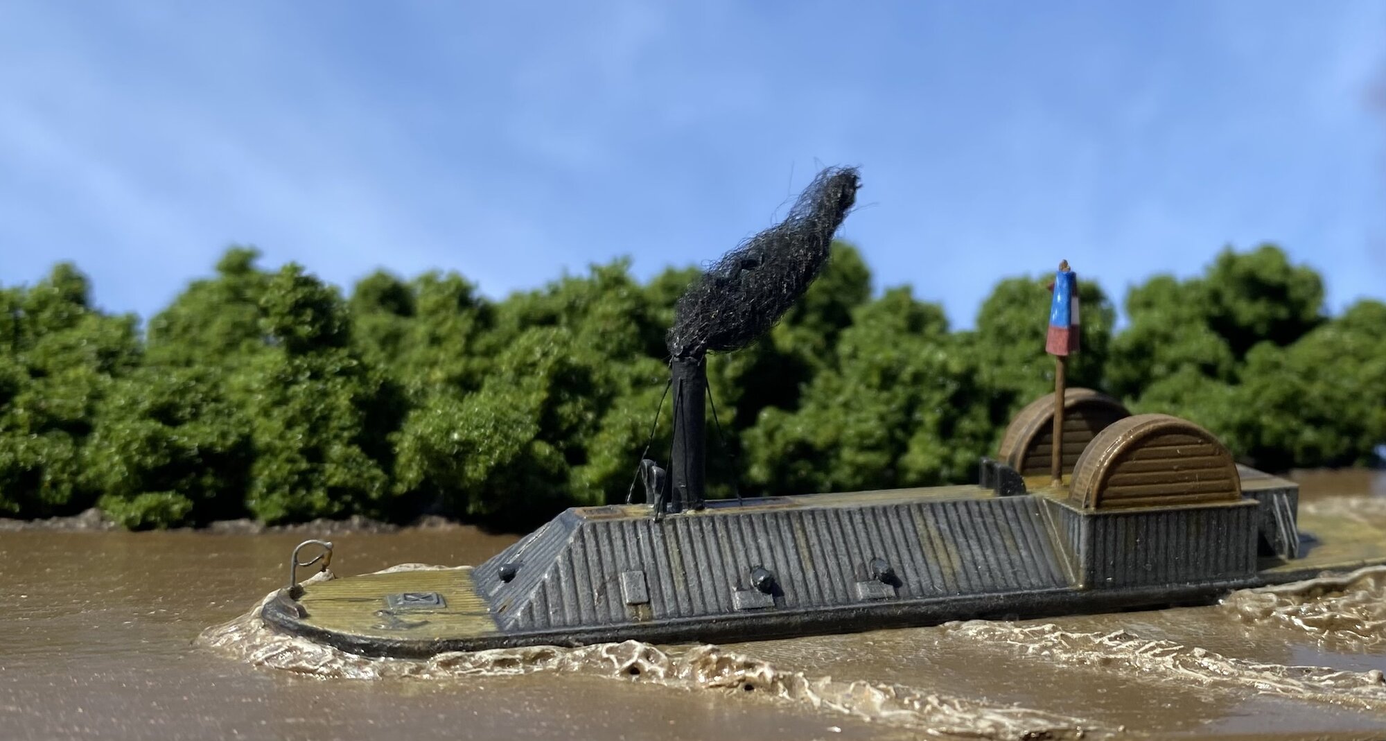

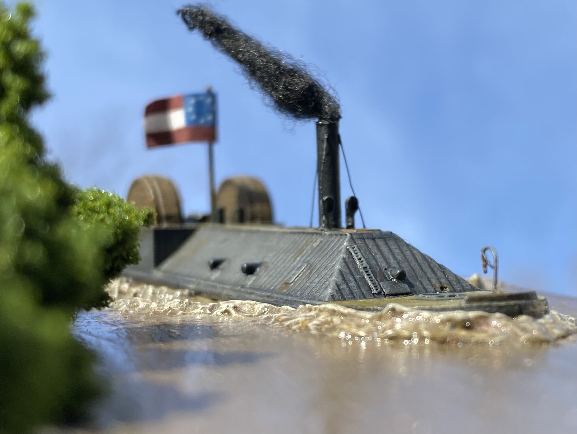

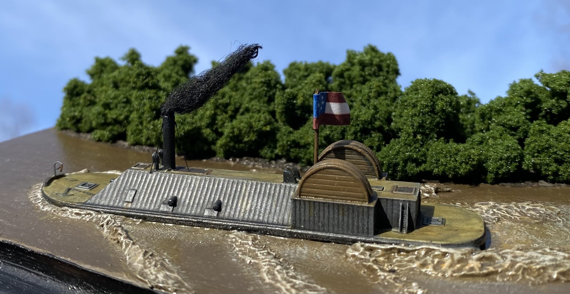

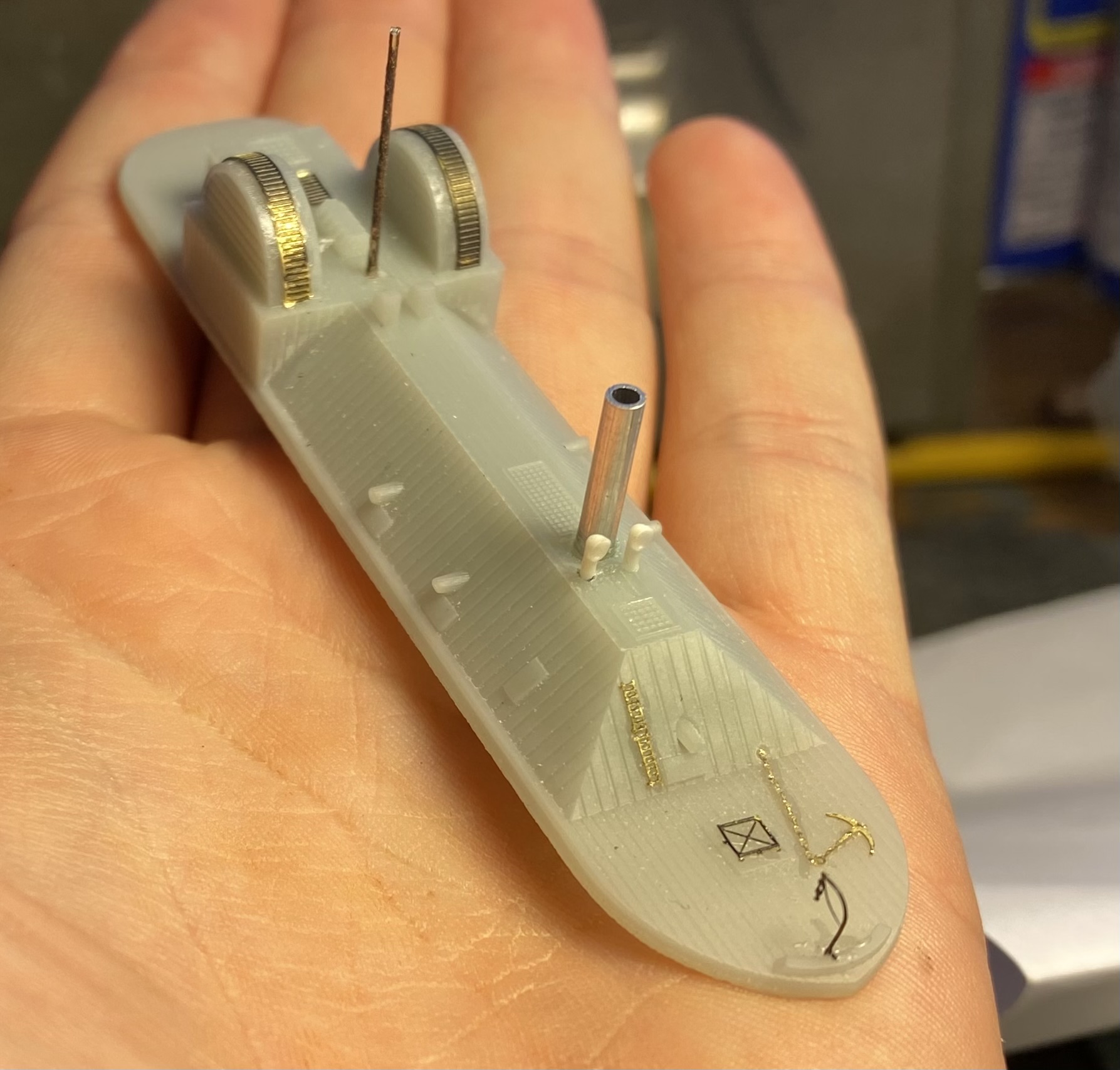

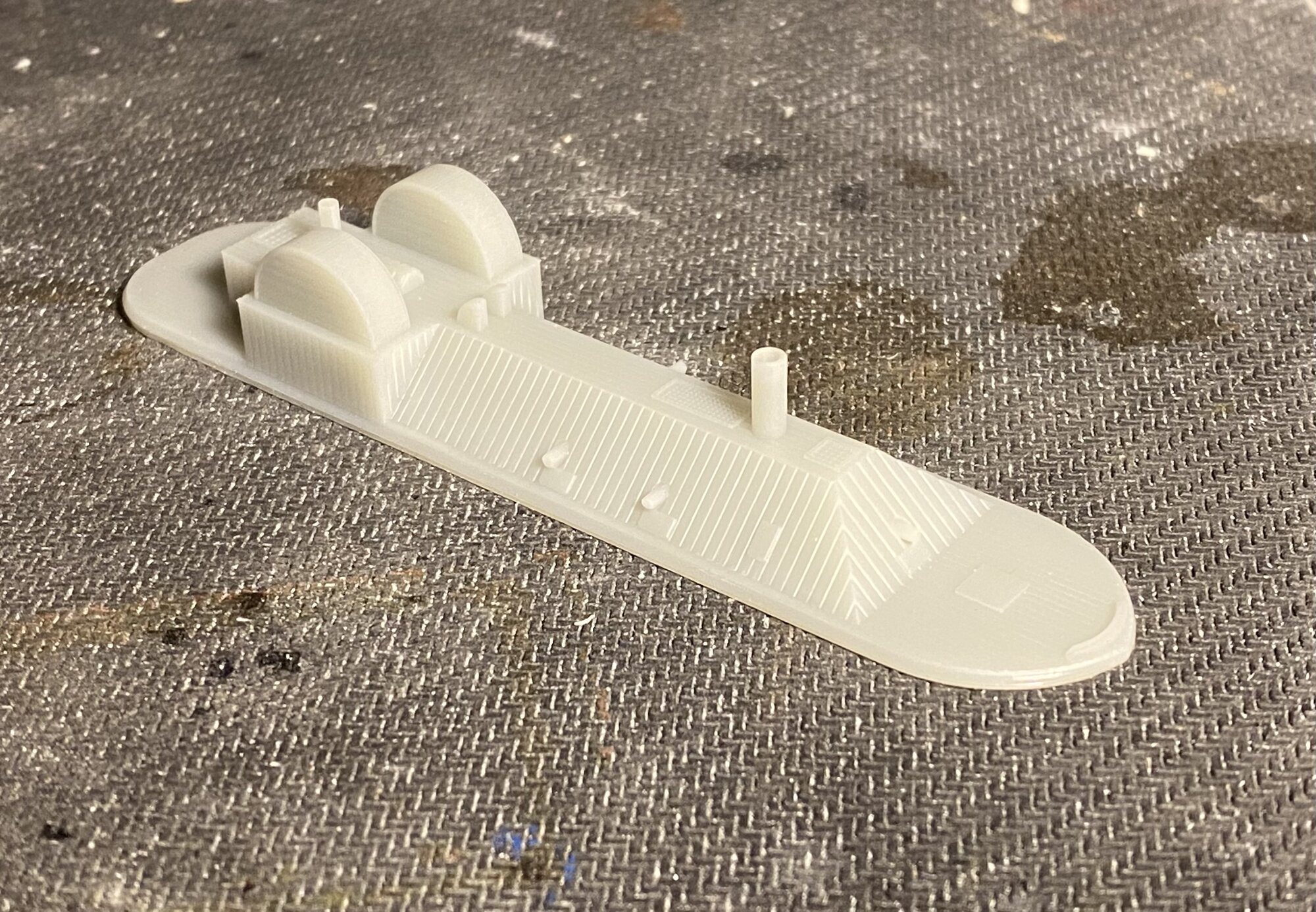

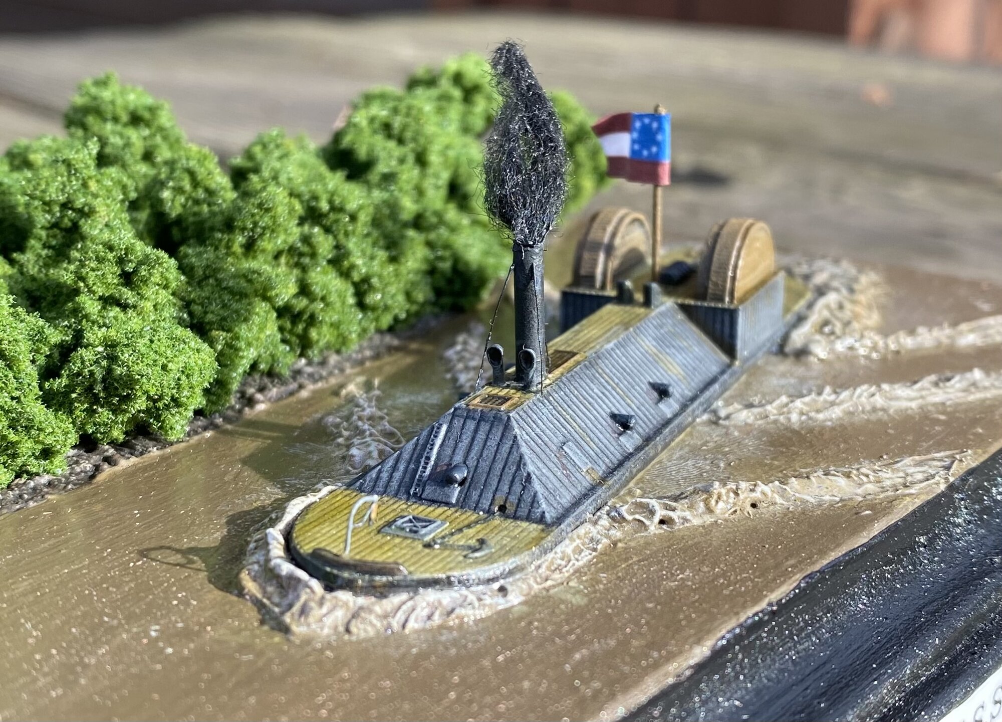

The "White Elephant of Mobile" herself, sputtering down the Tombigbee at a blistering walking pace! I made this model from a 3D printed game piece designed by Eastcoast Ironclads which I altered a bit with some spare photo etch.

WOW you have quite a talent. Very well done.
Years ago I tried to build a resin 1/700 US Navy destroyer from WW2. I could not handle the photo etch and gave up.
How did you do the water effect ?

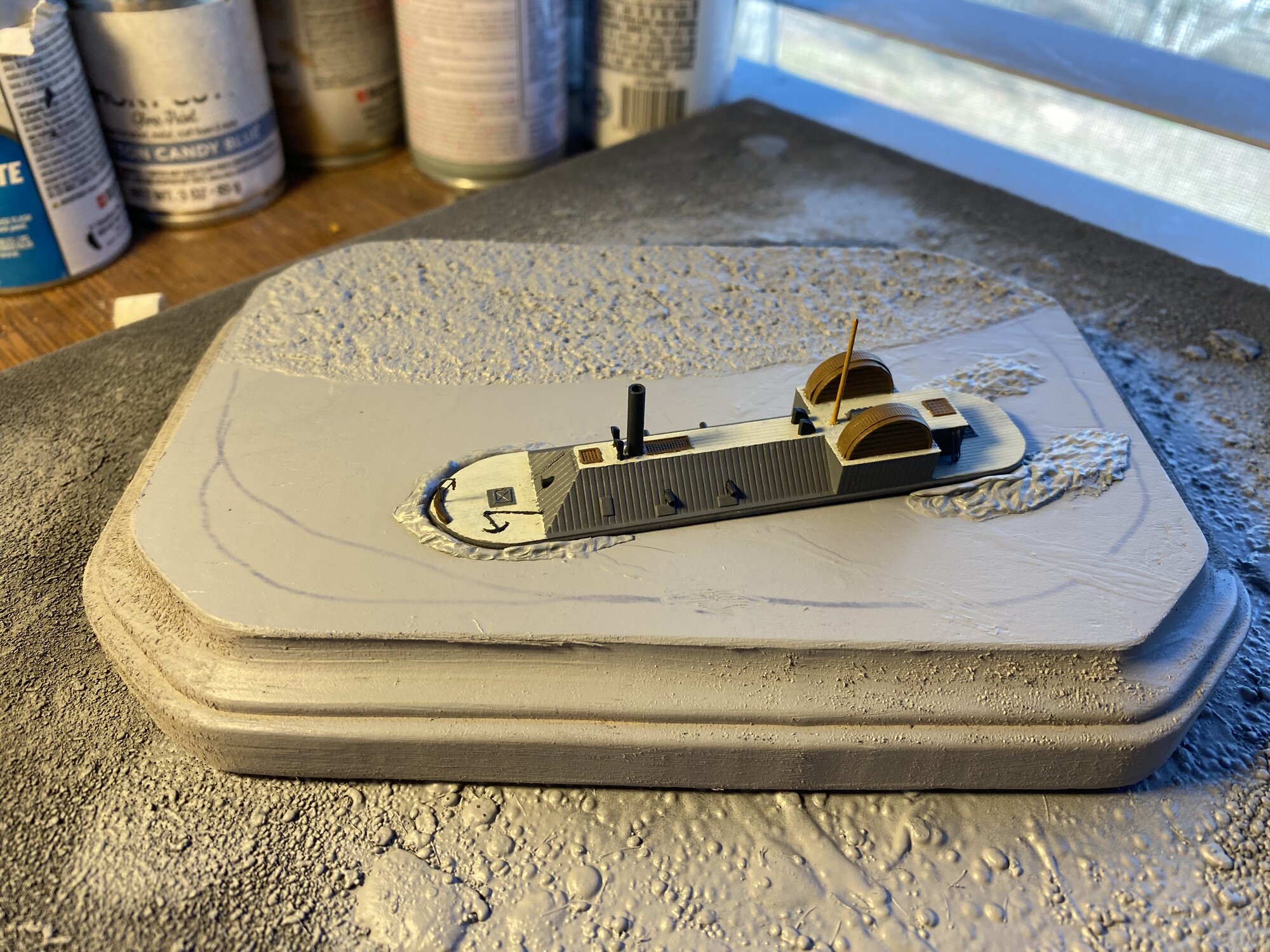

I used hot glue to form the basic shape of the wake and swell around the ship, then I used a lighter to heat up a metal sculpting tool to shape the globs of glue into something that resembled waves. After painting the water, I covered it in glossy clearcote then covered all of it with Elmer's clear pva glue which I also stippled a little to give texture to the river.

Lovely work , She was converted either from a cotton lighter, or a garbage scow, sources differ. Whatever she was she was apparently rotten underneath when the armour was removed for CSS Nashville.
