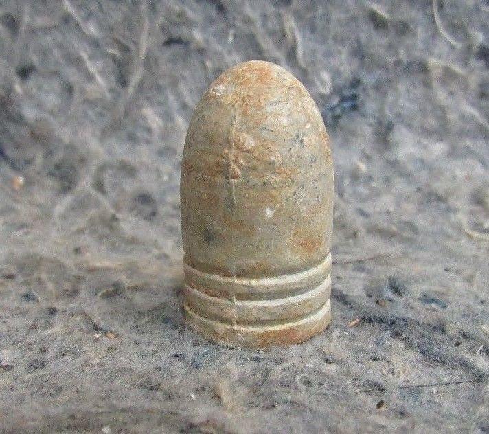

CSA Bullet Side Seams
I don't think so. The Confederacy was not good with producing things like ammunition and artillery shells. Alot of CS shells were made of poorly made iron because of air bubbles in the casting. So it makes sense they weren't able to produce perfect bullets. The Union had great production capabilities, so they made perfectly casted bullets, unlike they're southern counterparts.
That's pretty much what I was thinking too. The North had outstanding industry and technology compared to the South. All of the Union bullets I have are seamless and appear to be machined. Thanks for the reply!

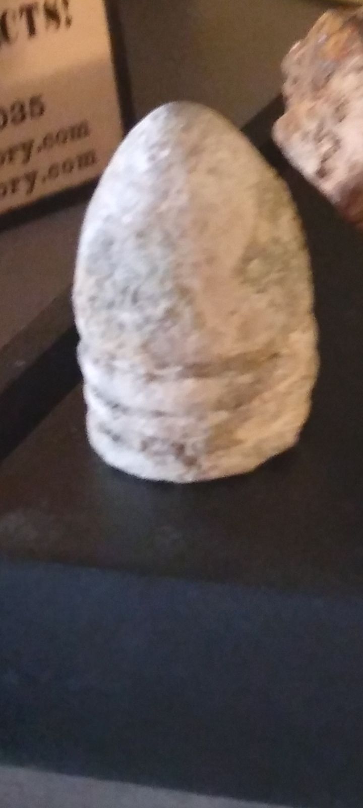

A fun fact for you, if you see a bullet with corrosion on it, like mine, that means it's been sitting in its own gunpowder for a long period of time.
A fun fact for you, if you see a bullet with corrosion on it, like mine, that means it's been sitting in its own gunpowder for a long period of time.View attachment 502876
Almost every bullet I have has crust, lol!! I'm amazed at how different bullets look when exposed to different chemicals/environmental situations. I posted a pic on this forum awhile back and these Jedi masters knew immediately that the bullet was from the wishing well in Savannah!! I'm soooo glad ai found CWT!!! A GREAT EDUCATION!!!

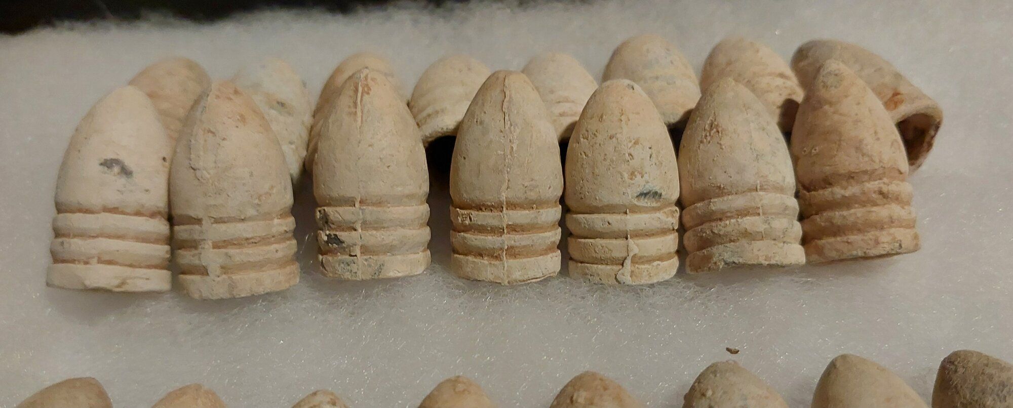

Question, do any Union bullets have side casting seams running down them or were these "seams" strictly Both sides made some of the bullets the same way. So some rounds have a seam. I just recovered these out of a 2nd corps Army of the Potomac camp just before Gettysburg. They have visible seems. What's notoriously Confederate is nose cast 3 ringers. Not to be confused with Williams regulation bullets though. I've dug a lot bullets from union spots that had seems. Some of the .69 cal three ringers I find in union camps have seems.

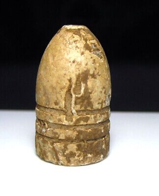

Do only the Williams regulation 3 ringers have obvious nose cast sprues or blobs? Any other identifying features? Also, how rare are .69 3 ringers with truncated cone bases? The ones I've seen most commonly are cone bases but I recently came across one with a truncated cone. Thanks
Union arsenals were swaging bullets.
Absolutely were buddy. They had them at Gettysburg.
