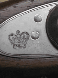

I have read that Confederate British
Enfields never had a picture of a crown as a marking. Is this true? Here are some photos from an Enfield that I was told by two sources was Confederate. Any input would be appreciated.

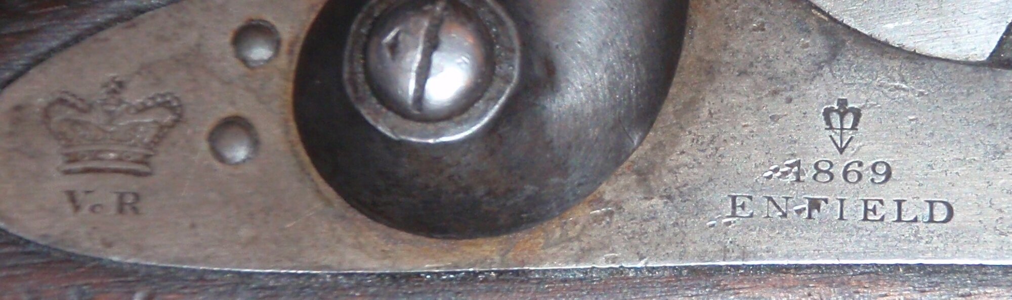

Most of the P53s supplied had only the crown on the lock plate. Some had none. All those supplied to the British Army had V.R underneath the crown (V+R = Belgian-sourced; V*R = French-sourced, but not always) and Enfield marked locks are all dated. No Enfield locks were supplied to either side during the conflict. While this is true for the vast majority, the London Armoury Company (L.A.C.) supplied some 70,000 P53s with the V.R under the crown, as they did for all the rifles produced by them (they had the same machinery as Enfield). The later LAC P53s also had no London proofs, just L.A.C on the barrel
The real decider on a British issue rifle is the military acceptance marks on lock and barrel.
On the lock, it usually appeared near the maker name (Enfield or Tower)
None of these were supplied by the British government although a number of older 'sold out of service' guns were sent by civilian contractors, but these will have the opposing arrow mark -X- on butt and barrel, and civilian proofs on the barrel. The acceptance marks were often overstamped as well.
Your musket should be made by Barnett. If you look closely you will see the remnants of "TOWER" under the crown. To my knowledge, only some Barnetts were marked that way. I have never seen "TOWER" under the crown on any other than Barnett.

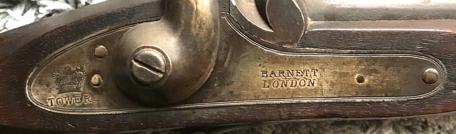

It looks that way, but there is a lot of corrosion there, however the 'high' crown seems to confirm it. The TOWER was usually stamped where the makers name is on this photo from an older thread:

The rear markings are definitely correct match
This is an answere I got from a facebook page: The crown stamp to the rear of the lock was typical of nearly all Pattern 1853 Enfield arms, whether they were British Military or commercial arms. However the "VR" mark under those crowns typically indicated British government ownership and most of those guns did not get exported for Civil War use. Exceptions to that "rule" include London Armoury made Enfields, which all had the VR whether they were British military or commercial arms and some of the obsolete British military arms sold out of service during the war. These include the Patters 1839, 1842 and 1851. Also, some earlier Type I and Type II Enfields were acquired by the south and are known with Sinclair, Hamilton & Co markings. These guns all have the VR and other British military markings. They are, however, extremely rare and very much the exception and not the rule. It looks like a very weak "Tower" stamp is below your crown, indicating this is a Barnett lock. Barnett was the only maker to put that under the crown and I believe it was only used fairly early during the war and specifically for guns being exported for Civil War use.

No other marks than the ones I posted. I don't know what spring retainers for the bands means.
One wrote a book on Confederate arms. I cannot remember his reasoning.
Barnett was one of the most prolific arms suppliers to the Confederacy. A large percentage of British-made weapons imported by the Confederacy came from and through Barnett.
That being said, not all Barnett arms were Confederate. Most, I'm sure, but not all. So unless there is another indication or provenance that indicates Confederate, you won't be able to say with any certainty.
