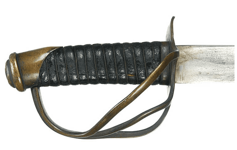

A few of the things you need to look for in the "Dog River" CS sword is that 98% of them will have a single wire wrap on the handle and not 2 or 3 strands. (there are a few exception Conning) plus most are wrapped with dyed pig skin and not leather. The castings of the guard and pommel cap will be very rough and irregular as are the blades. And lastly, hold it up to your ear and if you don't hear Dixie put it back on the table. :D

One think you have to remember is that since Bill wrote that book many many years ago additional research and other info have come to light. A great case in point is a Dog River I have in my collection.
