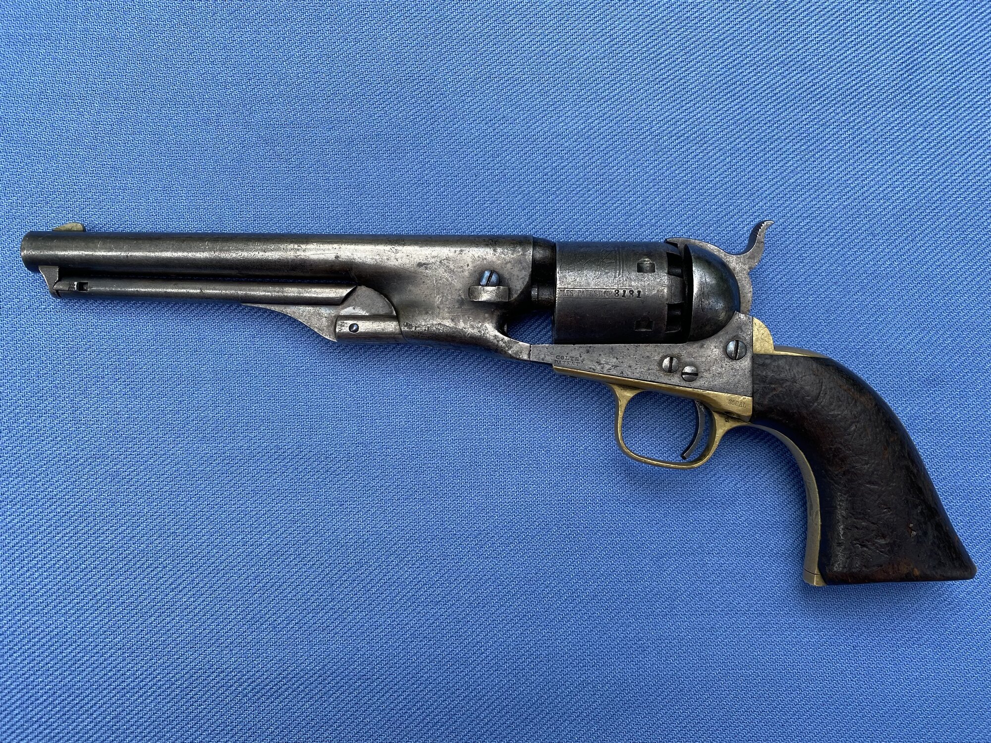

Very nice 1860 Army Colt. I like the look of it. I agree that for what information that they provide in the letter for $300 is an overly excessive price and not anywhere near worth that cost. Thanks for showing.

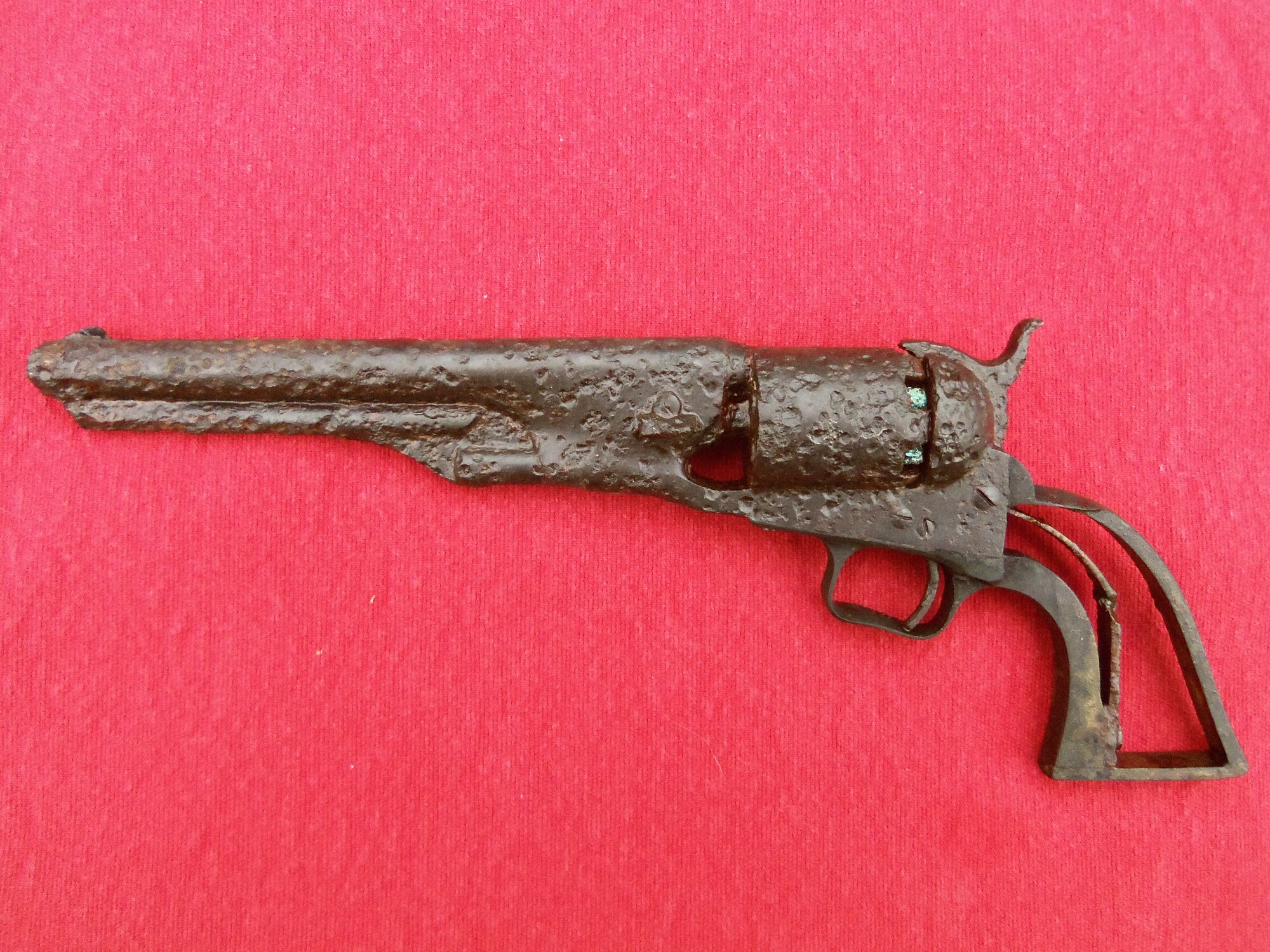

Still loaded? I see whats left of the caps I think. Thats and amazing find and story, care to say where you dug it?
Yes fully loaded. Found at Stones River (private land) in the area where the 15th Pennsylvania Cavalry was engaged with some South Carolina infantry on 12/29/1862. If you would like, send me an email address via private message and I'll send you an article that I wrote as well as one by Charlie Pate that tells the story as I know it so far. I don't want to derail this thread any further…

It sure looks like a nice one to my unschooled eye. All the things I would check for are present and in fine shape: Minimal dings and scratches, clean undamaged screw slots, crisp numbers and matching, cartouches on grips, clean engraving on cylinder. That's a nice piece!

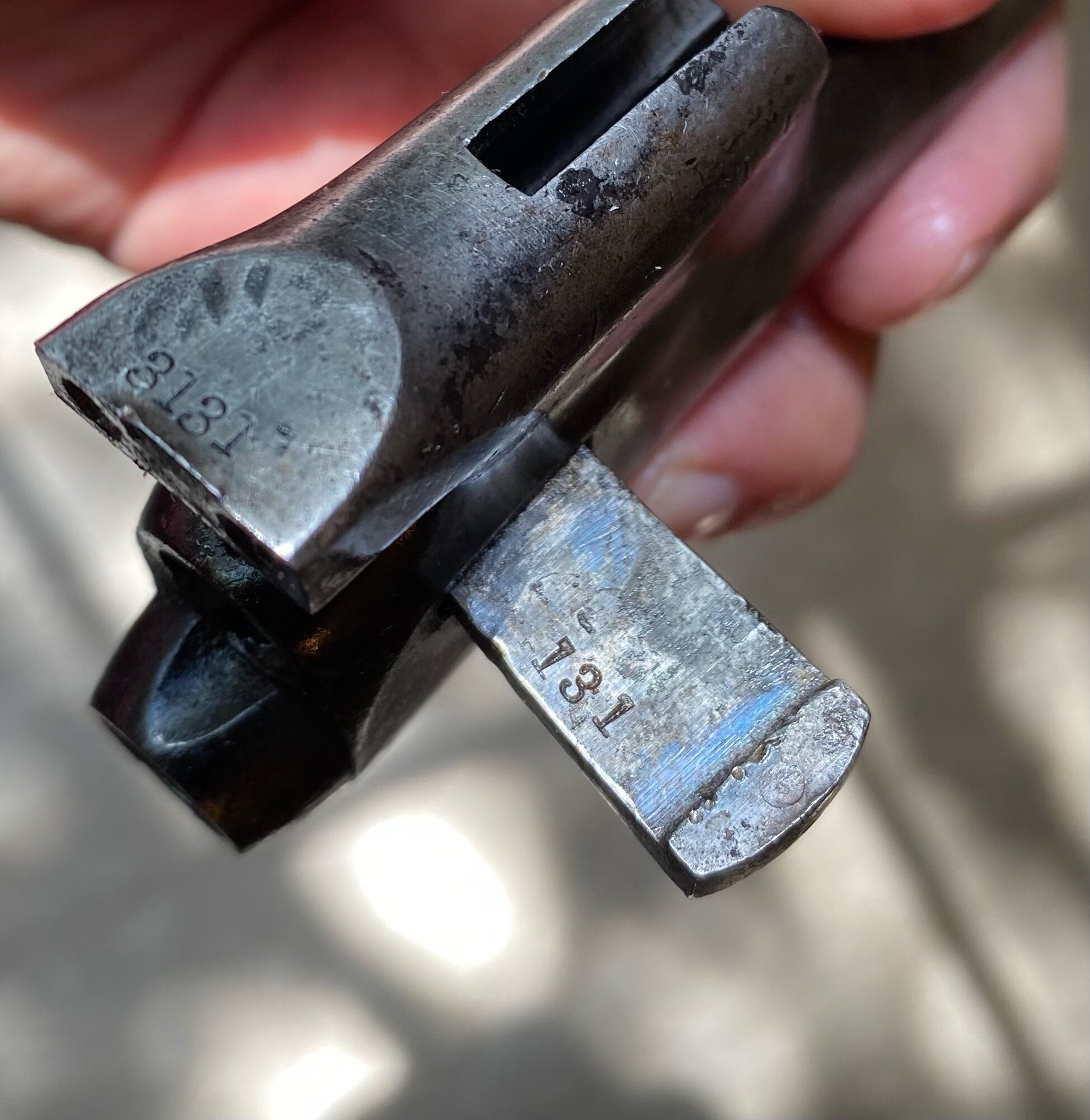

The cylinder pin/arbor supports the barrel, but the wedge positions the barrel correctly - and fixes it there. It was not the only way a two piece frame/barrel could be correctly assembled, but the simplest AT THE TIME (1835). The 'solid frame' (1873 Colt Army) which combined the two was far better and stronger, but at the time, could not easily be produced on production-line machinery - and cost a lot more. Besides, it was Colt's patent and he stuck to it.
Seeing as how the force that would cause the wedge or slot to get battered loose would be in the opposite direction from the arbor, it seems to me that there isn't any particular good reason to have it bottom on the hole.
Having it bottom out would sort of defeat the principle of the wedge wouldn't it? It would be difficult for the wedge to actually draw tight if the barrel to frame assembly stopped short.
The wedge is slightly tapered and with its spring and the set screw in the barrel it can be locked - to a degree - in the position needed for optimal operation. Bottoming out the arbor, would in theory better allow the wedge to do its job as the gun was used and metal fatigued etc. Push the wedge in a tad and you take up some of the nearly created slack.
As a side note , When I compare my originals to my repros the difference in quality literally jumps out at me. Despite the age on the originals the workmanship is far superior, the machining more precise and everything is just better defined and better made. Despite the "weaker" steel when compared to today's the originals are Something to behold.
Here's a pic of the wedge on '61 Navy #3131 that shipped to the Boston Navy Yard in October 1861. You can still see evidence of the original blueing that was preserved and showing how far the wedge was inserted. It also clearly shows the taper in the wedge to allow for adjustment.
