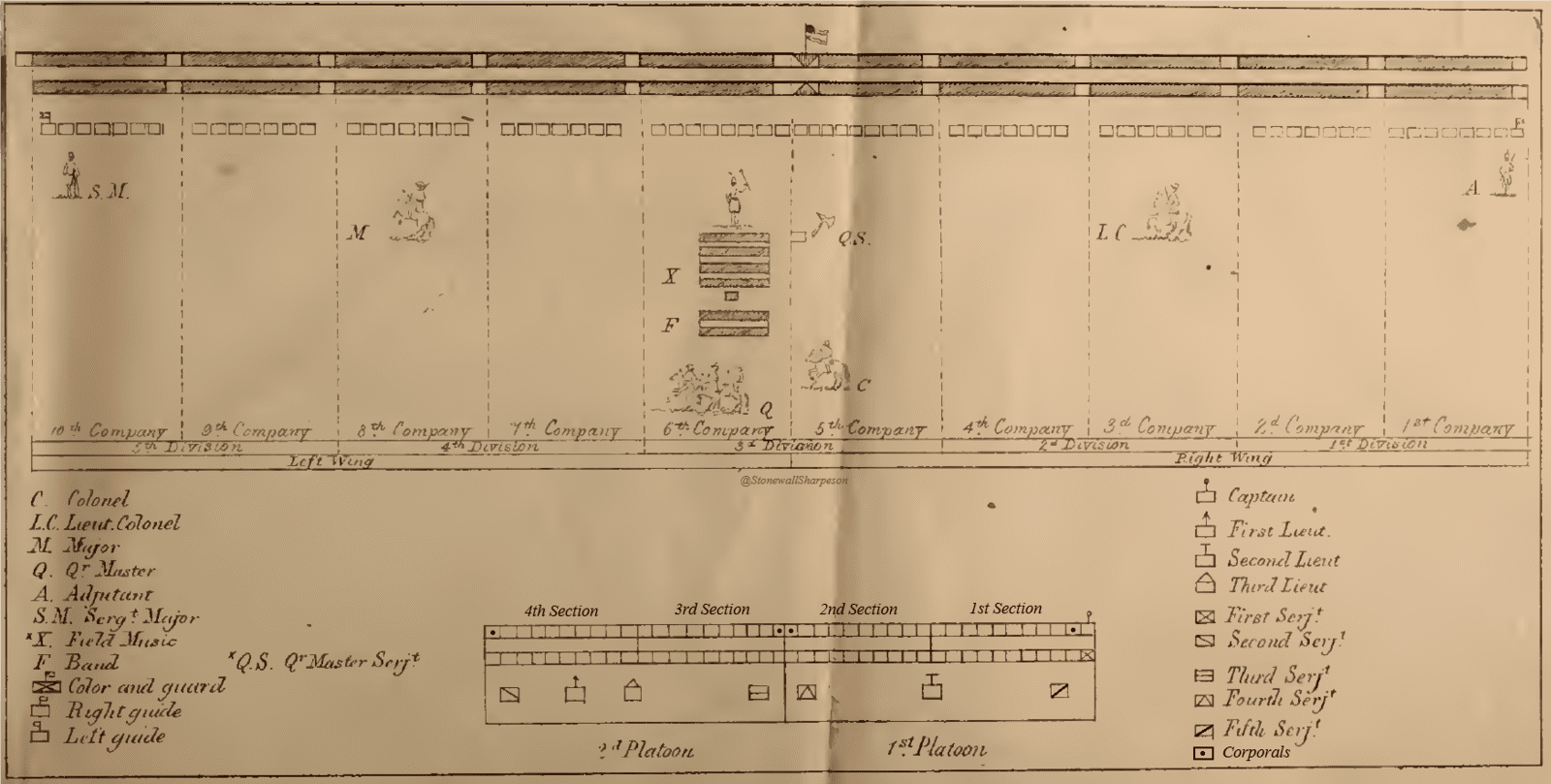

Please also see the attached illustration by Hardee of a battalion line of battle, to which I have added labeling of the corporals and sections.
So, the captain commands the company. In company drill, the captain is the company right guide and the 2nd Sgt is the company left guide. The 1st sergeant is called the covering sergeant because he becomes the right guide when the captain has to go do something else. This becomes more important when the company is broken into divisions and in battalion drill.
The use of these guides in a battalion line of battle is overdone because of, frankly, the lack of study and practice of drill by reenactors. When the battalion is formed in line of battle, the only company officers and NCOs in the line are the corporals, the captain, the covering 1st Sgt, the 10th company 2nd Sgt who is the battalion left guide, and the NCOs of the color guard. Other company officers and NCOs hang out in the line of file-closers.
Anyone in the line of file-closers keeps an eye on the company line and makes sure its members are doing what they're supposed to be doing. When the company or battalion is firing, the captains and sergeants in the company line of battle retire to the line of file-closers.
The only person who's doing any real commanding of the company is the captain; even when the company is broken into platoons or sections the chiefs of those "divisions" are only conducting their divisions to execute the desires of the captain. The lieutenants and sergeants aren't commanding those divisions in the manner of the militaries of today.
The command of the divisions can vary depending on the situation. The captain is the "chief" of lead division and the lieutenants are the chiefs of the subsequent divisions. Please see Hardee's School of the Company for more details.
The company is divided roughly in half into two platoons. The corporals are posted in the front rank and first and last files of each platoon. They do not command anything but are responsible for seeing that the privates are doing what they're supposed to be doing, helping with alignment, and keeping the step.
The platoons are divided roughly in half into two sections. Sections are not really intended to be a functional unit of the line, they merely give company commanders flexibility to approach certain situations. Sections can also be ad-hoc divisions of the platoons; they are not totally set in stone.
Side note: in theory, since all of the companies and sections are supposed to be of approximately the same size, the platoons and sections of the color company should be adjusted to make up for the additional men of the color guard, to the point of sending privates to other companies to level out the number of men in the color company. I did not mention this in the paper because I thought it trivial, and it can be accounted for with proper adherence to guides.
Finally in skirmish drill there is the addition of the "comrades in battle"; the 4 men in each group of two files. They are not commanded by, but rather conduct certain motions on, the front rank man of the 2nd file.
When skirmishing, the two mean of each file work together to ensure that at least one of them always has a loaded weapon.
Squads are purely an instructional division, and are not used in the field. If you had a small group of guys for a living history, you might as well act as a section commanded by a NCO or "high private" and conduct yourselves according to company drill. You don't need a captain for two sergeants and three privates; its goofy.
A group of soldiers with a particular task, typically related to camp or sentry duty, is a detail.
