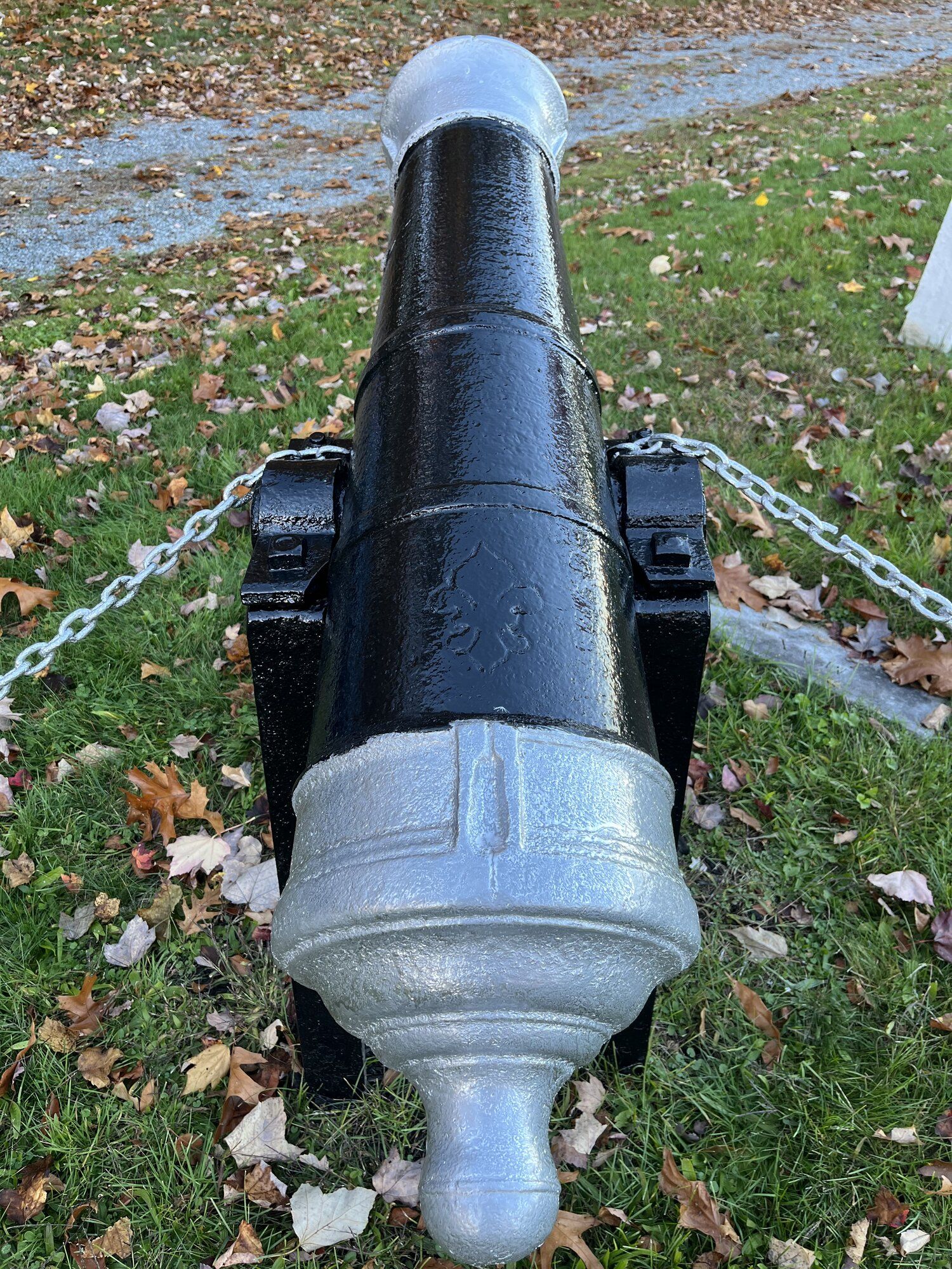

Better view of the "stubby" cannon which you believe to be a carronade. Please note the fleur de lis my and the lack of a touch hole.
If this is an iron barrel, which it appears to be, the touch hole may be filled, to help alleviate corrosion.
Yes, it is iron and touch hole may have been filled. Still trying to determine the type and origin of the cannon. The fleur de lis design makes me wonder if it is of French origin and how it got into the civil war.

I'm concentrating on the "stubby" cannon which may be a carronade. I'm a novice so forgive me but can you explain the use if a tray for the powder and how the cannon would have been detonated. Thanks
Fine powder would have been poured into the tray & ignited by slow match.
A quill primer was made of with an actual quill or a paper tube. It was inserted into the touch hole leaving a bit standing proud. Slow match would ignite it.
