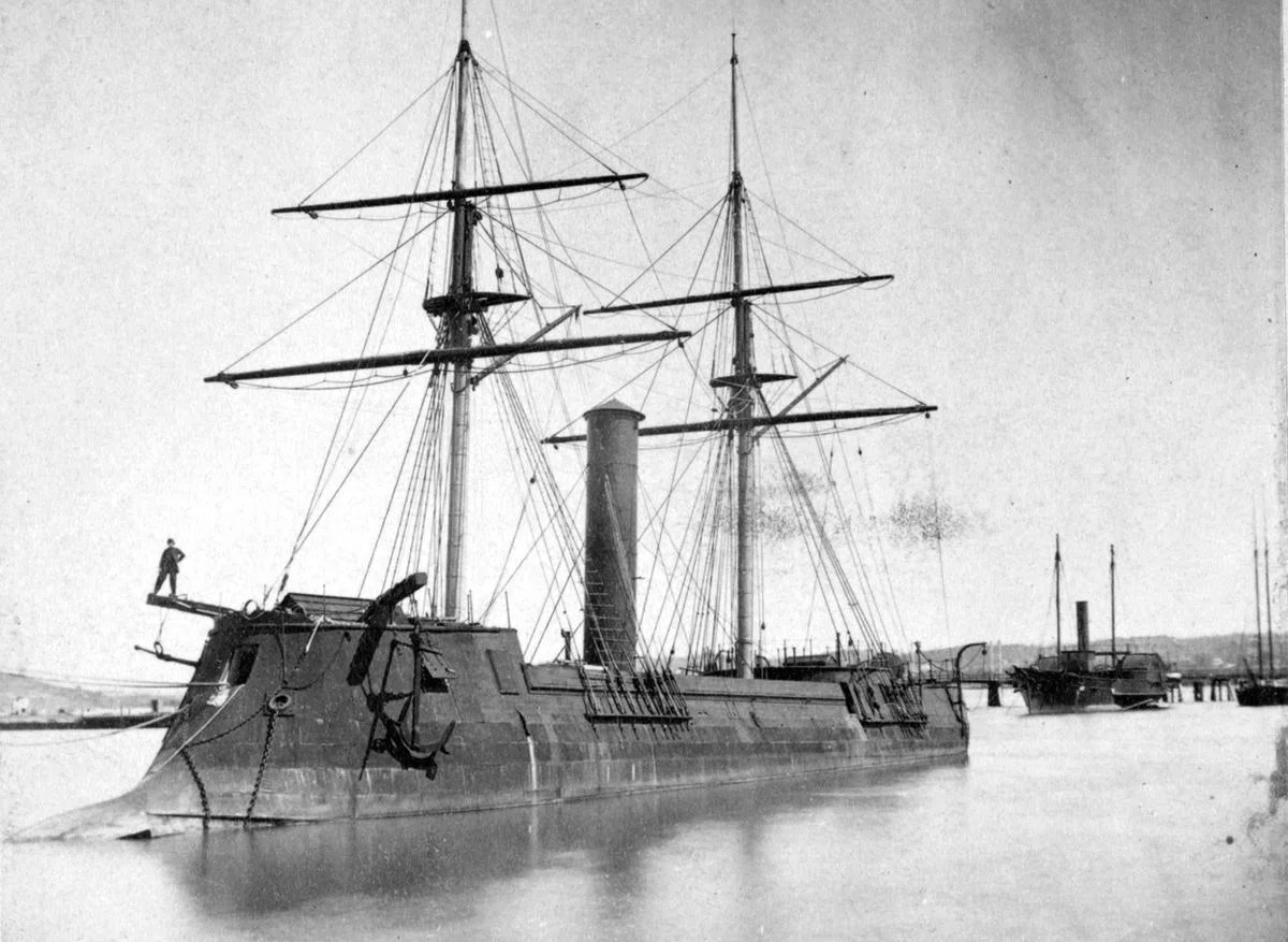

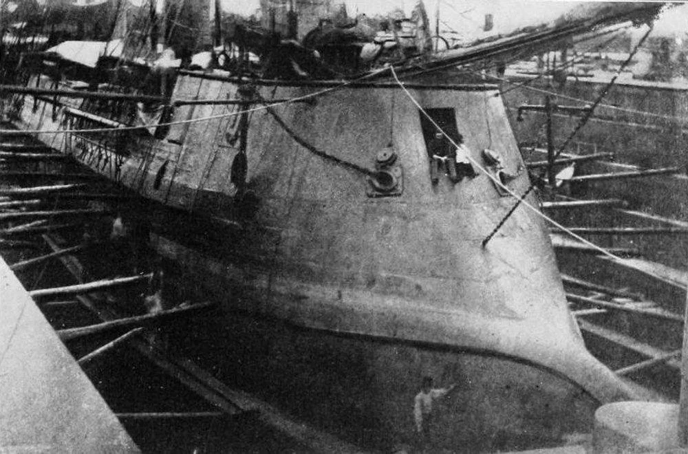

Arguably the history of CSS blue water iron hulled rams begins & ends with the Danish Navy's Sphinx.
The CSS Stonewall is an example of an iron hulled Confederate Navy blue water combatant.
In dry dock ram made it looked a lot like a 1920's Buck Rogers space ship. The worker bottom center of the image provides a measure for scale.
The narrative of the ram Stonewall's design & construction is a testament to why such vessels could not have been laid down in any Confederate yard. The active service in the Imperial Japanese Navy validates the design & is well worth the read.

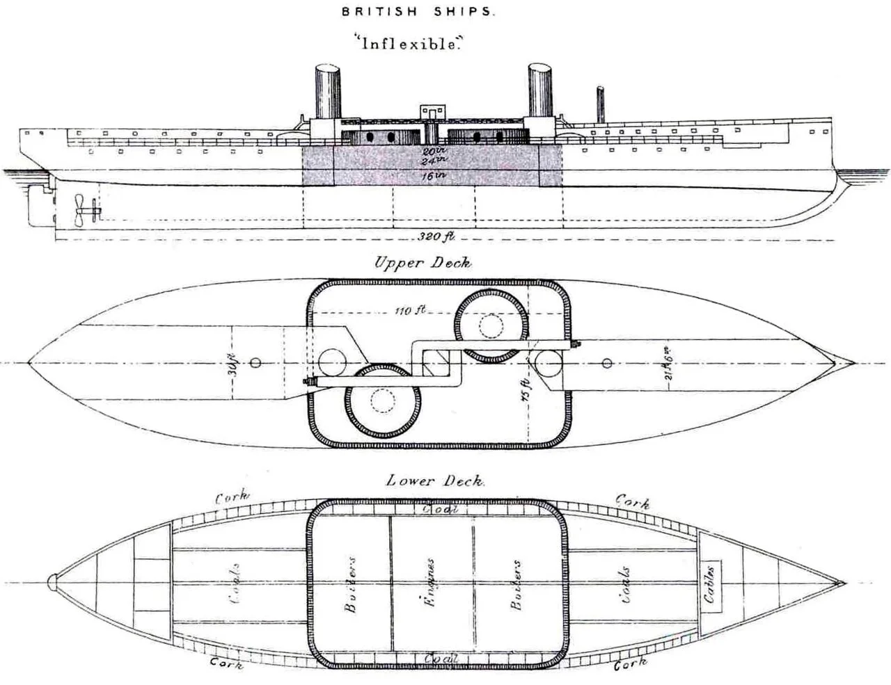

His 'brilliant design' had been rejected in 1854 by the USN. It was a flawed design and a real dead-end in warships. It could not navigate in more than (modern) Sea State 3 (waves 0.5 to 1.25 metres (1 ft 8 in to 4 ft 1 in) as it only had a freeboard of 8" loaded (18" unloaded). The turret ring leaked like a sieve, as did the hull and because of the heavy turret it rolled like a barrel. It was strictly river and estuary ONLY. It's only advantage was that it could be completed in under 100 days. The other two (USS Galena and New Ironsides) were far better ships (turret rams) but needed more time on the slipway. Most turret ships were dire sea ships due to the weight of the armored turrets and surrounding armor.
Only one later monitor made it to Britain and Europe 'showing the flag' - on a calm ocean and escorted all the way there - and back - USS Miantonomoh a twin turret monitor commissioned in 1865. Top speed was 9 knots.
USS Miantonomoh 1866 - decommisioned (finally) 1870
The final resolution for turret ships in the 1870s was the citadel ship which concentrated all machinery and armament in an armored 'box'. These also had more reliable and efficient engines and did away with any rigging. The hull was designed to hold this 'box' high enough to avoid flooding maintain buoyancy and make it a proper 'blue water vessel'. BTW - the Italian Navy had the first ones.
