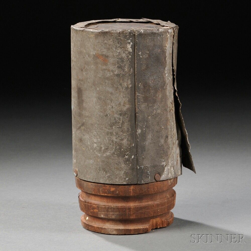

Sorry the rest are all good points to which I would add the risk of putting the piece off its centre of gravity and potentially having it tip muzzle first into the ground. That would be awkward and embarrassing to say the least.
Anyway here is an image of a US 6 pounder canister shot

What would keep the canister rounds in the tubes if the angle was too great? Friction
And this perhaps gets to the heart (s) of the problem: Besides putting an undue (and undesigned for) strain on the carriage hardware and the carriage itself by having the tubes aimed downward, Civil War era artillery tubes were designed to have "windage" built into them-that is, they were at least an 1/16th of an inch larger than the rounds that they were designed to fire so that you could get the rounds down the tube (whether smoothbore or rifled) and as the tubes wore, this "windage" grew even larger. Even though the rounds were seated by the rammer, if the tube was pointed downward at too great of an angle; there was still the possibility of the round moving forward enough so that the friction primer would not set the powder charge off and preventing the piece from firing.
