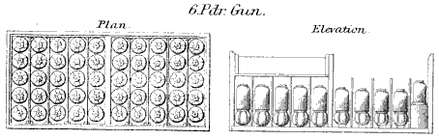

    • Loaded in four - 50 round / mixed ammo chests
    • Cannon had one limber with chest; Caisson had one limber with chest, and carried two additional chests.
    • As of 1850: 35 solid shot, 5 spherical case, and 10 canister rounds per limber box, 50 total
    • As of 1862: 25 solid shot, 20 spherical case, and 5 canister rounds per limber box, 50 total

From: 1864 Instruction for Field Artillery
