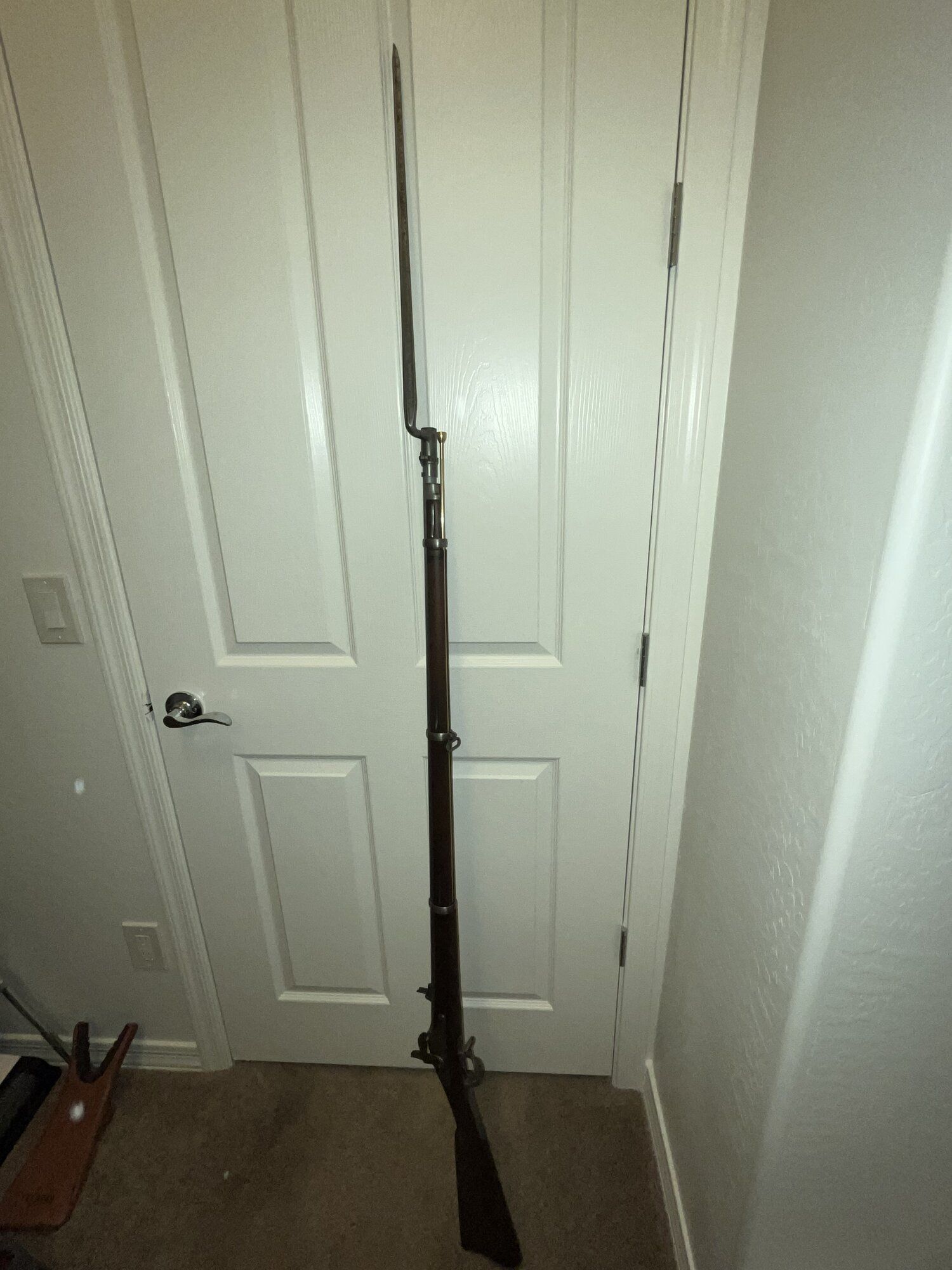

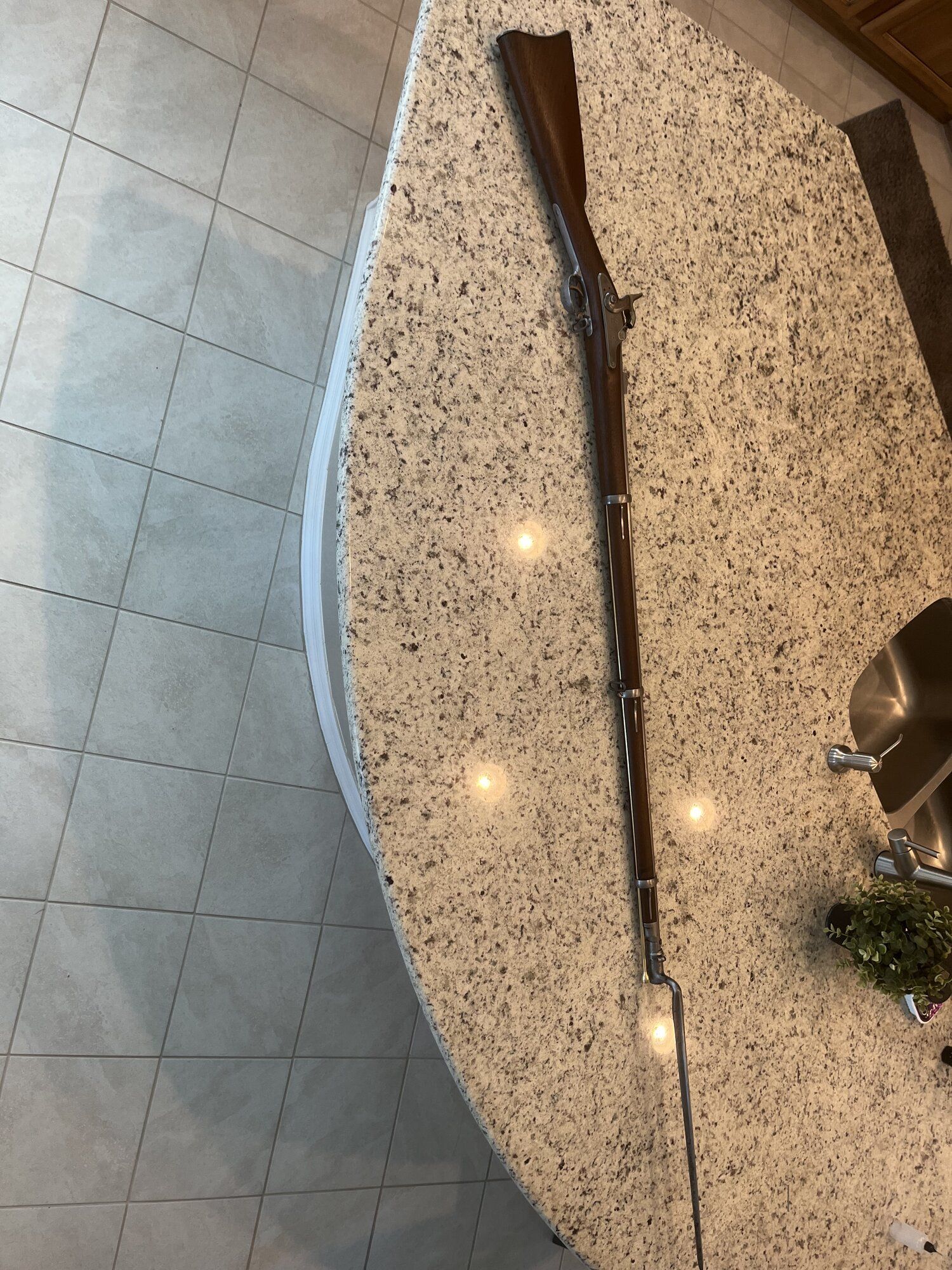

All....UPDATE....after full refurbishment, the 'live fire' of this beauty successfully occured on 14 June 23 and was brilliant...shot both .570 ball and .575 Minie at 35 yards...impact into paper was solid head shot...(the lower left three paper shot stickers were from a friends first attempt with his 1911) and steel plate target (3/16 or .1875)...with upper left impact (pic 4992) using .570 ball and lower right impact is with .575 Minie....deflection with Ball was serious (right side of pic 4993) with Minie slight deformation...powder load was 60 grams Pyrodex (for now). Considering this Musket Rifle had not knowningly been fired for at least +150 years, this success is a serious tribute to the craftsman at US Springfield....in 1863/1864....overall, I thank all of you for your professional input during this journey...keep safe out there.
