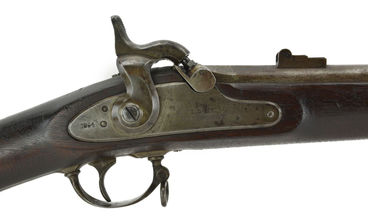

In the photo above, the barrel to lock plate fit looks sloppy. I'm wondering if there is play in the positioning of the barrel. Might this be a sign that incompatible parts are being used?

Bill S. - The LG&Y you have shown is not correct. A Springfield M-1863/1864 barrel and hammer have been "fudged" to fit the lock plate. At this point it is hard to tell, but perhaps the base arm is a M-1863/4 that has been modified to allow the use of a Special Model 1861 lock plate to make the musket seem more desirable. Which ever way it is, this is a good one to stay away from!

Thank you, I was considering this gun but the closer I looked the more it scared me. I've been reading and learning and will not commit to something until I'm sure it is what I think it is.
