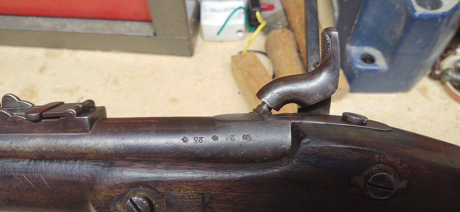

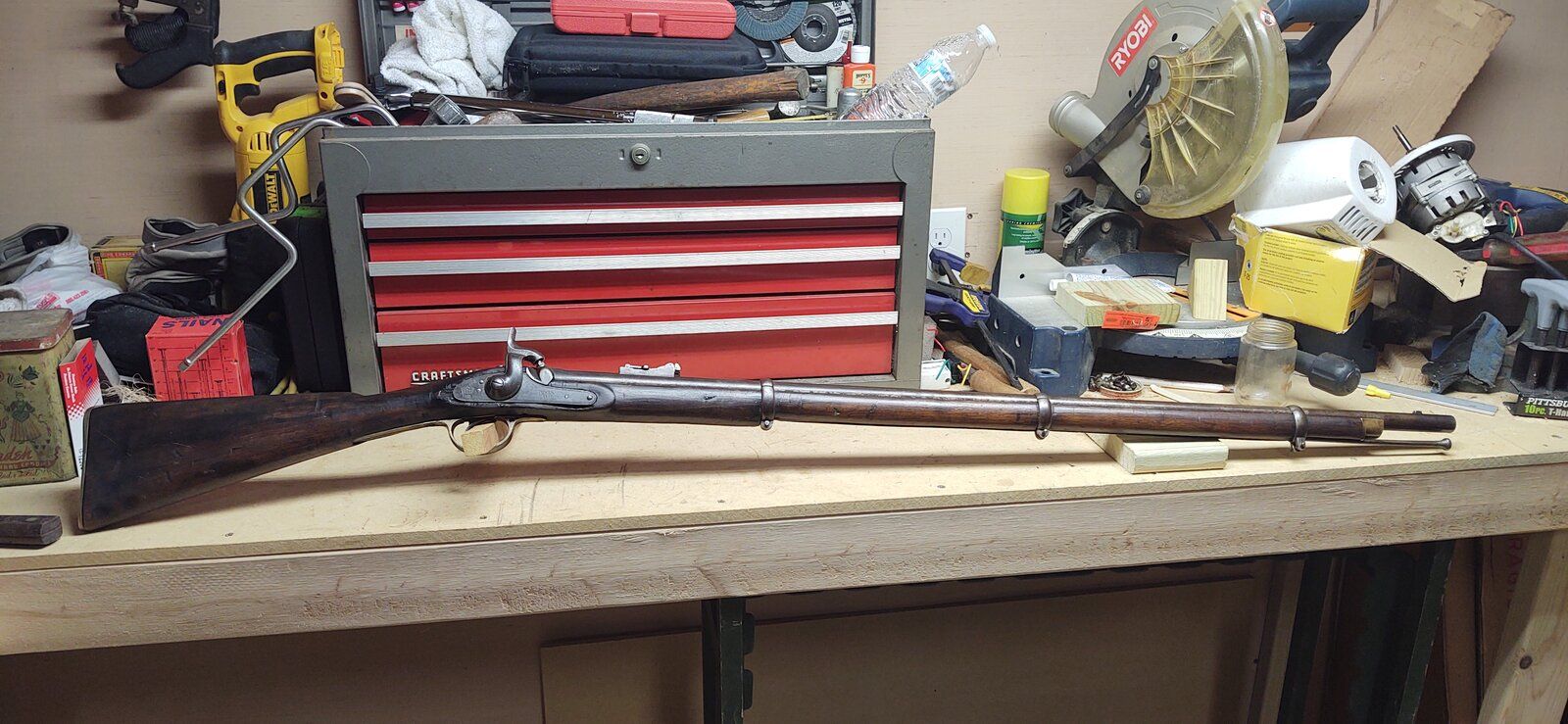

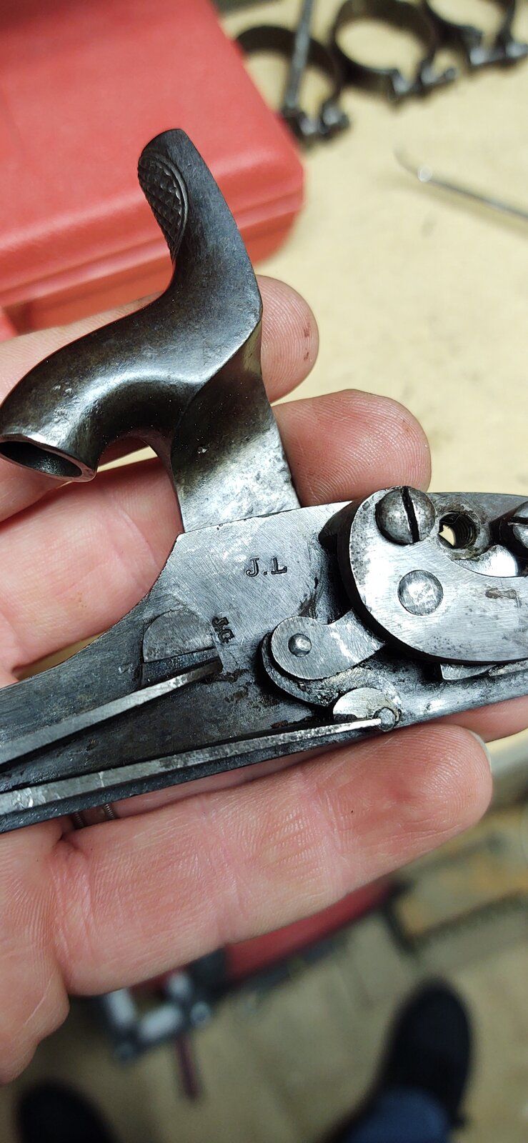

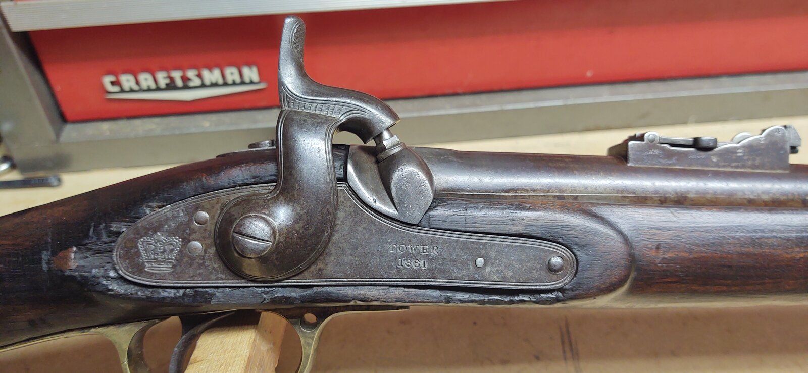

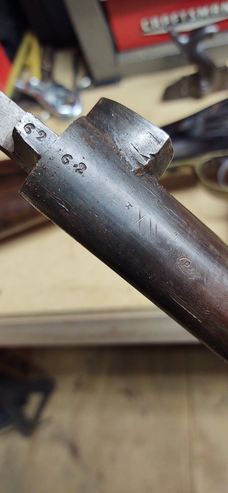

I've just come into possession of an 1853 Enfield rifle with a Tower marked and 1861 dated lock. There are several stamps on the barrel that I haven't been able to find out much information on besides the 25 on the top left of the barrel for .577 caliber. I'll let the pictures do most of the talking.

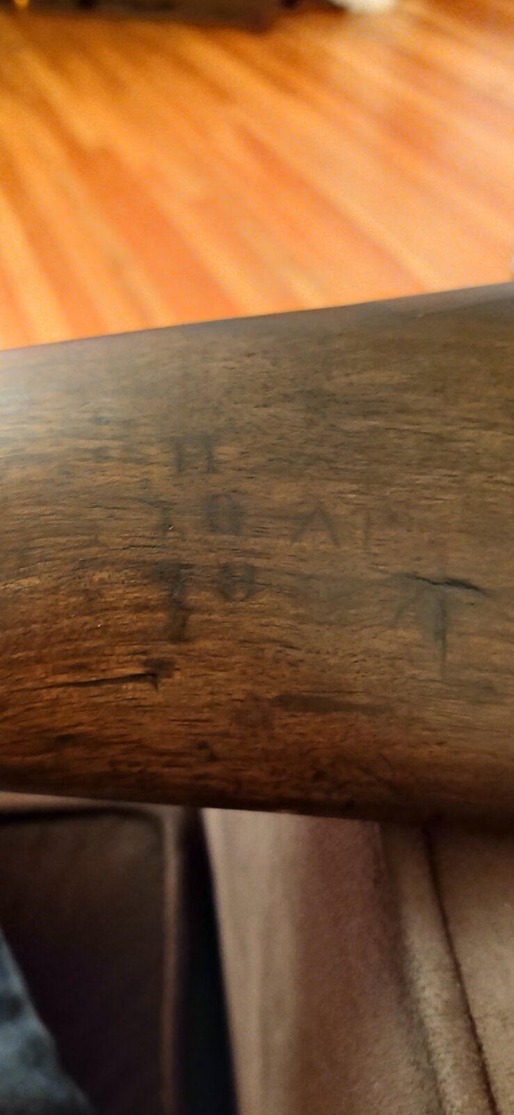

I have found no markings on the stock itself except for the left side of the butt. I believe them to be H 0 8 stacked above each other and slightly staggered to the right or H with two separate rows of numerals possibly. There also looks to be AT stamped or carved behind the H 0 8. Possibly a previous owners initials?

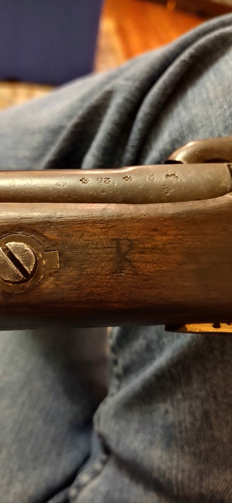

There is a carved R on the left side, opposite of the lock plate.
The ramrod is not the typical 1853 style with the slotted jag head. Possibly an earlier type? It appears to have been with the gun for quite sometime.
Both sling swivels are missing.
Any information on this gun and the markings would be much appreciated. Or if more details are needed. Is this a genuine original? Is there any way to tell if it is a Civil War for import?
Thanks in advance for anything that can be provided.
It is a genuine, original Birmingham made Pattern 1853 type 3 rifle musket.
There may be other marks in the wood. Those photos you've taken are the marks of the parts maker, supplier, fitter or inspector. These rifle muskets were hand finished as the parts were not interchangeable. The ram rod is replaced, as you noted. Overall it's a pretty nice P53.

A nice P53 Enfield in .577 caliber as denoted by the 25 * 25 "bore size" on the top of the barrel, these marks usually denote export and I assume it found its way to America to participate in the Northern Aggression.........welcome to the forums, from Maryland!

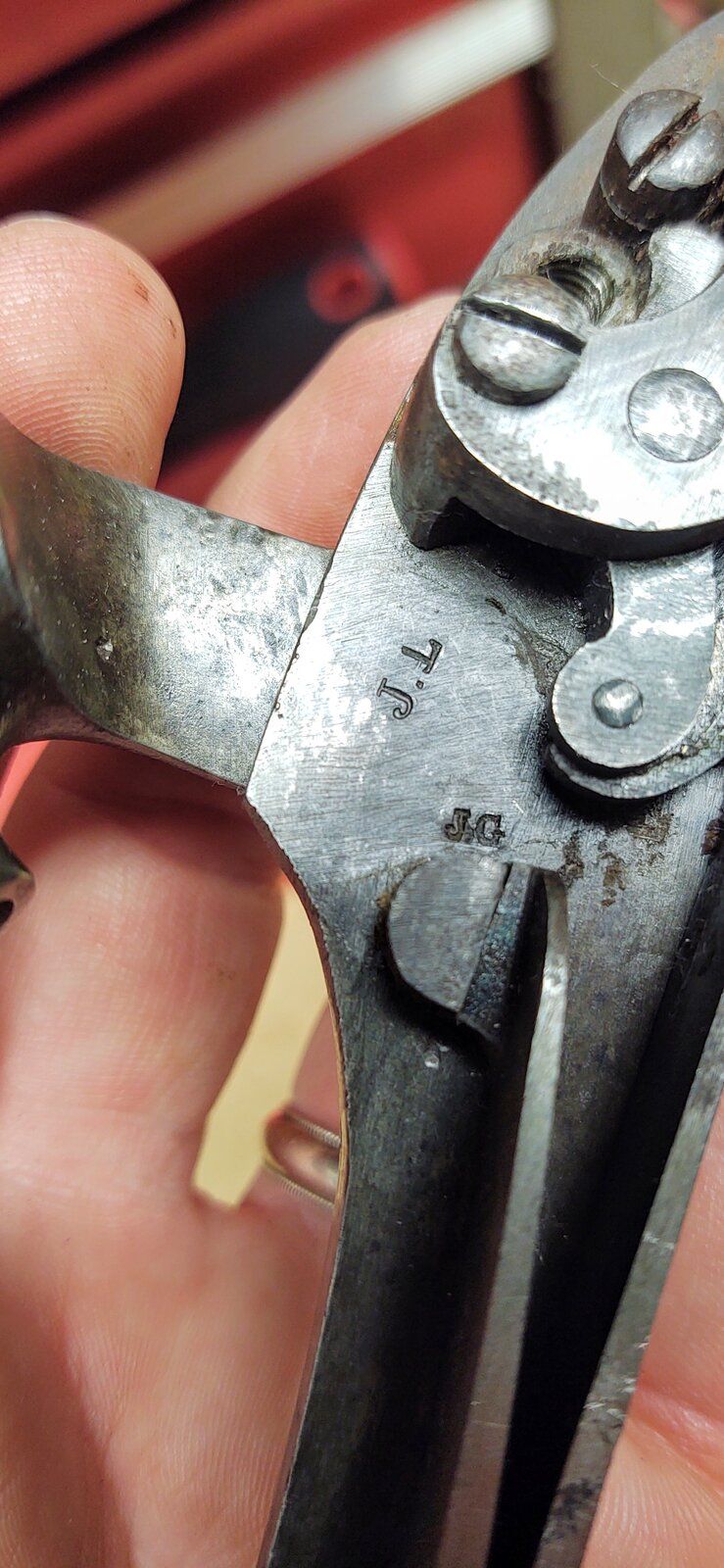

Welcome from the Railroads and Steam Locomotives Forum. That is an interesting piece. I have never seen so many markings on an Enfield, or any other for that matter. I would enjoy having them explained. Package 4 explained the bore size, but the 62, and the initials on so many of the smaller parts, hammer, etc. haven't. Is this usual, or am I being forgetful (usually).

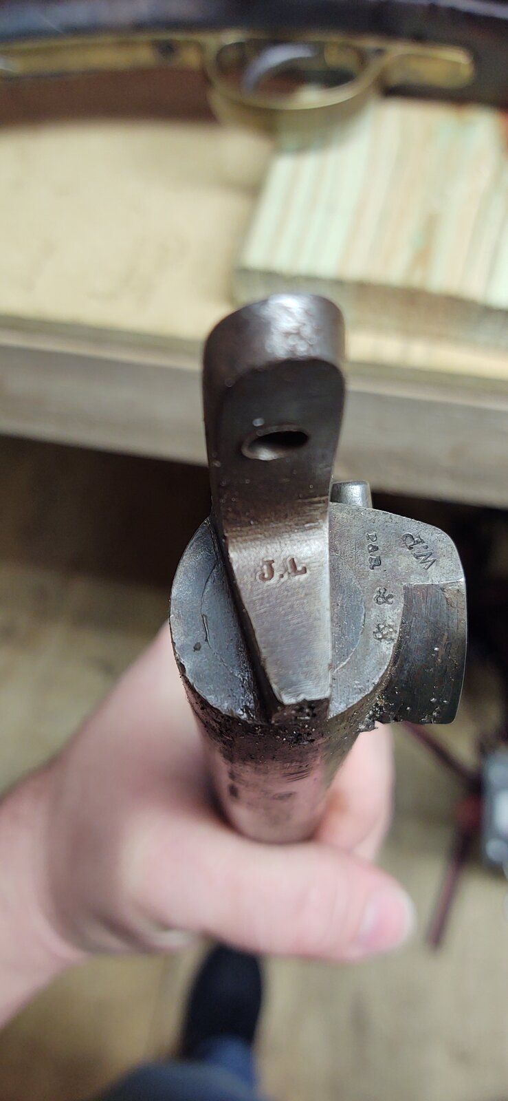

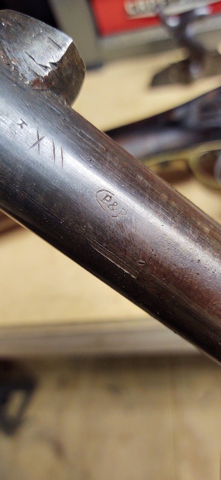

By the way, the various marks on the bottom of the barrel and the breech end shown in your photographs show initials of the various men who made or fitted or inspected the parts, but won't show whether this particular gun went to America, north or south, or any particular part of the world.
This is a Birmingham made gun, and thousands of people in Birmingham were involved in making and fitting parts, usually paid by piece, and many worked in small individual shops or even at home with family members helping out. Most had specific specialties or made specific parts, and the gunmaker would buy from many different people to make a single musket.

  7. Gunmaker has 500 completed muskets. Two hundred might have barrels finished by "J L" and 300 might have barrels finished and stamped by "W R." A careful student of these might know who J L is or who W R is, or the identity of "P & P" (likely the supplier of the finished barrel to the Gunmaker), but that won't tell you much more.
  8. The company that put these all together would stamp the company name in the wood on the bottom of the stock, between trigger guard and buttstock - is there a name stamped there?
The makers of the various parts marked them; if found deficient, their pay would be docked. The important parts (barrel, breech plug, etc) were inspected and the inspector marked his initials to show the work was satisfactory. On your barrel, those marks might show different men approved the rough barrel, approved the rifling, approved the final polish, approved the threading for the breech plug, installed / approved the breechplug, etc. etc. etc. So, they mean something, but not information likely to help you figure out the history of this particular gun.
