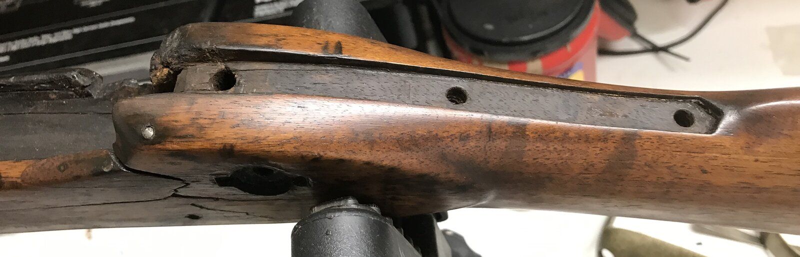

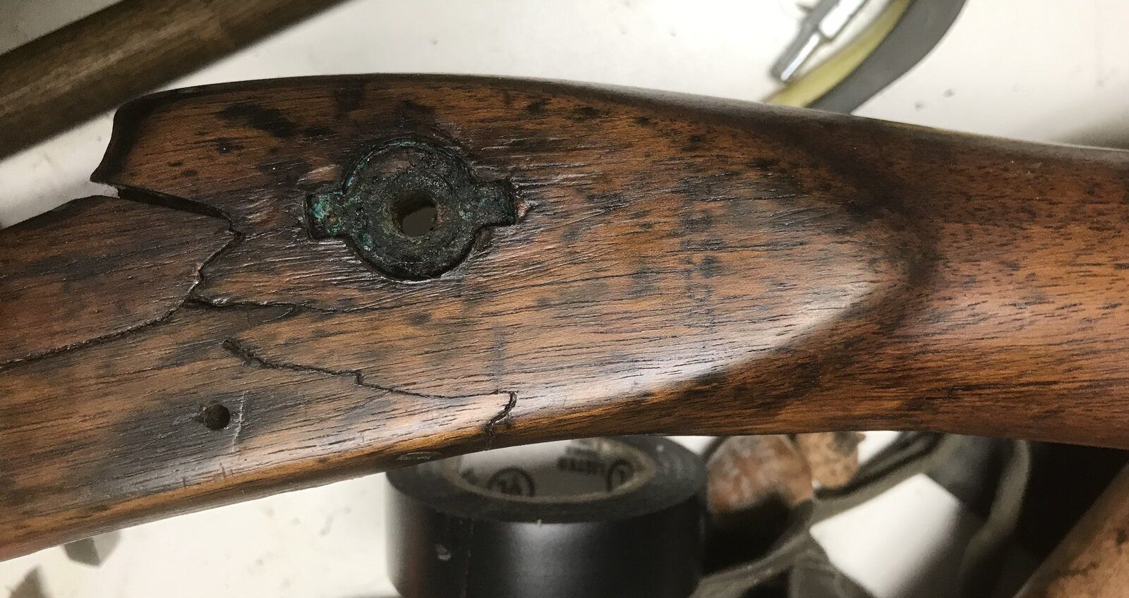

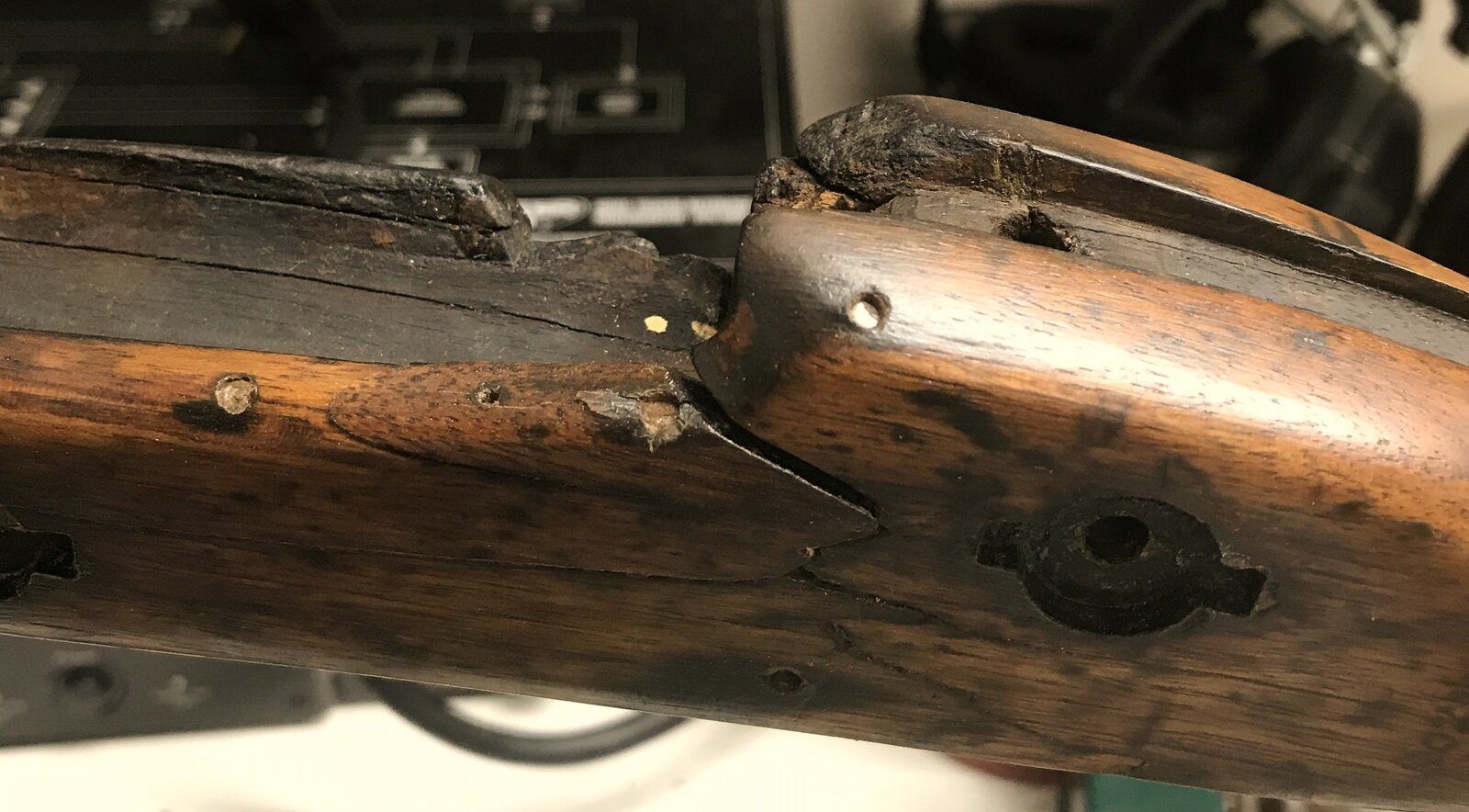

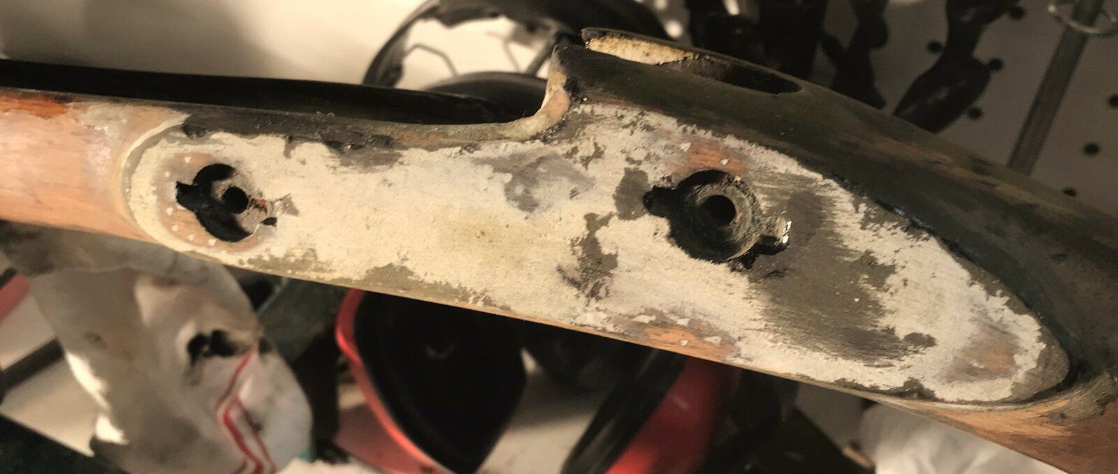

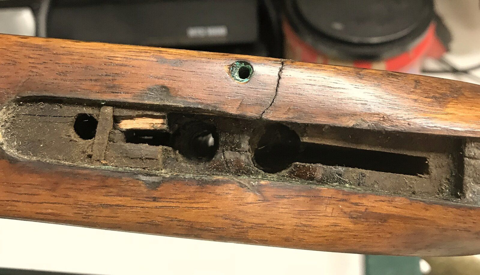

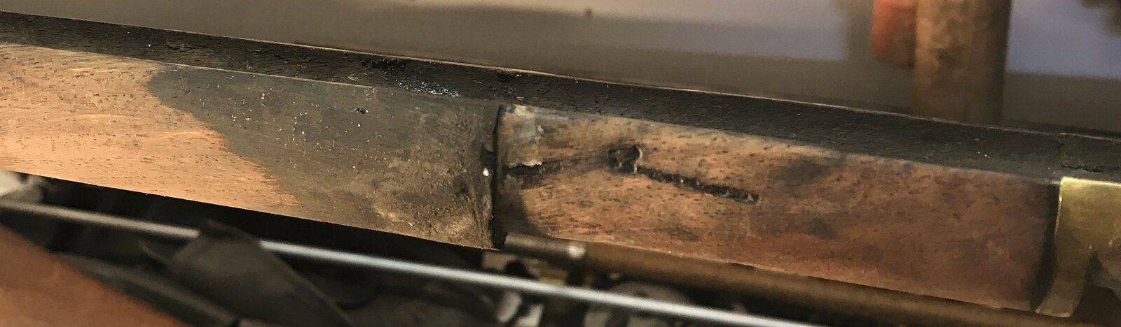

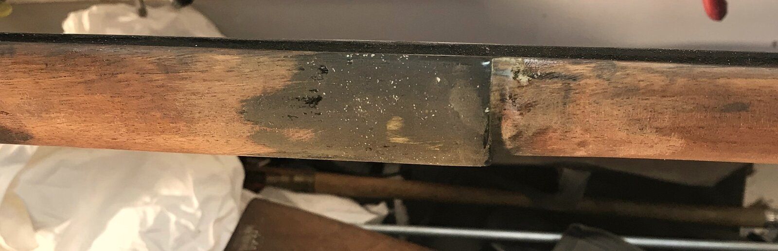

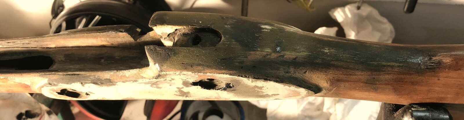

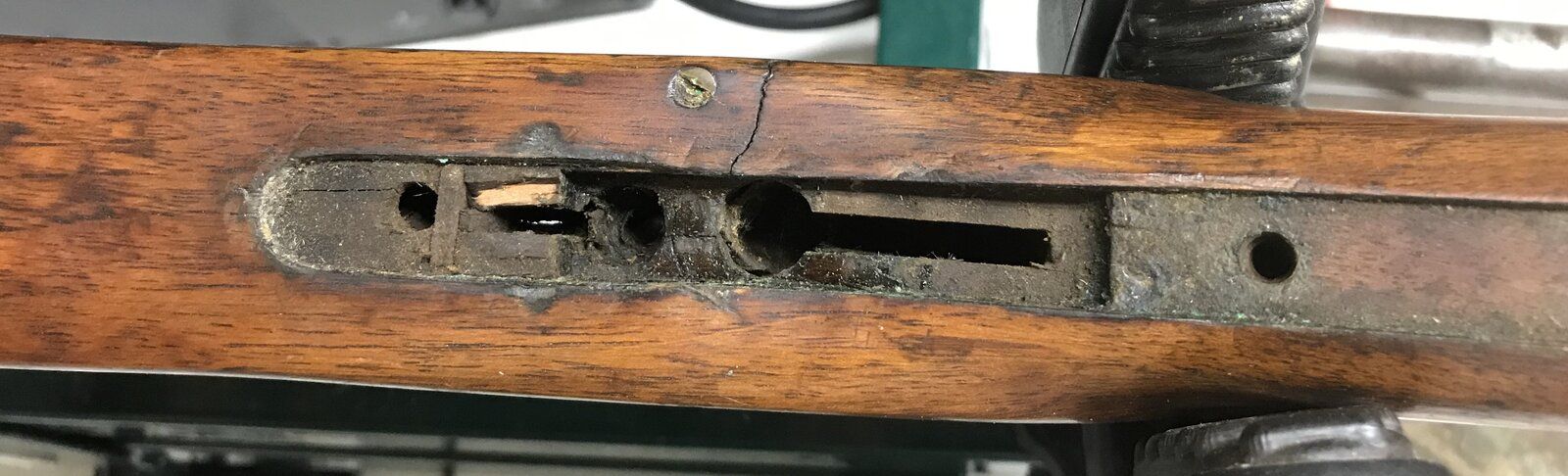

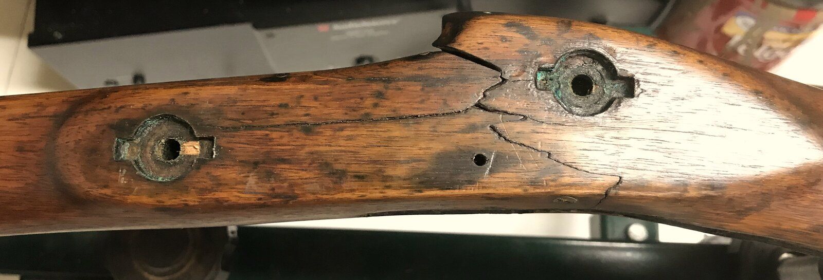

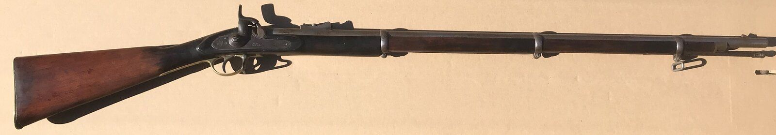

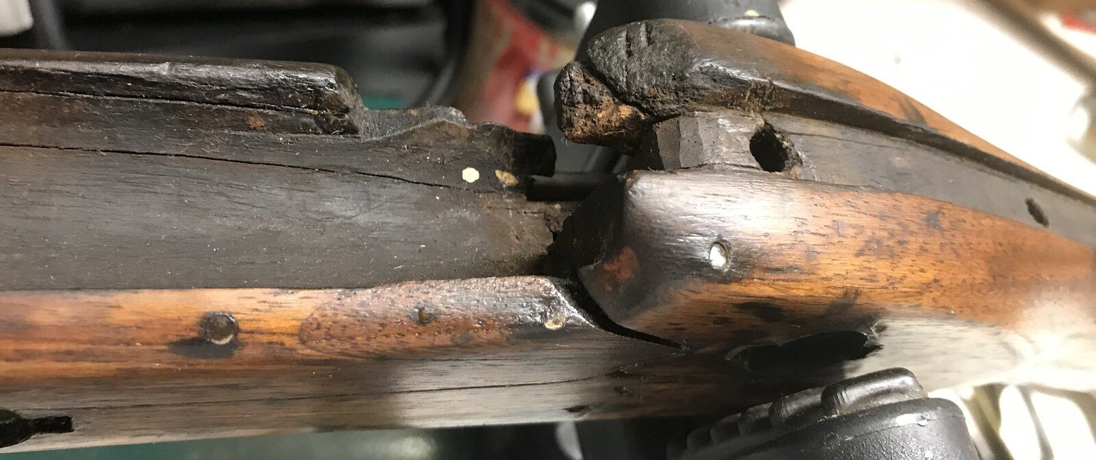

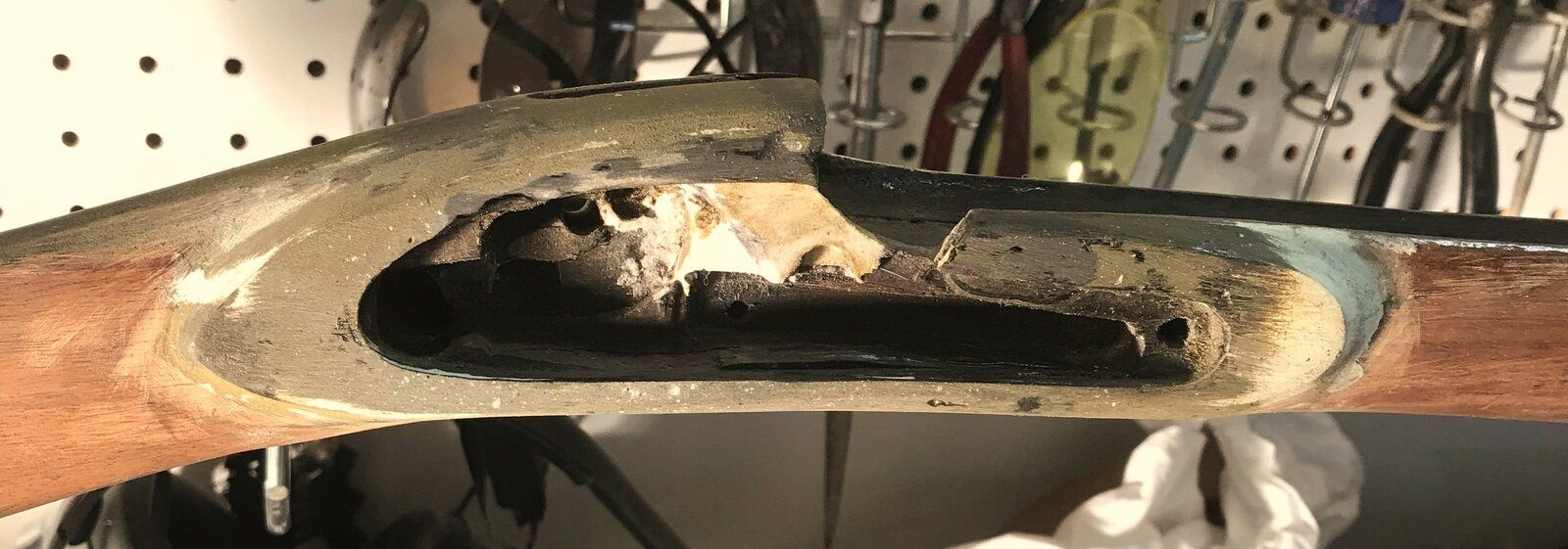

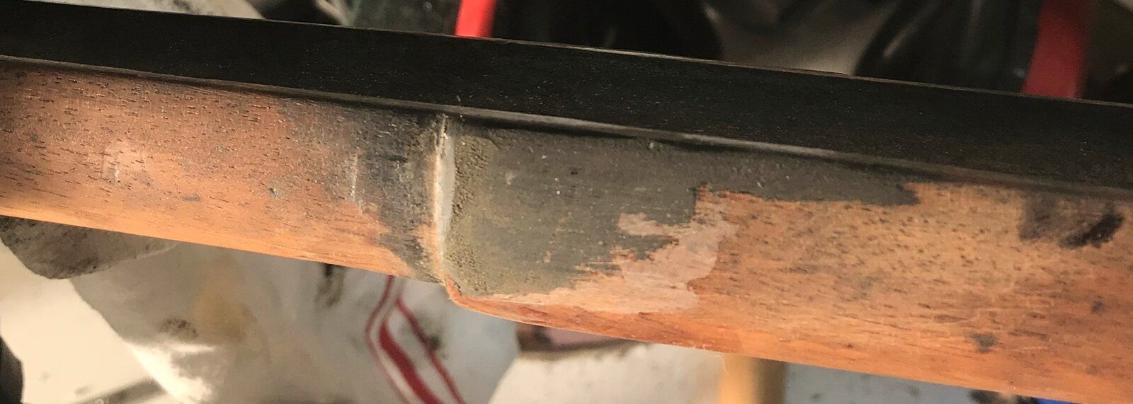

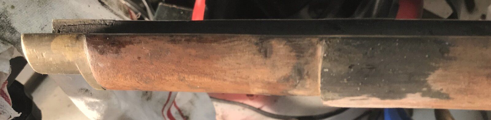

So, I picked up this Enfield from a local gun show. The seller said it had been in his family for "generations", and it was a "Brown Bess"..it was in such poor condition, I decided to buy it and try to restore it to display condition...
I did it as an antique gunsmith/ restorer/ appraiser for 30 years. do it now for fun and games.the trick here is to mix the epoxy, long set time stuff, with powdered color, dark, to make it match the fix. no glue line. then mix paint color with ture oil, (a new bottle always, and pad it until it matches. works every time. the walnut wood must match grain for grain too. and the inside must be aged too, so the repair/restoration is totally invisible inside and out.

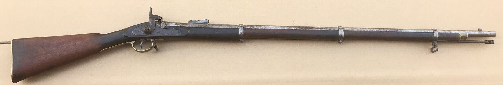

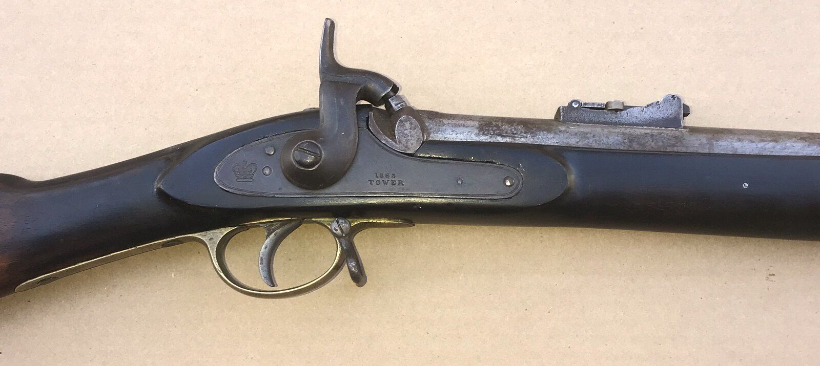

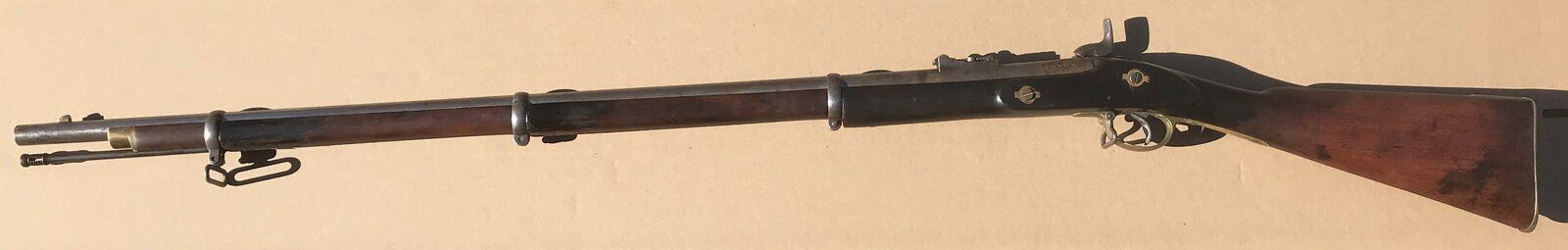

Nice work. Wonder what the seller meant by Brown Bess? I think he was confused. Kind of a fine point and easy to correct but the screw heads always face the back on Civil War-era weapons of English manufacture, which this is. The rear sling swivel screw appears to be reversed here.
I'm finding that I've reversed all the swivel/band screws...Thanks for the head's up.. And, yes, you do encounter a lot of characters here in AZ..buy the gun, not the story as I'm sure you already know...
