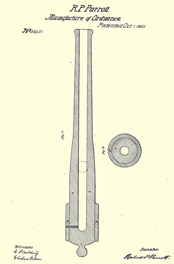

  • Invented By: Robert Parker Parrott in 1859-1860
  • Patent: For Manufacturing Issued October 1, 1861
    • U.S. Patent # 33,401 (see illustration)
  • Rarity: Common
Improvement to the Manufacture of Ordnance
By Application of a Wrought-Iron Reinforce
to a Gun Made of Cast-Iron
Google: U.S. Patent 33,401

  • Cost in 1862 Dollars: $180 (US); $ 300 (CS)
  • Cost in 1865 Dollars: $187 (US); $3,000 (CS)
  • US Casting Foundry: West Point Foundry, Cold Springs, NY
  • CS Casting Foundries: 4+
    • Tredegar Iron Works in Richmond, VA (80+ copies produced)
    • Bujac & Bennett, New Orleans, LA (about 20 copies produced)
    • Macon Arsenal, Ga (about 10 copies produced)
    • Street, Hungerford & Jackson in Memphis, TN (about 3+ copies produced)
    • Also possible evidence Noble Brothers making copies
  • Special Notes: 10 pdr. Parrott Rifles were easy to Manufacture, Inexpensive, Reliable, and Accurate to Shoot.
